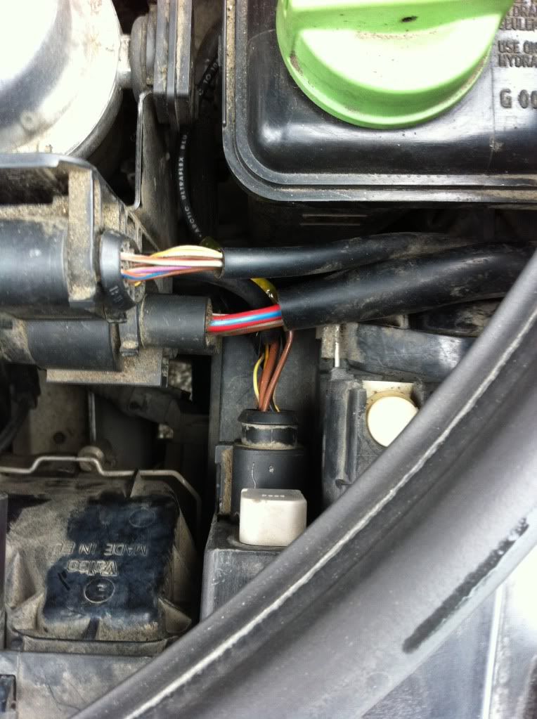

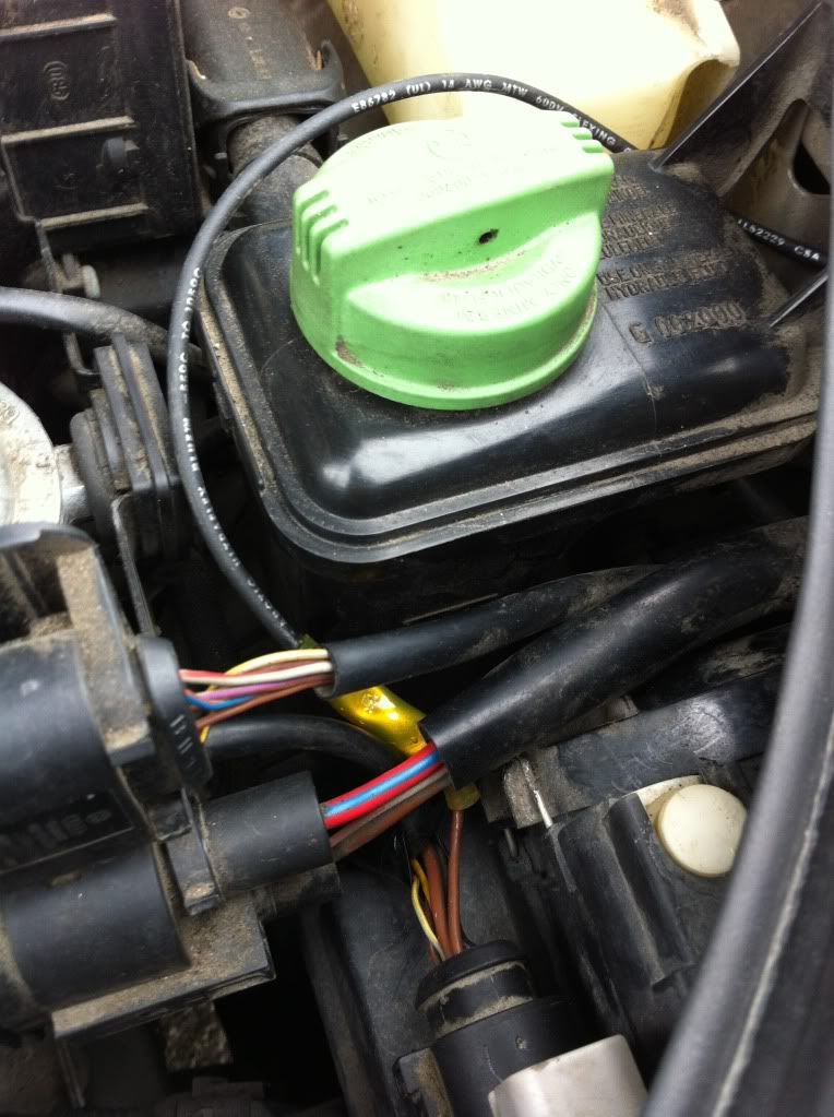

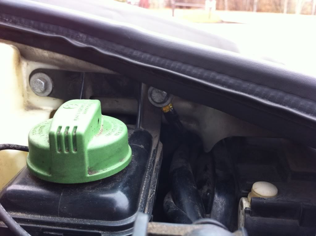

    hey all.
    i might be beating a dead horse but i feel it's still unclear of the solution here. i've been trolling around since i got my a4 a few months back, and i decided i should contribute to the audi community.
    i managed to find a fairly nice HID kit for a low price, $99 (PM me if you'd like the website, i dont want to seem like a spammer), definitely plug-n-play, and it all fits in the headlight housing, and this was exactly what was happening to me, if i didnt turn my lights on BEFORE turning the key, i'd get ESP, ABS and the brake light. my HID doesn't flicker or die out, about a month with them thus far in the harsh cold weather conditions of Alaska.
    keep in mind every aftermarket HID kit is different, simply due to the fact that a lot of the "companies" buy the ballast in mass and do their own wiring.
    easily fixed with the first solution posted up there. i'll even post pictures for those of you still confused.
    first refer to this wiring diagram:
    first start off by splitting the harness up to give you room, be careful not to nick or cut any wires.
    you're going to want to cut wire 10 (ground for low beam, labeled on the connector) about 4-6"s out from the connector to give you some room to splice then butt connect.
    splice a 14-16 gauge wire to the connector side, tuck, and ground to power steering reservoir mounting bolt.
    tape off wire 10 from the harness side and then tape up the harness.
    that's it.
    hope this helps!

    Bringing this back so what I did was I took the ground coming from the left ballast and rounted it to the right headlight and I'm not having any issues maybe this will help for some of you

    Have you tried rewiring like above pictures? its fairly easy to do and solves the issue.
