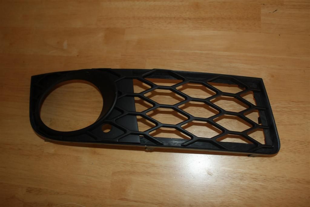

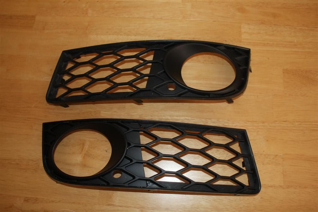

    OEM DTM Bottom Grille
    8E0 807 681 J Z9Y
    8E0 807 682 J Z9Y
    RS4 OEM Bottom Grille
    8E0 807 681 E
    8E0 807 682 E

    Here is a close up of the specific tools
    Fusor 143
    Dremel Cutting Tools

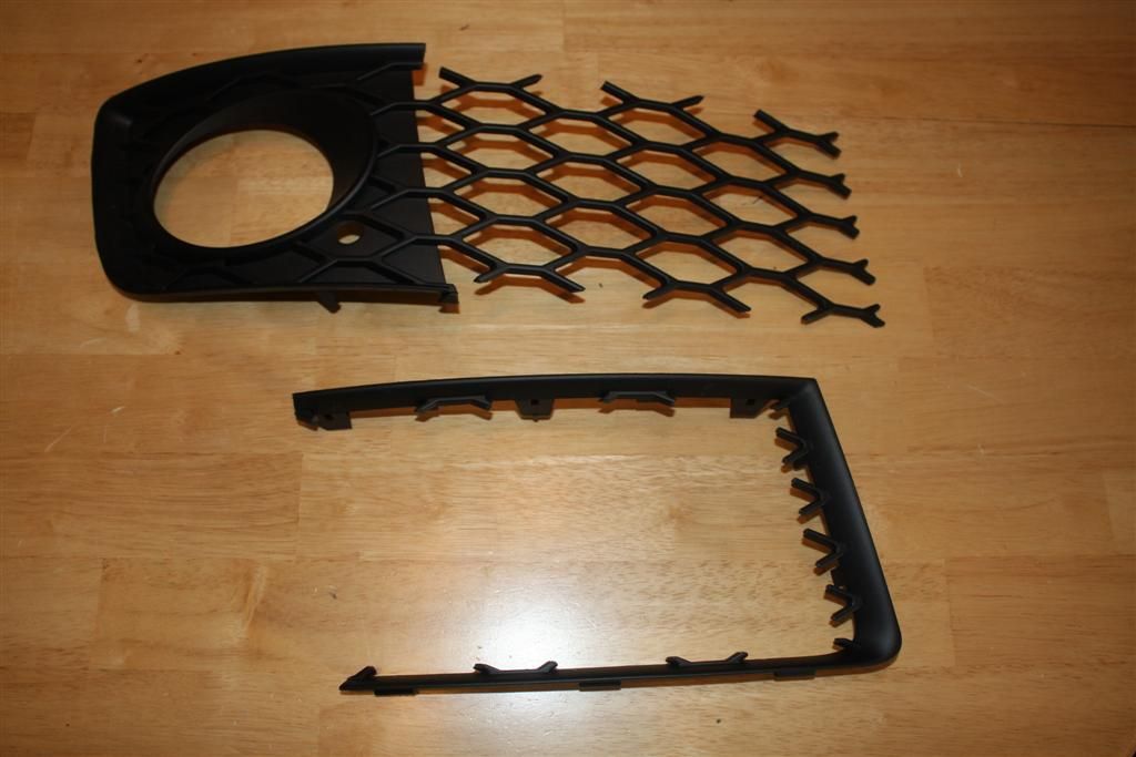

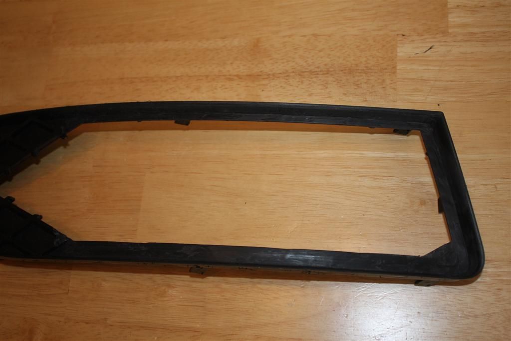

    Start but cutting the mesh of the DTM grille
    Remove the forward frame of the RS4 grille

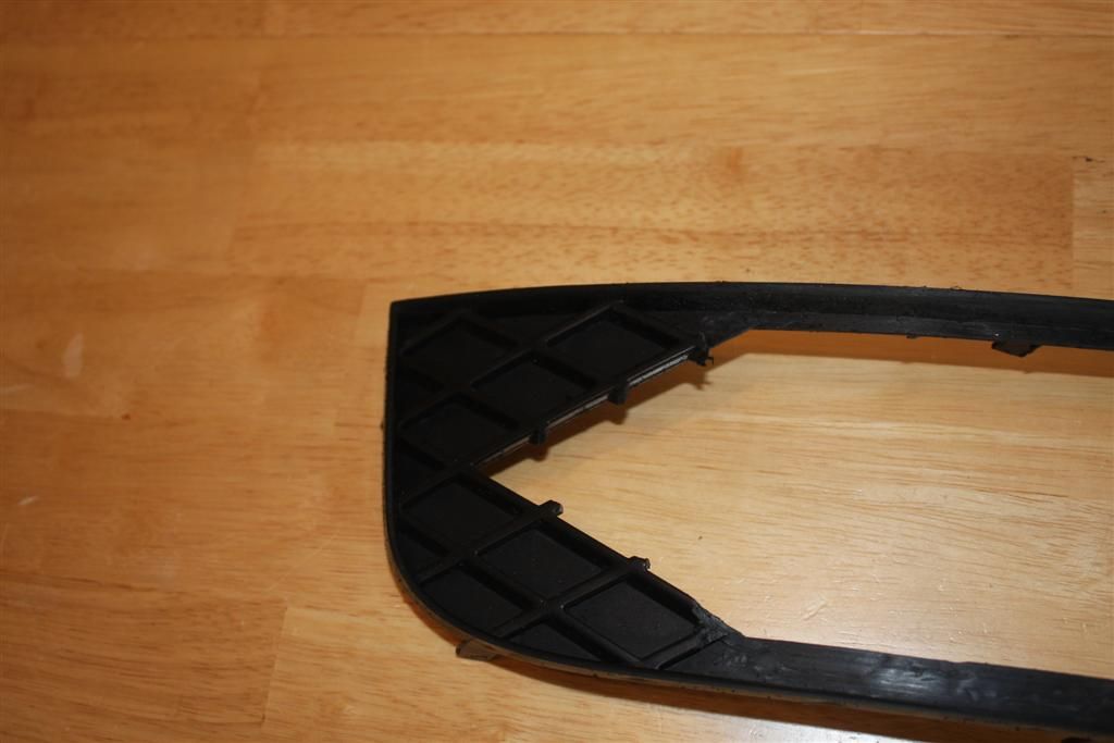

    Then, the rear upper part. Use the picture below as guide for the cut limit.
    The bottom part
    The rear part

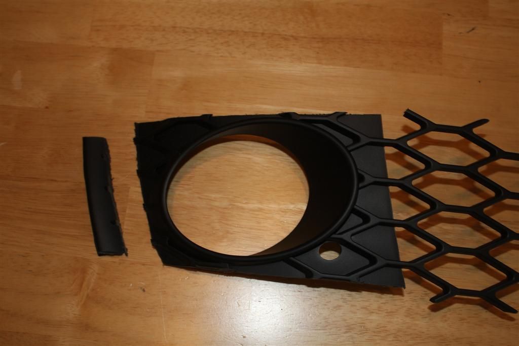

    Now comes the most time consuming of the entire operation. You need to grind down the remaining of the mesh from the frame. Here is a close up of how he should look like
    And after a good hour, it should look like this

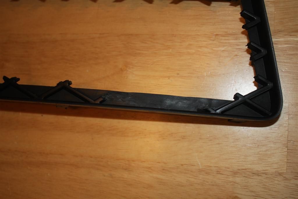

    Now you need to modify the rear of the grille
    Look closely and you will see the trace I made on the back. The result wanted is an even contour
    After more grinding and trimming, everything should look like this. Use sand paper to remove any mishap done with the Dremel
    Now trim the contour of the RS4 grille using the picture as template
    Note the indent done to the DTM frame to accept the fog housing of the RS4 grille
    And everything now should fit like a glove
