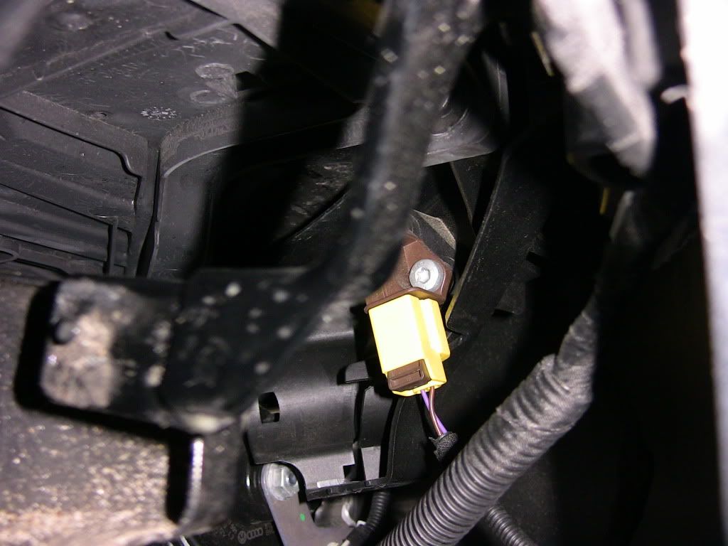

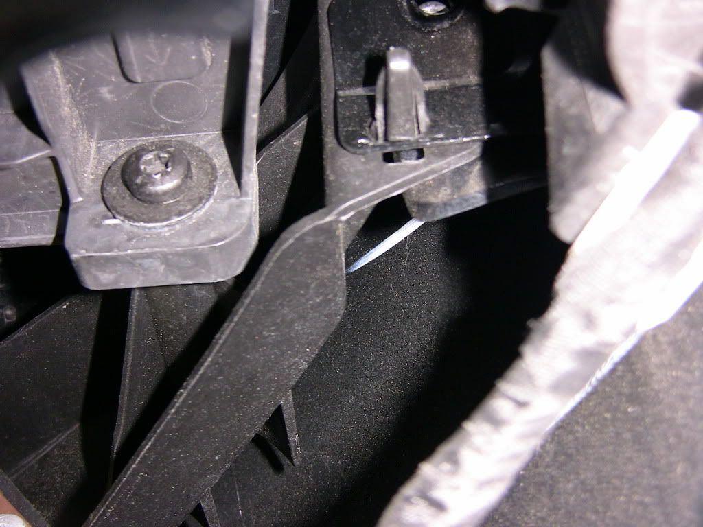

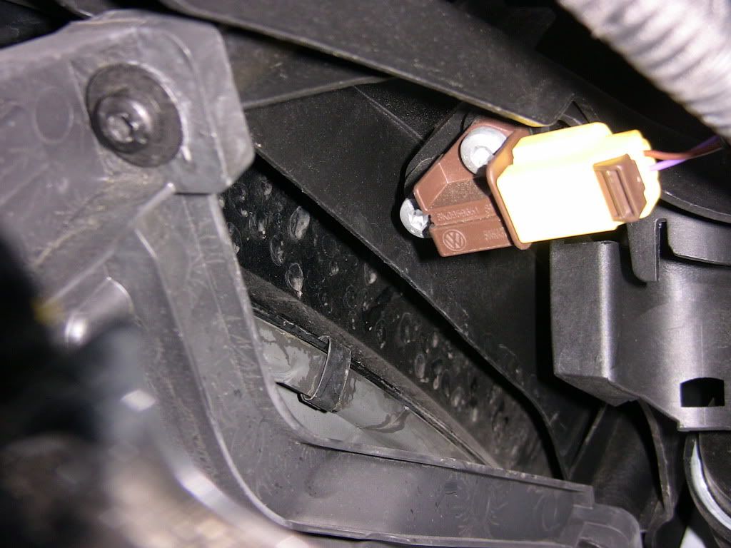

    i removed me front bumper to install the AWE tuning FMIC and you do not need to put the car on jackstands or remove the front wheels. i'm about to remove the front bumper again to install my new grill and maybe the eurocode pipe. just gotta wait for the grill to come in
    that DIY for that S5 is almost identical. I'll get the exact bolt/torx sizes for you guys, and how many bolts for each side. theres a sensors behind the emblem, and theres a sensor behind the passenger side bumper. I have the side assist so this may not apply to you.
    instead of jacking the car up on stands and removing the wheel. turn the wheel inside, unbolt any fender liner bolts, just enough for you to peel it back and stick ur arm in there.
    you can turn the car "on" to turn the wheels, but if you do this and all those sensors are unplugged. its gonna trigger a fault code, gotta use vag-com or apr's fault code erase to reset it.
    if all you SoCal people want to have a get together i'll help you guys out. i have the ross-tech cable but you gotta provide the laptop, my laptop is out of commission for now.

    I'm trying to disassemble the front bumper right now but i can't seem to find the 3 10mm on the driver and the 3 10mm on the passenger side hidden behind the fender liner. I'm following the S5 front grill removal DIY on a5oc.com (http://www.a5oc.com/forums/showthrea...=remove+bumper) as well as reading what's in this thread. I've located only 1 10mm where in the s5 pic there's 2 10mm there. I've also removed a 10mm nut that was in a screwed in upside-down position (if that makes sense) that was very close to where the fender and fender liner meet. Any help in locating these 6 10mm?

    Whatever needs to be unscrewed behind the fender liners is what i'm having trouble locating.
    i can't find these 10mm bolts. I've found 1 10mm bolt on each side (driver & passenger) that i believe holds the bumper so far.
    Are there additional clips and torx behind the fender liner as well?

    Well after hours of jiggling and wiggling the bumper and trying to locate what's still holding on to the bumper I decided to call my first try at DIY a fail
    Not only that but now there's a wider gap between my hood and grill
    I was very careful in reinstalling all the pieces I removed wtf!
    To those who've removed their bumper. Please HELP!!!

    These were the only pics I took before I put everything back together
    Now into the breech!!! Fender liner at 9oclock, fender at 3.
    Turned camera vertical to get around that black bar in the forefront in the previous pic. Liner at 6oclock, fender at 12
    Turned camera right side up again. Liner at 9oclock, fender at 3. You can see the brown box at 7,8 oclock is the brown box from prev pic. The only 10mm i found on each side (driver and passenger) was at 12oclock in this pic (the 10mm bolt was already removed, only the hole remains)
