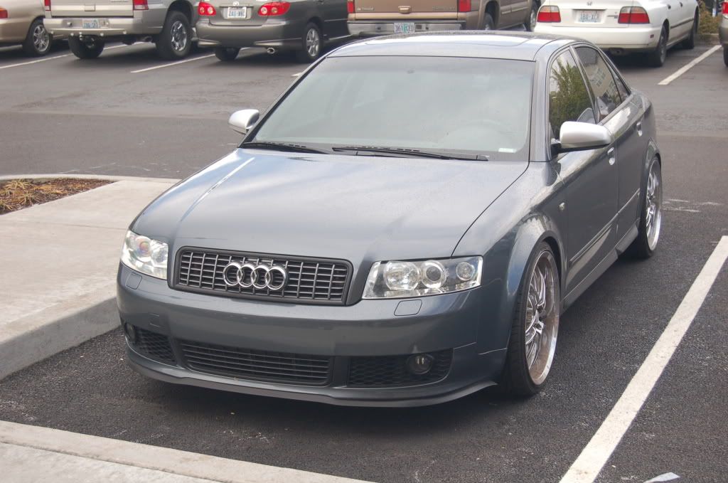

    Veteran Member Four Rings Rommulus's Avatar
    Aug 29 2007
    20663
    '03 1.8TQM
    Portland, OR
    Re: Anyone running a 18x8.5 with a 35 offset on the front of a B6 A4?
    Here is et38 on an 8.5" wheel.

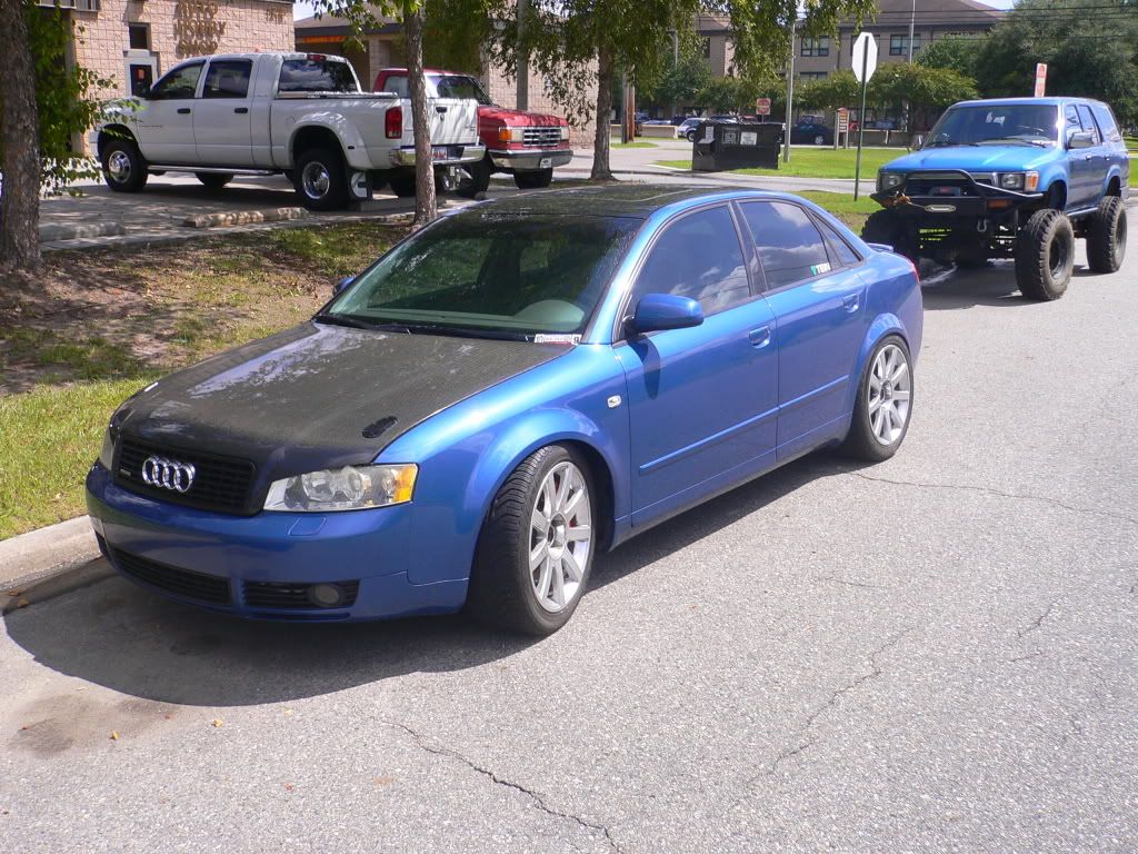

    This is a pic of a friends car that has a very similar ride height as me. (i dont have any pics of my current ride height) but i am on coilovers so i can adjust.
    Sep 23 2006
    11929
    Houston TX
    Quote Originally Posted by BIG EYE View Post
    Is your car in your avatar? You'll almost definitely rub a bit. Seems like if you're really low, ET32 on 8.5 width wheel is about as far as you can go with 235 tires. I've never rubbed once with ET32 on 19x8.5 but I'm about 24 3/4" all around. Not as low as what you just showed.

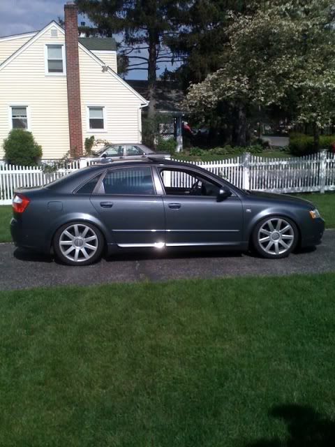

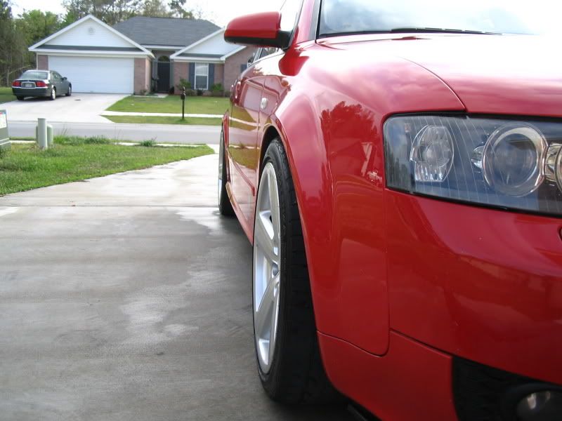

    Sep 23 2006
    11929
    Houston TX
    Quote Originally Posted by BOPOH View Post
    et30 is fine. i had fat tires 255 and it was good
    Second picture doesn't look ET30 to me, you're sure those wheels are 8.5? I guess they must be since a 255 tire on a 8" wheel would overlap the lip more, but still, doesn't seem right to me. Maybe its the angle IDK.
    Edit: I saw the same wheels for sale in your sig. Still doesn't look quite right to me, strange.

    Veteran Member Four Rings BOPOH's Avatar
    Oct 08 2007
    21641
    Columbus, OH
    Not here to thread jack but for all you unbelievers
    these are OEM RS6 wheels 18x8.5 et30
    im selling them because i got RS4 reps that show off my BBK much better
    Oct 08 2007
    21641
    Columbus, OH
    here you go i found it
    RS6 18x8.5 225/40/18
    Sep 23 2006
    11929
    Houston TX
    Ah cool, this explains it thanks:
    Dont get fooled, i have -2* front and -3* rear cambers, otherwise it would stick out. Fenders are also rolled, minimal rubbing does exist, BUT not as much as my 245/35/19
