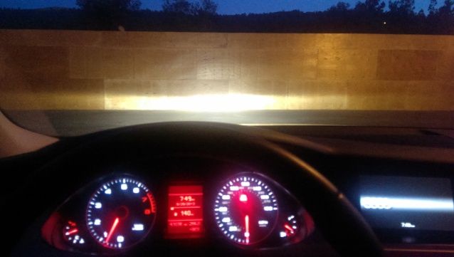

    Just lowered my car and wondering whether I need to adjust the lights. The lights automatically adjust on my car and I'm wondering whether my headlights are still at an okay height. At about 25-30ft from a wall on a level surface, with a little less than 1/2 tank of gas, my lights point straight across about 2 feet above from the ground. I'm lowered at about 26 inches and am wondering whether there is need for any adjustments. For those of you who adjusted your lights, at what height did you guys adjust your lights to?
    Here's a picture of the wall I was using for reference. Again, I'm about 25-30ft from the 10 foot wall on a level surface.

    Looks like they need to come up to me..
