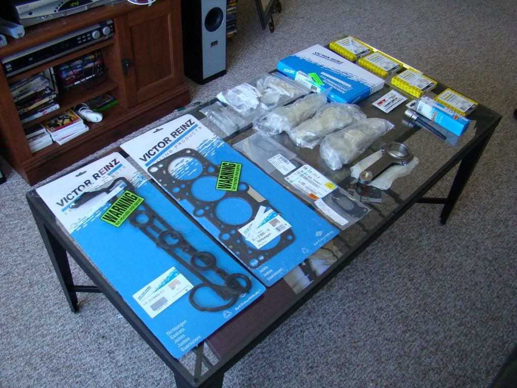

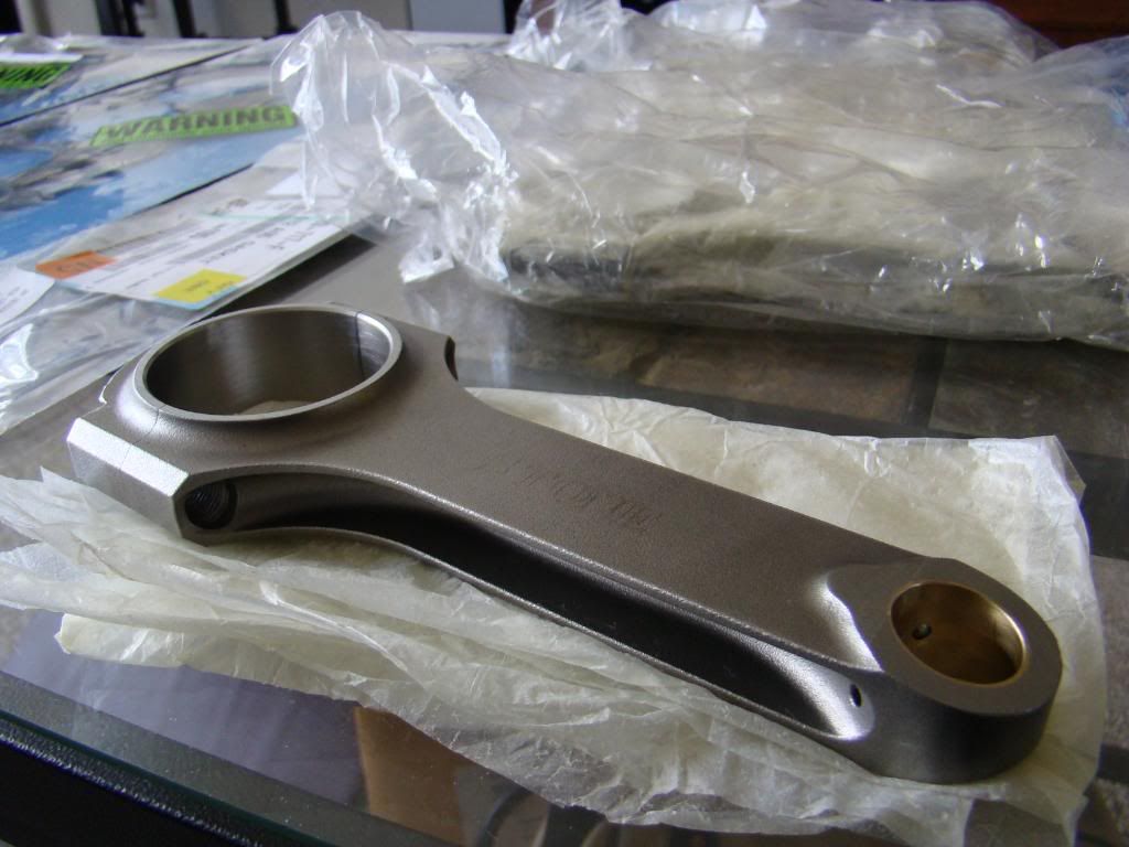

    A short time after I began to collect the parts for my build.
    - GT3071
    - SPA MANIFOLD
    - ATP OIL LINES/FITTINGS
    - INTEGRATED ENGINEERING RODS
    - OEM AND AFTERMARKET PARTS FOR ENGINE BUILD
    - CLUTCHMASTERS FX400
    - CLUTCHMASTERS 15LB STEEL BILLET FLYWHEEL
    - PRECISION 600HP INTERCOOLER
