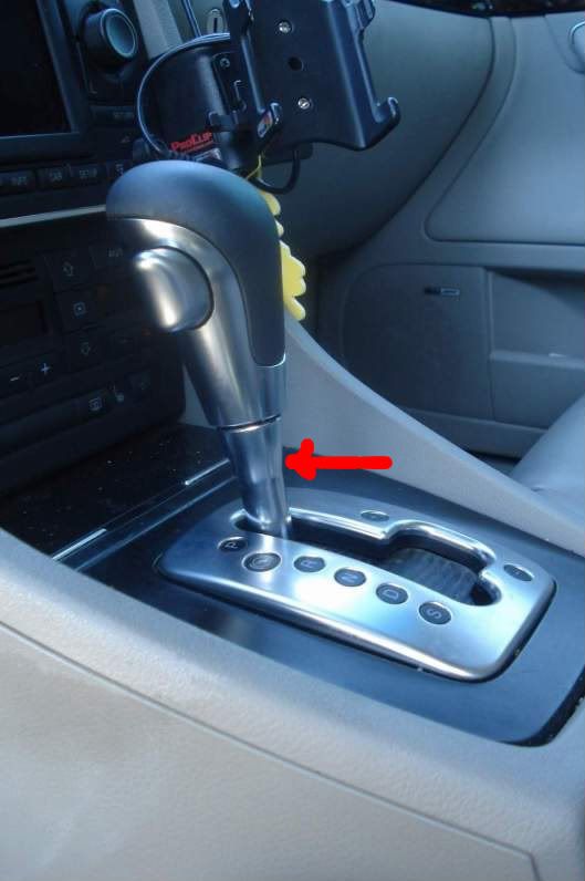

    Here's another question regarding this install: If the button on the stock shift knob comes out, how do you get it back in properly? This happened to me last night and I got the button back in, but its not in securely and I'm unable to remove the stock shifter now since its not "catching" and comes right off when I try to tie it with the zip tie...

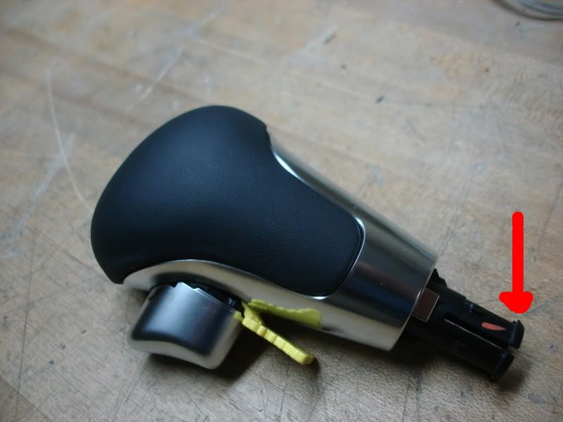

    This is the actual item from Greg at DTH..
    this is huge improvement over the stock tiptronic knob,

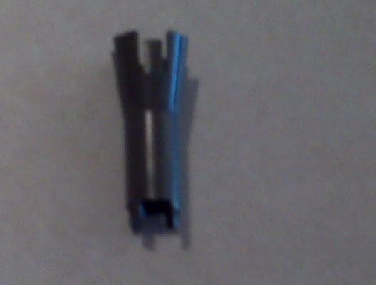

    To clarify for everyone - I was able to get the S6 knob to fit just fine without the chrome trip piece on the shift assembly - the issue comes into play for me when it comes to getting the chrome trim to snap into the base of the S6 knob - the black plastic tabs on the S6 knob seem too big to want to fit into the trim piece. If those could be squeezed togther more, maybe I could get the trip to fit onto the knob.

    The bottom plastic part of the new shifter is LONGER than the stock knob also....that is an issue along with the fact that the plastic piece is also bigger. Putting the knobs side by side you can tell the difference in length right away (plastic connecting pieces way different)

    Step 1-Seperate Chrome Sleeve
    I know this is a pic with the S6 shifter already on but just imagine it's your stock shifter. The first thing you need to do is push the chrome piece (inidicated below with the sloppy arrow) down and seperate it from the shifter piece. I did this by using a flat tip screwdriver and wrapping tape around the end. Be patient, it takes a little bit of time to do this.

    Step 3-Remove Grey Sleeve
    Ok, now that the old shifter is off, you will need to remove the grey sleeve (pictured below). It either came off with the old shifter or is inside the chrome piece referenced in step one. If it's still in the chrome piece, pull the chrome piece off the old shaft and use a pair of needle nose to get the grey sleeve out of the chrome piece. Once you the grey piece out, put it aside, you will not need it anymore.
    Step 4-Trim Lip on new shifter
    This was the part I was having trouble remembering. To get the new shifter to fit properly, you will need to trim the Lip (reference below) off the new S6 shifter. I did this with a razor. This needs to be done because otherwise the the shaft for the new shifter is too wide for the chrome piece to slide up.
    Step 5-Install S6 Shifter
    Now you are ready to install the new shifter. Put the chrome piece back into place and slide the shaft of the S6 shifter down until it snaps into place. You will then need to slide the chrome piece back up. This takes a little bit of work and I did it by twisting and sliding until it was all the way up.
