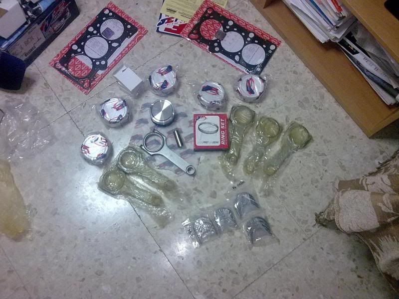

    Enough of the prologue….. As the title suggests, this is a post about my built.
    My car is actually is a swap mess…It’s a 8H7 cabrio with rs4 b7 wide body (under construction) BUT with a B5 2000 S4 AGB engine. I hope I don’t get flamed for this….
    Anw..My setup includes
    1. JE 83mm custom pistons with antifriction coating (9.1 compression)
    2. 034 rods
    3. Coated rod and main bearing set
    4. Raceware Head studs
    5. 034 Girdles set
    6. Port and polish 2.8 N/A Heads
    7. 034 Valve Spring Set, 5-valve, High Rate and Lift w/Ti Ret.
    8. 034 Valve Set, Oversized
    9. For now 2.8 intake cam (Hydrolifter) …But I will chance to catcam 1004052 really soon (+ adjustable gear)
    10. Custom Comp-turbo CT4376 twin scroll triple ball bearing
    11. Custom exhaust & intake manifolds (still under development)
    12. Custom throttle 80mm
    13. 034 twin 044 Bosch Fuel pumps with upgraded fuel lines and fuel rails
    14. 034 custom exhaust system

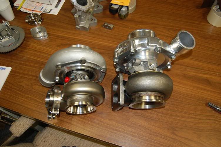

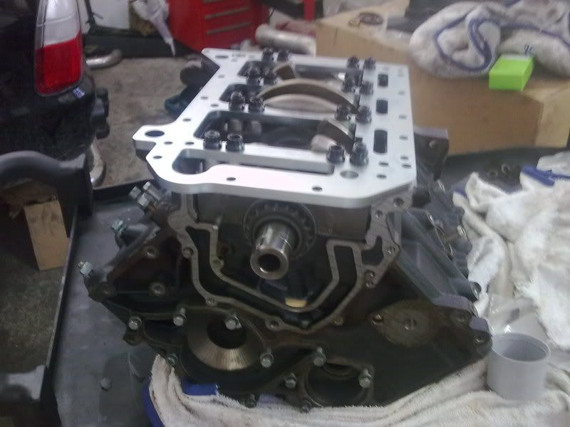

    The turbo is good for 950 crank hp... The funny looking one on the right....For reasons not known to me they when on to polish the turbo....ah well....

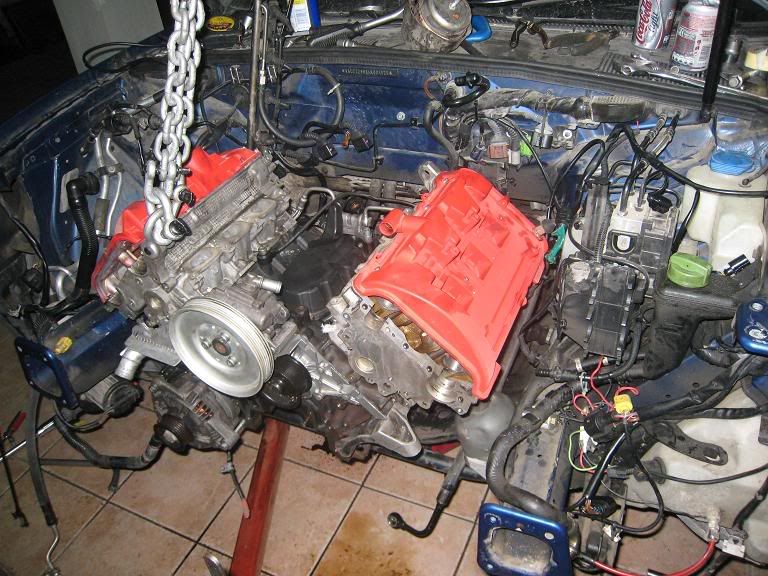

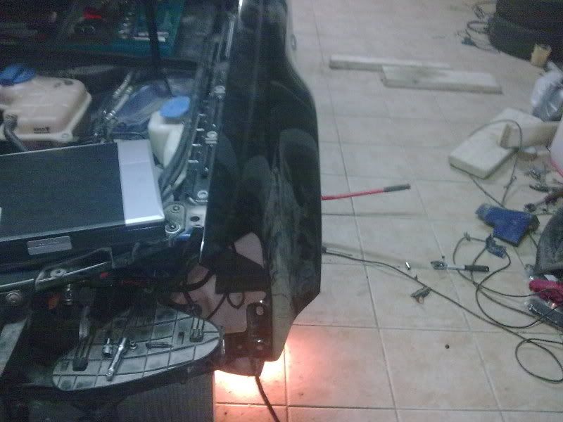

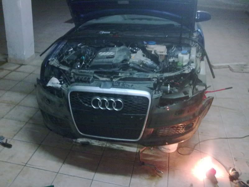

    I am still in the built process...Those are some pictures of mockup
