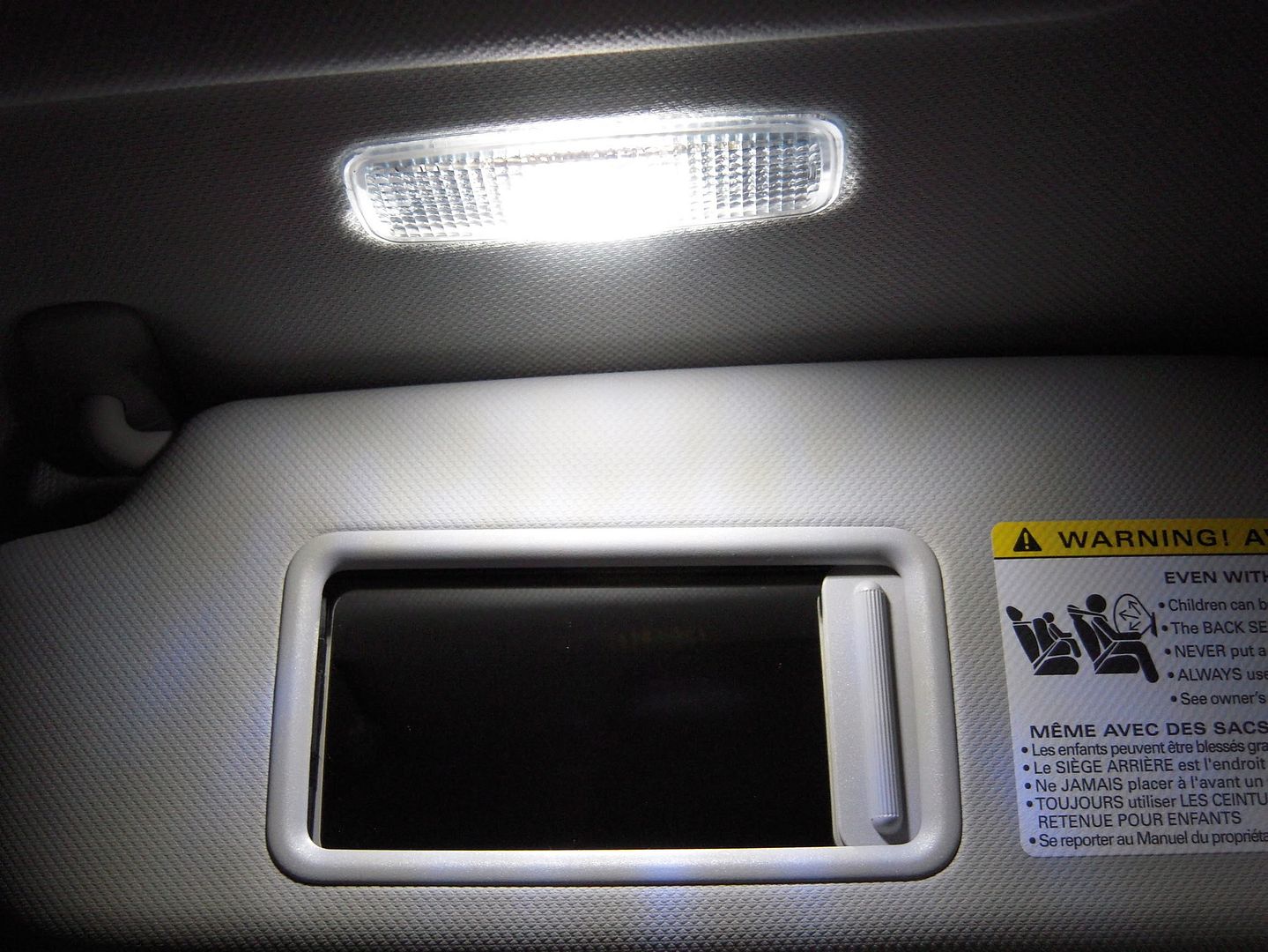

    OK so i know everyone has been asking about my interior lights swap so finally here it is.
    All the bulbs are from superbrightleds.com, I also used COOL WHITE color to match under seats lights.
    Interior:

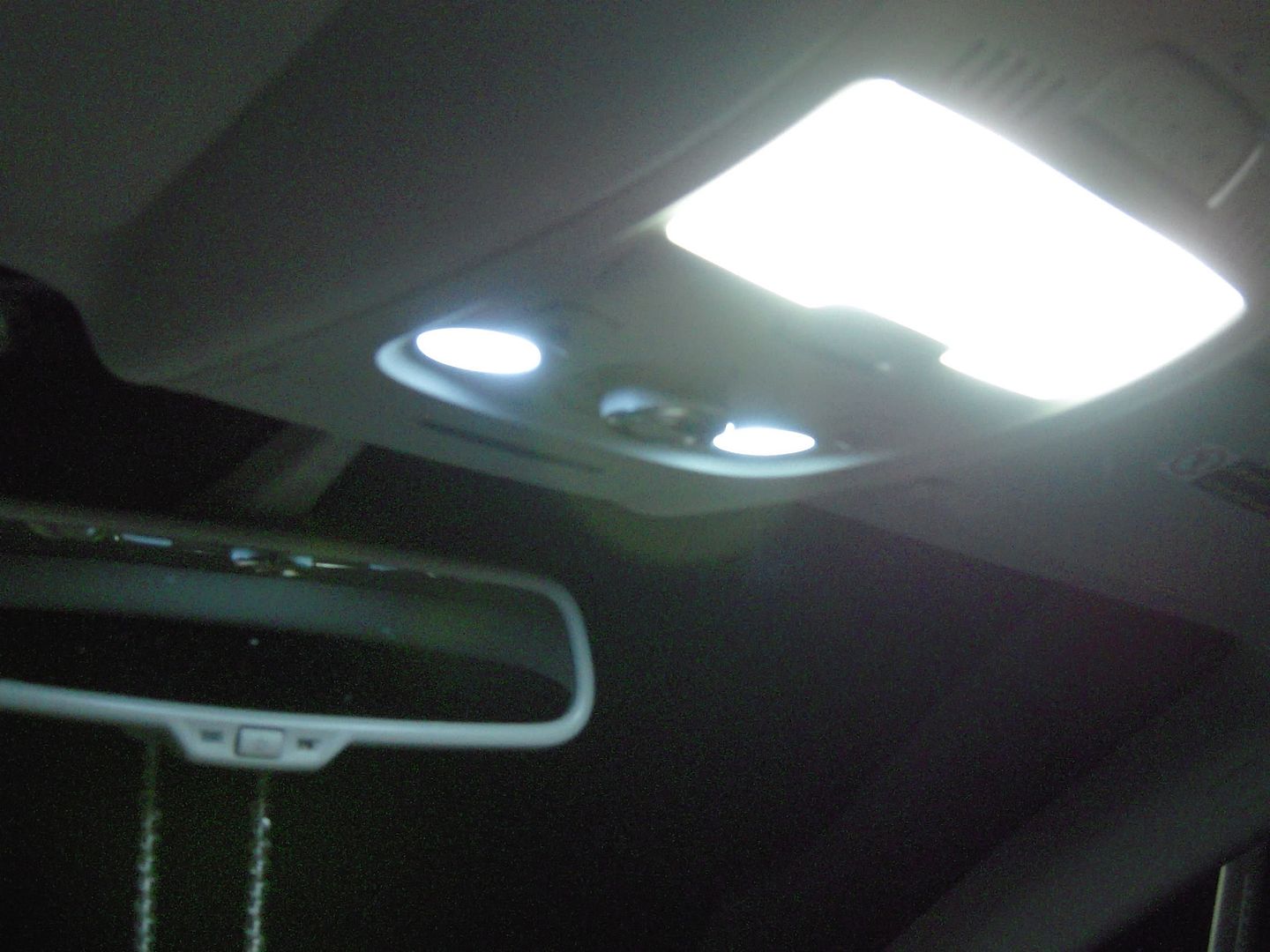

    Front Dome Lights:
    You need 2: WLED-x6 LED bulbs (for the circle front dome lights left and right lights)
    You need 2: High Power 6-LED Festoon bulbs 37mm 3710-xWHP6 (center front dome light)
    Visor Mirror Lights:

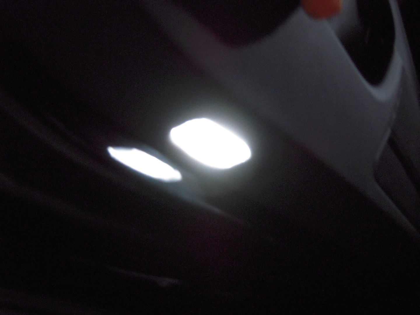

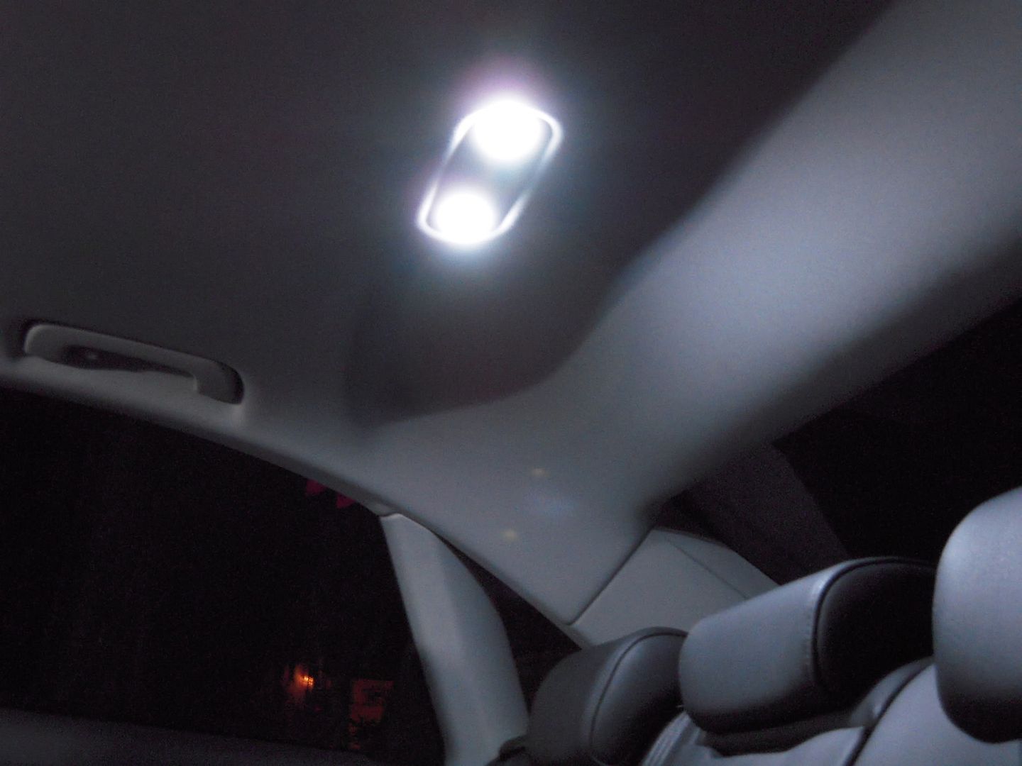

    Rear Dome Lights:
    You need 2 Mini wedge blubs: 921-x9 Wedge Base LED bulbs
    Ground Illumination Door Lights
    You need 4: WLED-xHP6 Wedge Base Bulbs

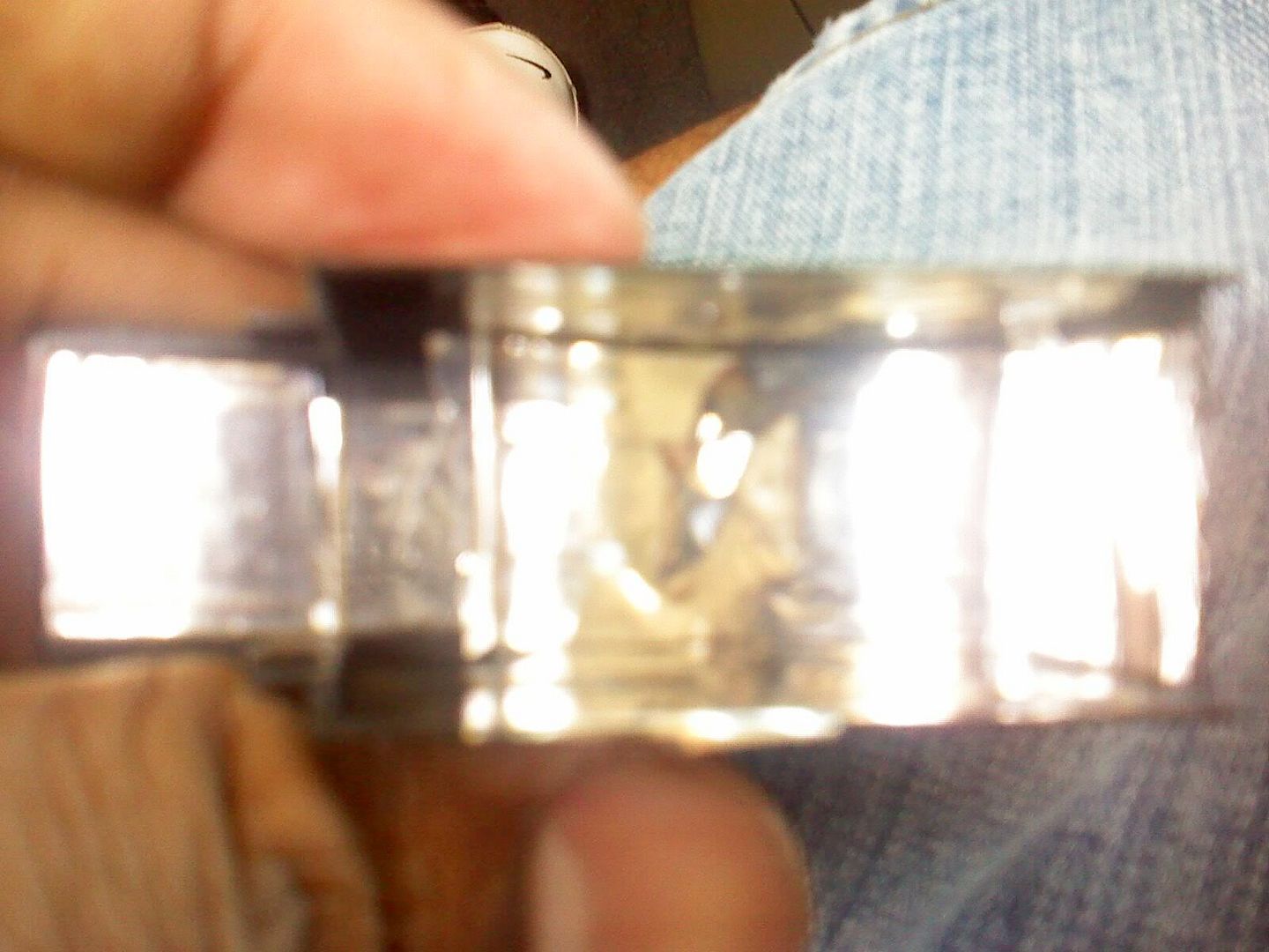

    AND Mirror or reflective tape so you can change the housing from this:
    to this:

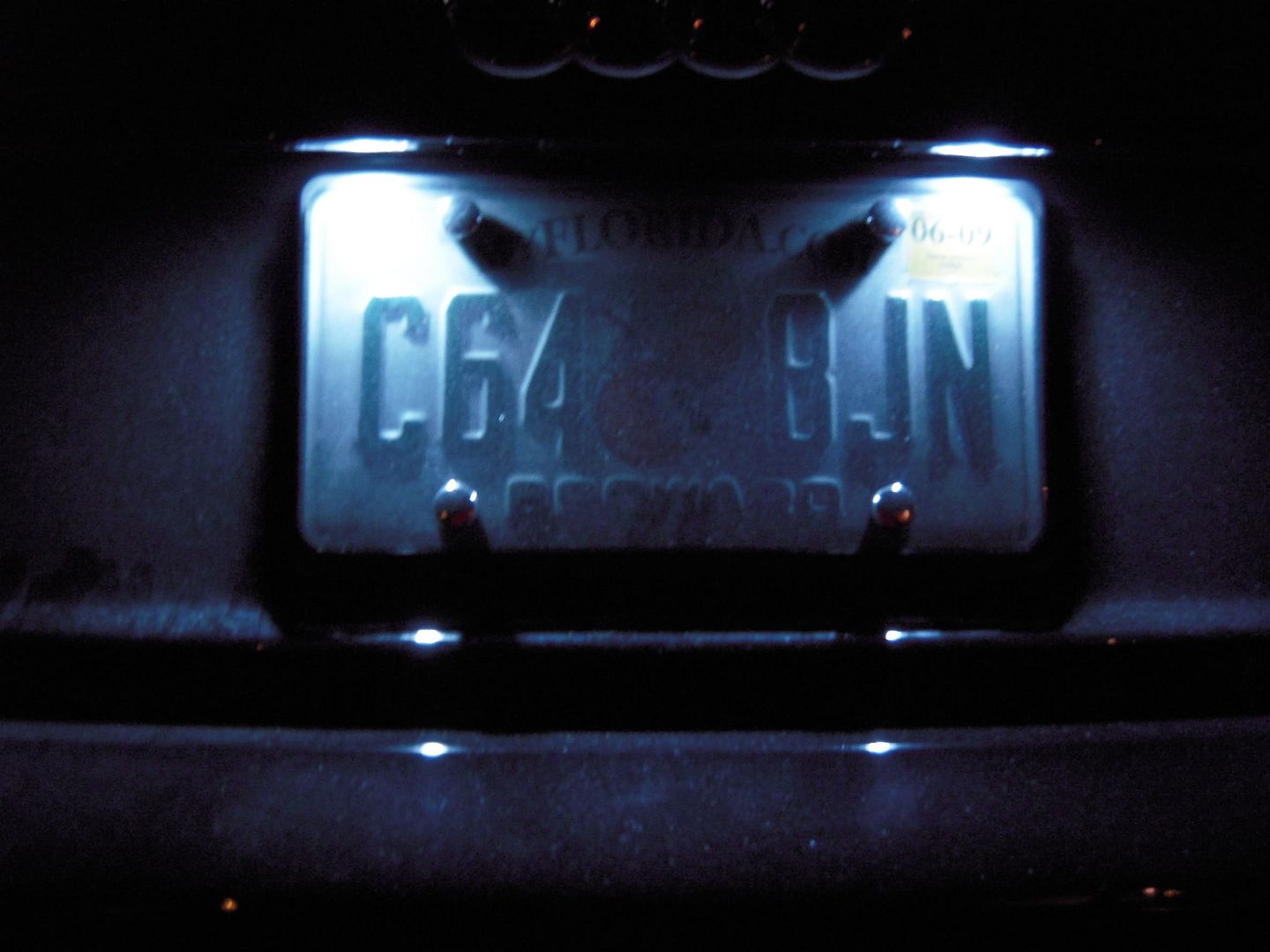

    License Plate Light
    You need 2: 3910-x6 LED Festoon bulbs
    or High Power 3-LED Festoon bulb

    WOW, thanks a ton. How hard is it to change things/get to the bulbs? Any info on changing 'em out?

    Do I need to shut down anything more than the car to make this swap? Is it anything to think about? Can I use the High Power LED Festoon Bulbs ?
    No once the car is off ur good. yes u can use the High Power LED Festoon Bulbs where applicable.

    Ok, I just ordered everything you names. Waiting for it to come thursday or friday. Was it hard to change? How much does it take?

    it is easy to change if u have general mod experience, takes about 30 mins for everything.

    I can understand the interior lights not flagging up in the DIS but don't the number plate bulbs throw an error. Have you needed to add resistors?
    Senior Member Four Rings B_Boy's Avatar
    Nov 24 2008
    35615
    2011 Infiniti G37S Coupe
    South FL, USA
    Re: LED Interior Bulbs swap info details...
    no i have not had any problems with the number plate bulbs, i believe the resistors are built in the bulb.

    Aha! Good news.
    Which bulb holder did you silver up? Why? Does it make much difference?

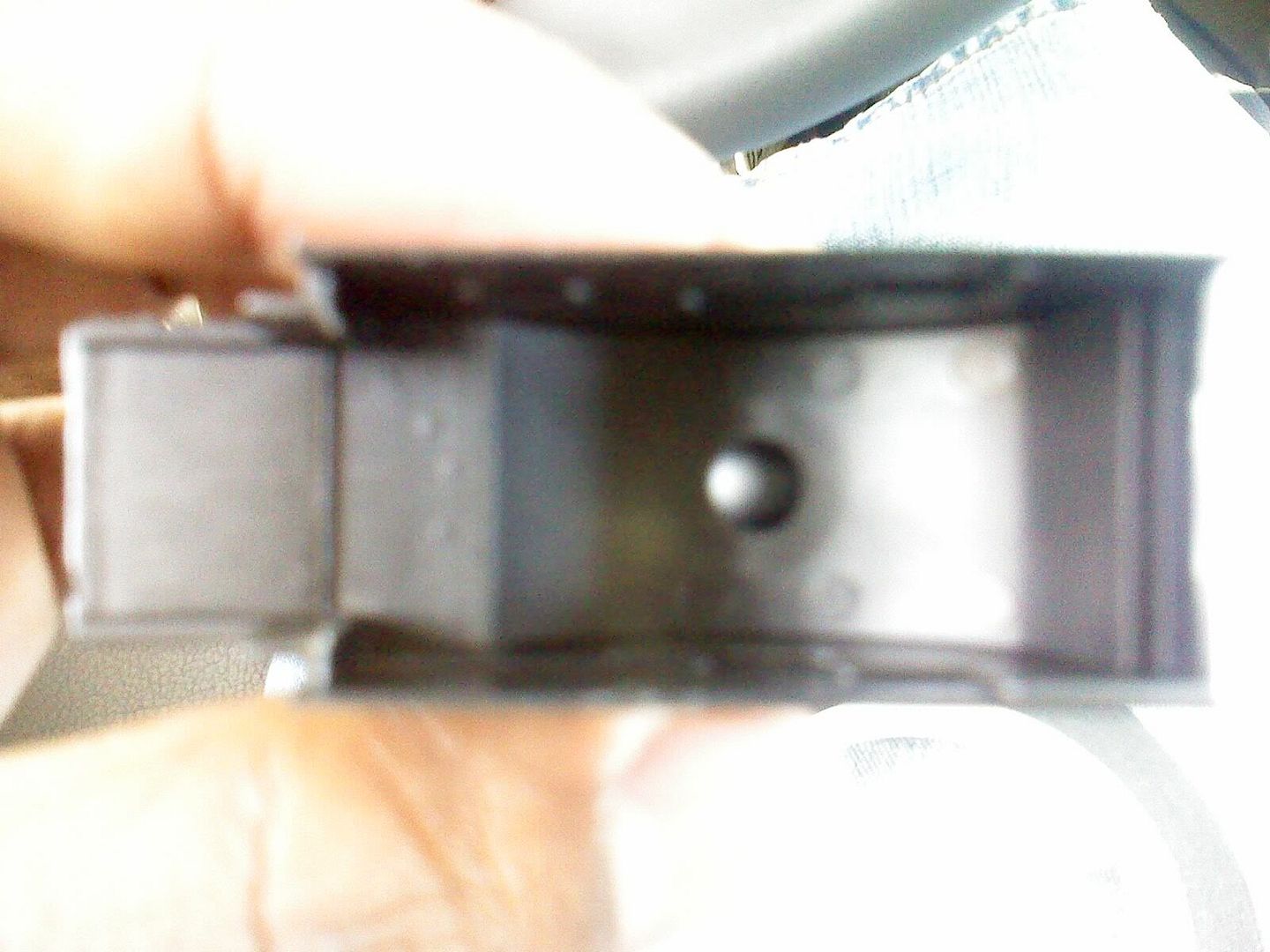

    I "silvered" the housing under the doors because when u put that bulb in it has like 6 leds, 2 pointing up, 2 pointing down and 2 point out. So the point in silvering the inside of the housing is that the light that doesnt point down toward the ground can be reflected down and making it brighter. If you dont silver it then the black housing will absorb most of the light making it a sucky mod.
    +1 here.
    The actual bulb seemed a bit bigger than the stock. So one of my LEDs got its ends bent a tad.

    B-boy, what tools did you use to take the lights apart and complete the al the changes?

    just a flat head screw driver

    B_Boy or astaikos10........In the front roof dome housing, does the whole plastic frame of the housing come down to access each bulb, or do you remove just the plastic panels for each individual light? Also, where is the best place to start wedging the flathead in safely?
    STaSIS ECU & 23mm RARB / AWE FMIC & Exhaust / Eurocode IP / Carbonio / 034 TIP / 20% Tint / S5 Mirrors / Rotiform MIAs 19x8.5 / Hankook 255/35 / H&R Avant Sport Springs / RS6 Pedals / Hoen Fogs /Stoneguards / ecodes / A4L Fog grills
    Aug 27 2008
    32440
    League City, TX
    IIRC, there is a torx screw in the sunglasses holder. Then it's just sort of held in with spring clips. I didn't use a flathead -- just kind of wedged my fingers between the headliner and the plastic of the dome housing and it came out pretty easy.
    astaikos10 -- I used the 3 High power LED's for the front dome -- they are brighter than the stock bulbs. Below is a pic of half stock/half LED on mine... The colors are wacky since I just let the camera auto select -- I think it was confused -- they are not this blue in reality. You see the LED's are still "hot spoted" but so are the stock bulbs -- the 6 HP might be a bit wider due to the layout, and 2x as bright (which IMO would be too bright -- even with these 3x HP bulbs I feel like I'm in a spot light when it's dark)...

    ^^ Great, that was exactly what I was hoping to see. It does seem to fill the dome up with light, just as the old lights did. The brightness was what i was trying to stay away from, hence y decision to go with the regular, not the high power LEDs... unfortunately things don't always play out. Now I'm going to have Natural White map lights, front and rear (old dome was Nat. White too) and since the HP LED's only come in Cool or Warm White, Cool it is. Good thing i'm the most OCD person that enters my car! The lights sure have been a hit all around though... people i never would have imagined to notice, have.

    YRC! That was really easy actually, The hardest part was finding the right size Torx Bit. (which is a T25 for anyone reading this)
    I imagine the rear "dome" is held in place by similar metal tension clips.

    Actually no... the rear "map lights" cover pops right off with a flat head. Slide it under the one side, and leaver it a little until it pops out, from there you can just use your fingers to pop the other half off. And FYI the torx you needed was in your tool kit!

    Thanks astaikos10......I actually got the whole rear "map lights" housing to come down with minimal prying. Then the "cap" piece also came off when I was inspecting the housing.
    Thanks for the tip about the tool kit. I remembered seeing a Torx tool in there, but I never thought to use it for a task like this.
