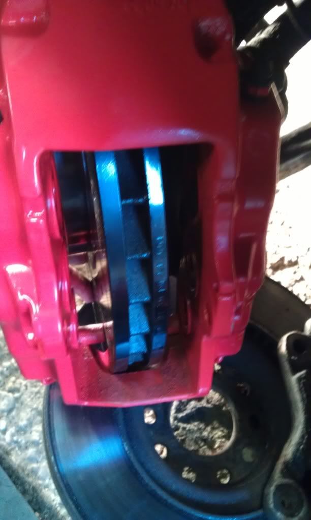

    Just snapped some pics of the 330mm vs 350mm pads with the ML55 rotors.
    I'll let the pics do the talking.
    330mm pad lined up on rotor top:
    330mm pad on inside edge (doesn't over hang):
    350mm pad on outside edge:
    350mm pad on inside edge:
    Put a piece of clay down and smashed it where the 350mm pad over hangs so you can see it a little better:
    330mm pad on top of 350mm pad
    350mm pad vs 330mm pad so you can see the difference.

    That's exactly the kind of info I needed.
    The spacer idea crossed my mind, I guess it all depends if there is spacer with small enough diameter to fit under there.
    I also have a set of used pads that came with my calipers and realized that once I remove the friction material, the steel plates can be used as spacers/backers for new pads to compensate for off-center disc or for thinner disc problem with these rotors.

    also remember the center bore is 68mm for the part not 57.1 and a spacer would probably push the rotor off the seat and be an issue unless you weld it to the rotor. as the contact area of the pad is different. 59mm for the ML rotor and 62.5mm for the GL rotor. So the pads might sit differently. Worth a trial fit perhaps for someone who has time and both 330mm and 350mm pads.

    So for ML55/GL450 rotors I need some hubcentric rings then as well or letting it hang on my studs would be fine?
    Edit: Nevermind, realized that it would apply if only using spacers. /EDIT
    Provided GL450 was fitted and spindle cleared without spacers, extra pad backing behind outboard new pad would prevent outboard pistons from over extending. With just GL450 rotors in, the friction surface of rotor would be 3mm further away than with factory 34mm rotors causing possible issues at the end of pad life.
