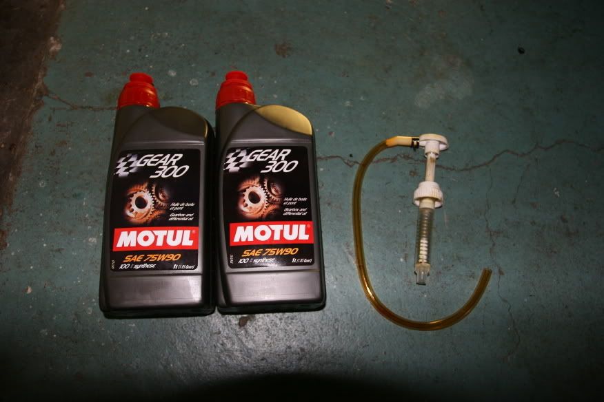

    10mm hex socket
    3/8" socket wrench with a decent amount of extensions (No more than 12")
    1.5L of your diff fluid of choice (I recomend Motul's Gear 300 SAE75w90)
    Hand Pump
    Bucket to catch old diff fluid
    Jack+Stands
    Rags

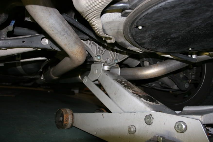

    Step 1: Jack up car via the rear diff mount and place stands on either side of the car (Or use a lift if you have access)

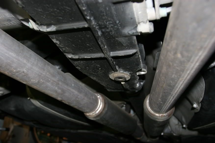

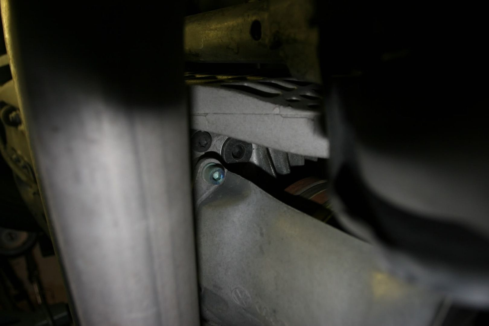

    Step 2: Locate the 10mm hex bolt drain plug. Its super easy to find, its the only bolt on the bottom of the diff near the drive shaft
    Step 3: Using your socket wrench, losen the drain plug and let contents drain into bucket etc..
    Step 4: Replace drain plug

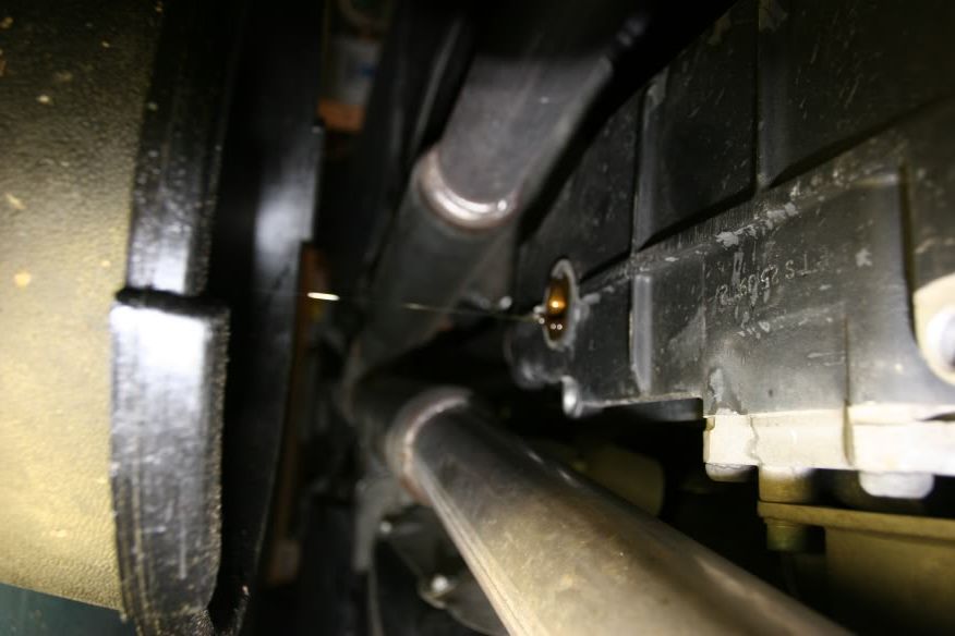

    Step 5: Locate the 10mm filling plug and losen.. Its located on the right side of the diff towards the back of the car (Plug faces the right rear wheel)
    Step 6: Using your hand pump, pump in about 1.5L of gear oil.. If you had a crappy hand pump like mine, it should only take about 10-15 mins to fill the diff. You'll know the diff is full of fluid, because it will start to dribble out of the filling plug. (I also recomend keeping track of how much you've pumped in via the scale thats on the bottle)
