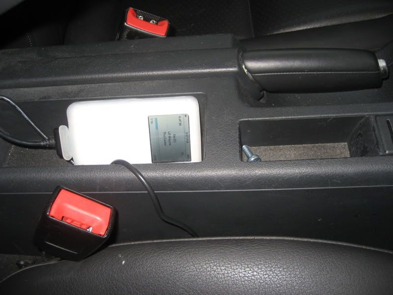

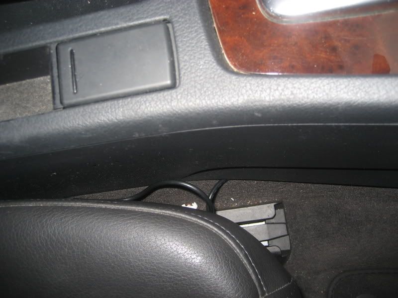

    i actually took the ipod cable out from the glovebox and tucked it under the centerconsole on the pasenger side. here are some pics

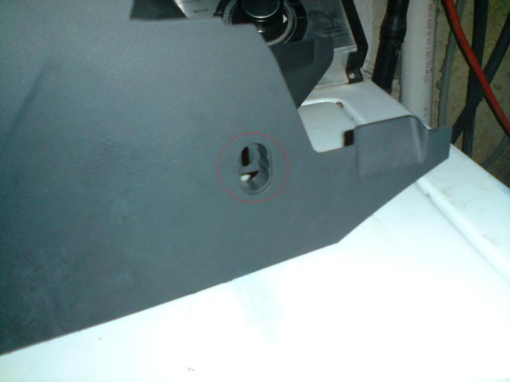

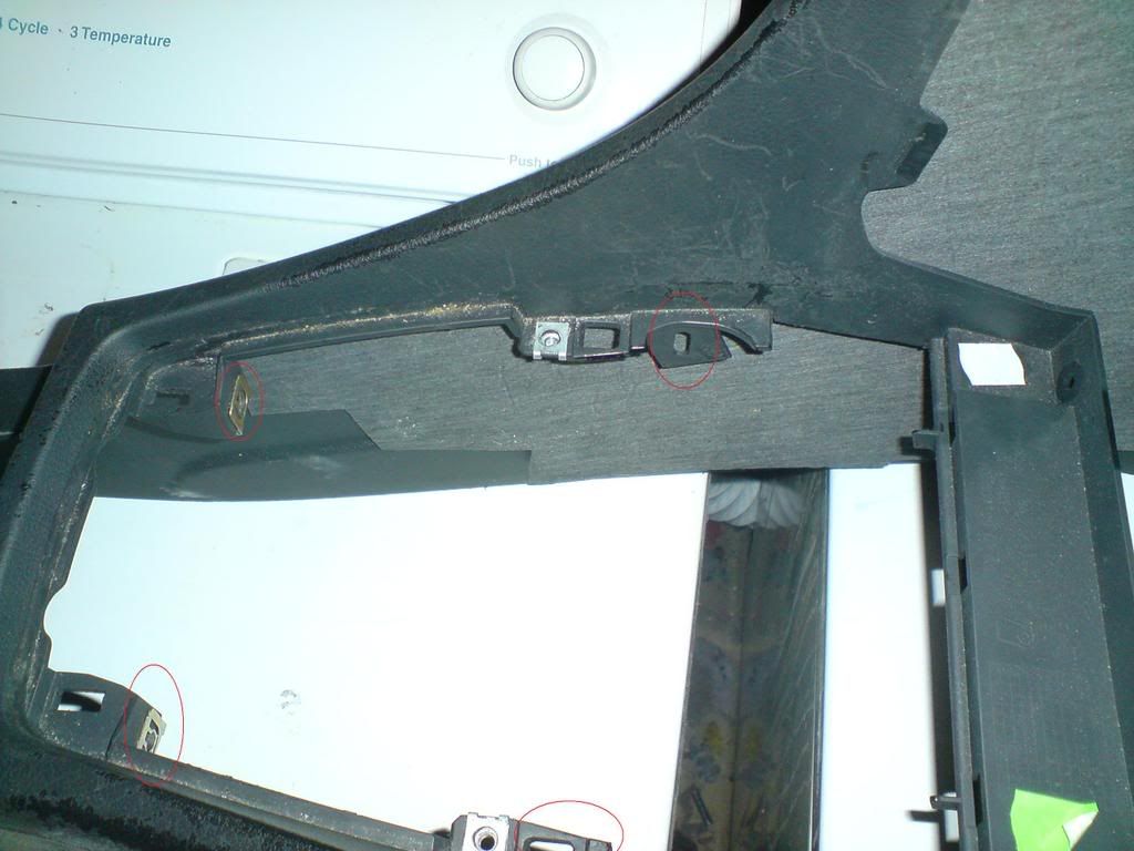

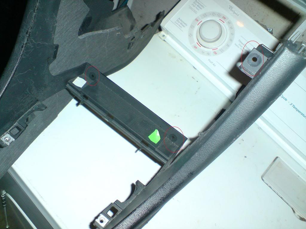

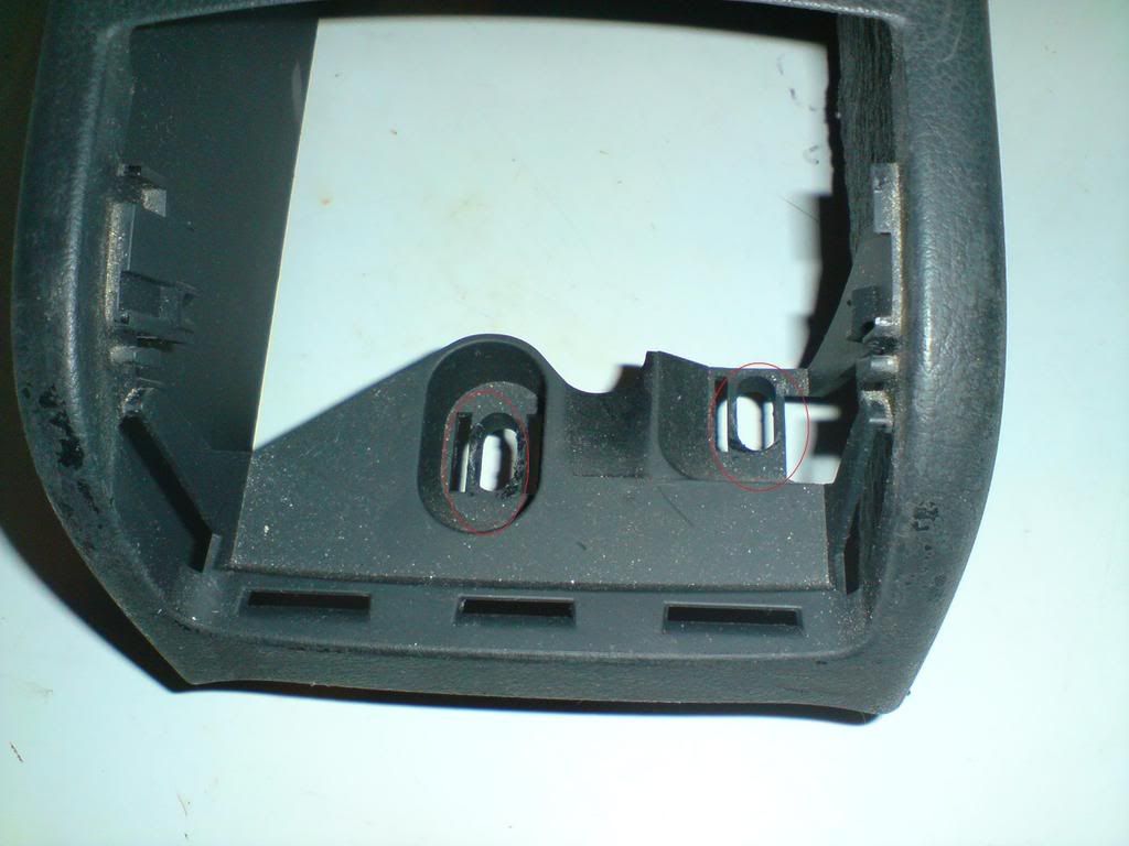

    I started off the swap by removing the trim piece above the cup holder and the shifter trim.
    Next I removed the radio, climate control, and ashtray in that order. Next, I removed the rear ashtray and the rear seat heat controls. From this point you should be able to see all of the bolts that are holding the console in place.
    In this picture you can there are two 13mm nuts that need to be removed and the armrest is secured in the same opening.
    In the rest of the pictures you can see where I circled the locations of the bolts that hold the console in place.
