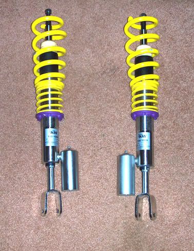

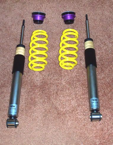

    KW V1 (4cyl-Q) – (~$1200) : Linear Front Spring and rear spring. Front is 580#, Rear is 470#. Height adjustable on car. Damping is NON-Adjustable

    Can you recheck if the KW use linear springs?
    Pic courtessy of Bs6x...
    cheers! Mike
