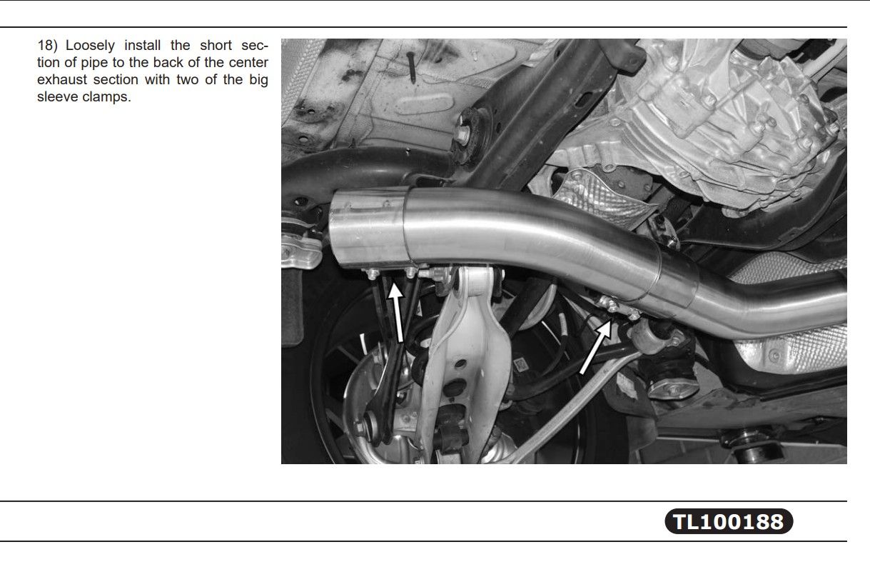

    Quote Originally Posted by GID View Post
    Resolved for the most part but not completely. It's no longer resting on the cross brace but it is still resting on a small part of the heat shield. That's not a huge deal because it shouldn't transfer any unwanted noise but still not ideal.
    Sound at idle and cold start is great. I haven't driven it since resolving the issues. Prior to resolving, there was some rattle but that was obviously because of the cross brace. I'm not able to drive it now but I'll take it for a ride and check back in.
    So the issue with the fit against the heat shield - it looks like when APR was fitting their big, singular mid-pipe that connects to the muffler assembly, they didn't account for the SQ5s & SQ5 Sportbacks that have the optional Sport Package with the Air Suspension, as the single mid-pipe is contacting the heat shield for the Air Compressor.
    Their instructions clearly show a B9 SQ5 w/o an Air Compressor:
    To add insult to injury, the band clamp with its increased diameter is "right there" where the big pipe runs out of real estate... Ooof! With the stock system, it's two smaller diameter pipes that obviously route around the Air Compressor heat shield with a bend in both pipes.
    It would better if APR modified that pipe to put a bend/kink or relief in that area to prevent contact, when the exhaust system inevitably moves around on the rubber mounts as intended.
    Waiting to hear how they resolve this. It will effect alot more B9 SQ5 & SQ5 Sportback owners, because the Sport Package w/Air Suspension is a popular option.

    I just spoke with our engineering team, and we’ve identified the issue. Vehicles equipped with the optional S sport package, which includes the adaptive air suspension, also come with a compressor and heat shield. Unfortunately, that’s what’s interfering with GID’s installation.
    We’re updating the website to reflect this limitation—apologies for the inconvenience.
    Please don’t hesitate to call our team at 334-502-5181 and we’ll issue a full refund.
    I realize this isn’t an ideal solution, and I don’t have a car on hand to confirm, but it looks like there may be a bit of space behind the heat shield. If anyone with the system wants to take a look and see if it can be gently repositioned to allow clearance, we’d love to hear what you find. But regardless, give us a call—we’ll take care of the refund.

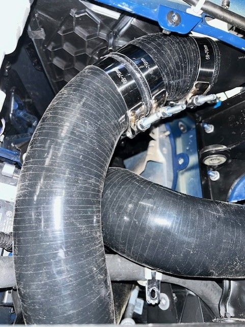

    Arin - appreciate the feedback. I've purchased many APR products over the years for my Audis, and the fit & finish have always been remarkable, so when GID posted those photos, I was surprised to see the interference issue with the heat shield.
    However, yours is not a unique situation - I purchased an IE A2A IC last year for my B9.5 RS5, and it was marketed as fitting MY2018+ RS5s. However, Audi changed the Charge Pipe from 2-piece to 1-piece for the facelift version, and since my '23 is a facelift version, the included molded IC hose did not match-up to the charge pipe inlet, so I had to make some modifications to these hoses, and add a male-to-male coupler to make a solid connection. IE had used a pre-facelift RS5 to baseline their fit model for the A2A IC - they never realized the facelift versions were different, until I brought up the issue to their customer support team.
