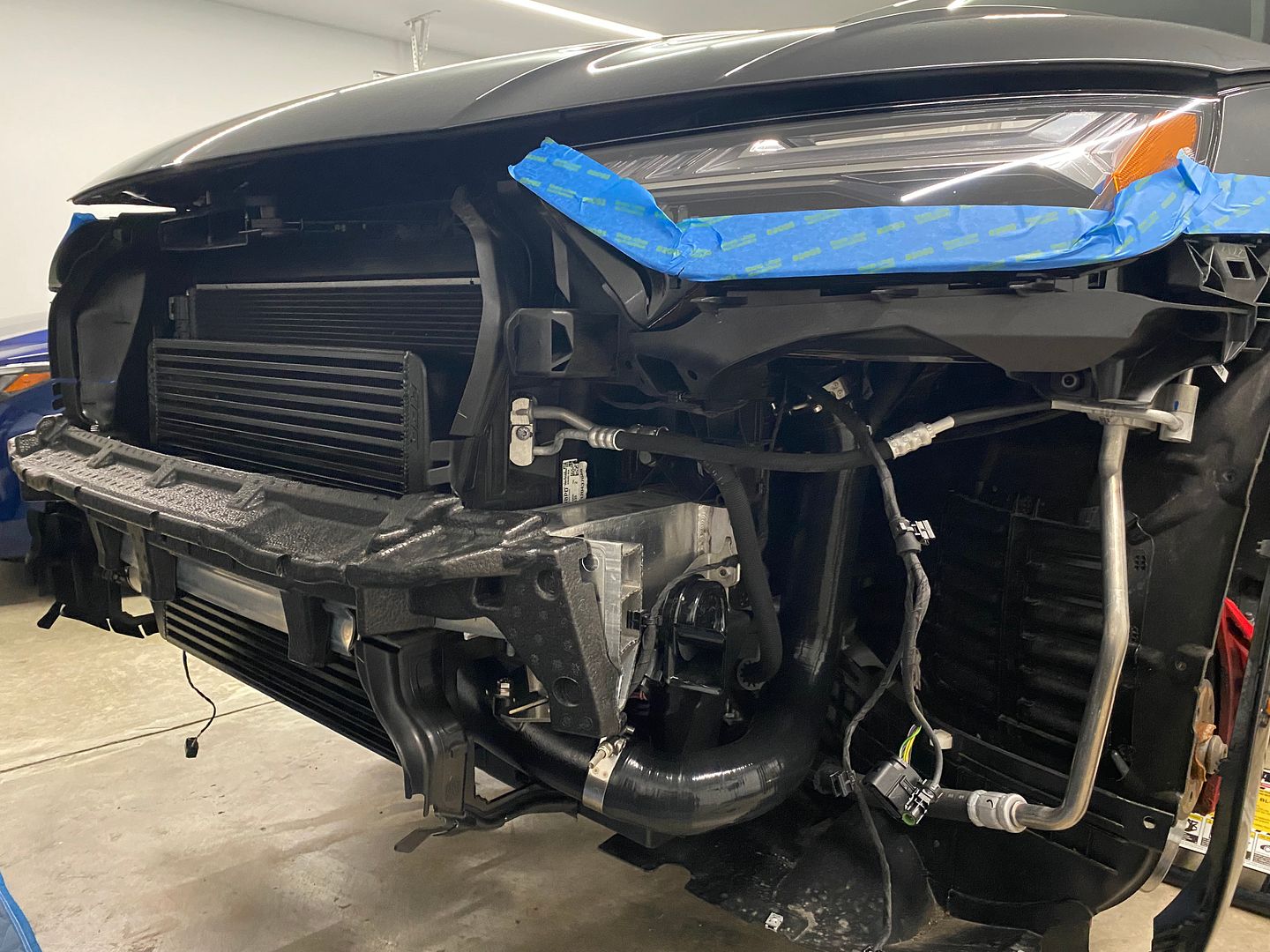

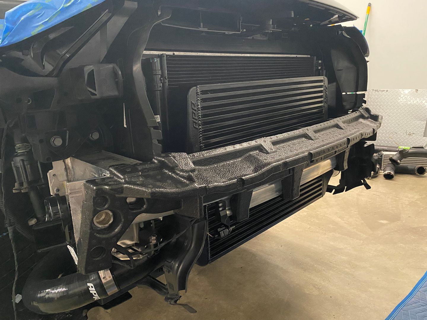

    Got the FMIC delivered and HFC from a Facebook group for stage 2:

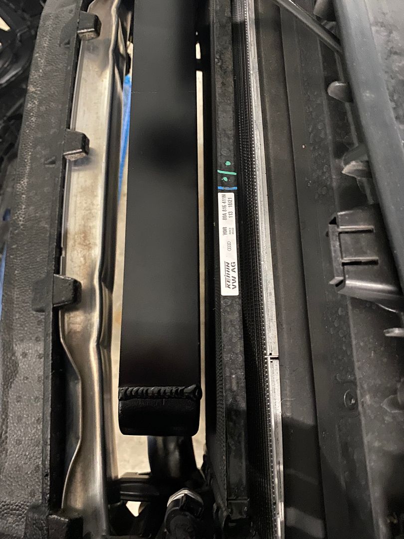

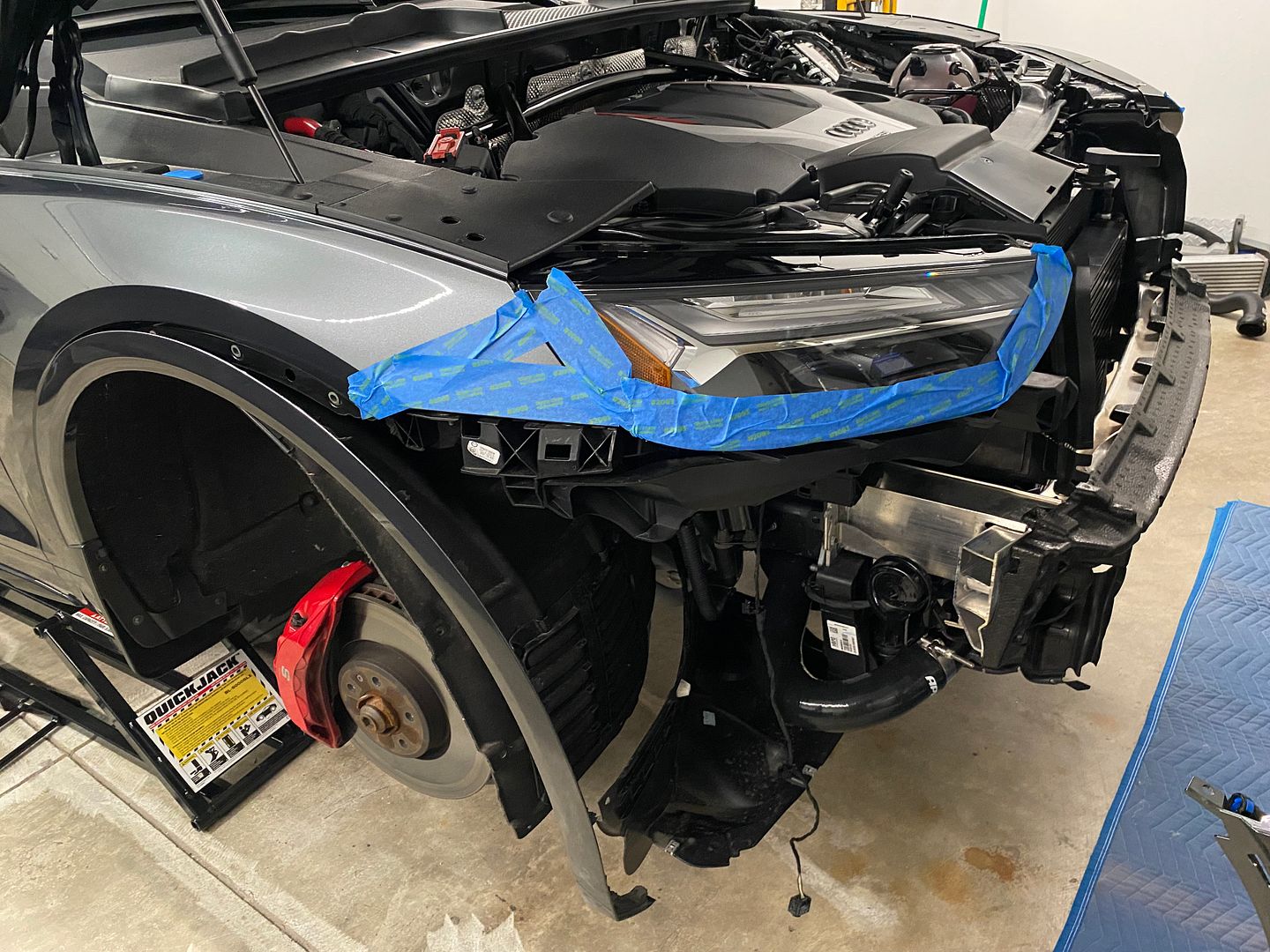

    Pretty happy with the CTS FMIC (and HFC). Had it installed today and so far so good. Went 034 stage 2 at the same time and the IATs seemed pretty close to ambient... although I didn't track it consistently. Let me know if anyone would want me to log via 034 app.
