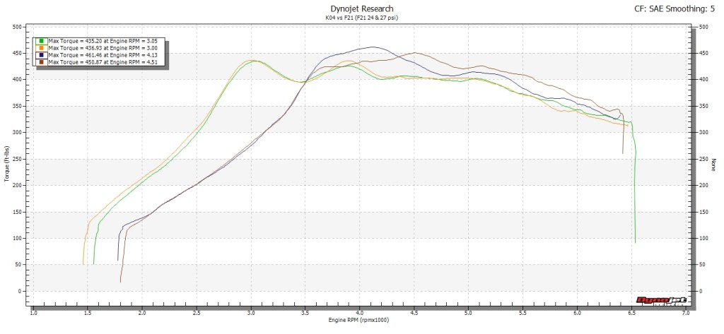

    Jbain i'm sure you're aware of this, but with the fluctuation from one dyno run to the next without changing anything at all, and given the source... honestly I think you're better off just searching the forums for another source. I can't think of one offhand with data, but i'm fairly certain this same combo has been documented publicly. regardless it's pretty easy to infer what this setup does. The data that will come out from a 3rd party, at some point, will be very, very predictable. These are just off-the shelf parts man. I think you're just asking to get misleading information anyway.
    It's gonna look like https://myaudis4.com/2016/02/25/fran...-dyno-results/ only more so. and no obviously this isn't a tuner elected thing to preserve the engine -- this is a childishly absurd lie. there were some cool k03 e85 builds producing crazy power down low. This guy's just so full of shit from square one, and not just this time, that I wouldn't trust a single thing he says or shows at any point. I mean there's a long history of shady crap he's lied about in his testing, and not just the cherry-picking numbers, it's direct deception as well.
    Just gonna drag it on here so people can see directly what the truth is, with zero exceptions in modern history on any platform:
    which of course directly contradicts, with extreme prejudice, any and all assertions otherwise, including "Short answer is - there is no range stock k04s has advantage here." and all similar insanity that has no basis in reality, whatsoever. This is incredibly stupid.
    Just so the average person understands, here's a more complete picture of what 'turbo lag' is beyond what you measure on a single dyno pull. well, what everyone but Mocke measures on a dyno anyway: https://myaudis4.com/2016/05/15/tte5...st-onset-data/
    It's truly remarkable the man made multiple charts, added labels, and then goes out of his way to explain how what you're seeing is not what you're seeing, I deliberately delayed the onset because these turbos are just that good. I mean if it was anyone else I'd think they were having a laugh. But this is real, you can't make this up.

    The data from my setup is the same as OP. It's self explanatory. Obviously you print them out, stack them on top of each other, cut a whole in the middle, then stare into the void for answers. No lag!

    I'm just gonna make this expressly clear, so people understand what this is:
    Instead of making a single chart overlaying his turbo with a k04, as you'll eventually see... What he did was make 2 charts, with the apparently deliberate intention of not showing you the increased turbo lag; this appears to have been the entire purpose of the dual charts for it lacks any other logical explanation. Now you can still see it, of course, but what he's done is obfuscate/hide it. He then makes the claim there is no additional turbo lag (paraphrased)... which is incredibly stupid and obviously false, but nevertheless par for the course. He made the same claims last time, which were of course proven to be utter nonsense -- among a litany of nonsense and other false claims.
    Basic physics precludes this from being the case. And basic logic means that his sole intent here is to commit fraud. Again.
