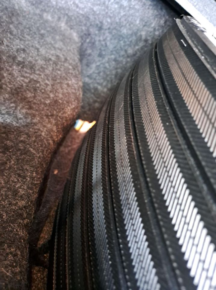

    I have no idea when exactly this occurred, or by who at this stage as the vehicle has been serviced by 2 deferent Audi dealerships in 2 different countries plus one transmission shop in the past 18 months, but I do know that there is no longer a B&O sub installed in the spare wheel of my 2013 Q5.
    All I do recall is at some point my wife complaining that the sound had been adjusted and the bass seemed to have gotten very soft - so she adjusted it to almost full...
    I was running Car Scanner over the weekend and scanning for faults when it popped up:
    02247 - Subwoofer open circuit.
    So I went to the boot/trunk and lifted the flooring and stood there in disbelief for a moment, cause I swear that there was a cover inside my spare wheel which is no longer there... I also noticed that the sub wires were cut off at the plug and stuffed under the carpet in the wheel well - can only guess this was to hide the fact there used to be something to plug into those wires in there if I ever went to change a flat.
    Anyway here are the questions:
    1. Can I simply buy a replacement B&O sub off eBay or the likes and plug it in? or are these things coded to the MMI?
    2. The ones I have seen on eBay from A4/A3/Q2/Q3 so far all have a 4 pin plug on the sub and seem to have two speakers in them, the bare wires that I have lying in my boot are only 2 wires - so are there different subs?
    3. Anyone know where I can purchase the plug to make up the end of the wires again into a plug to connect to the Sub when I get hold of one?

    The sub enclosure is nothing more than a speaker. Those two wires are just speaker wires from the amp.
    When looking for a part, it's only productive to look for the specifically relevant part. The only correct p/n for the subwoofer for the type 8R (B8 Q5) with B&O sound system and without hybrid drive system (Q5 hybrid) is 8R0035382A.
    The harness plug is 1J0972923. No idea which wire terminal p/ns; dealership should be able to say which repair wires. The wires are either 1.5 mm² or 2.5 mm². The wiring diagrams are inconsistent.

    I thought as much for the speaker...
    Although the only B&O ones I can find online currently are all 8V0035382C (100+100W, 8+8ohm)
    I'll try hunt down the part number you have given me there and see what I come across.
    The wires, not too phased about, I can measure the thickness of the ones in the car now. I'll see if I can order the plug and terminals from my local dealership.

    Why are you looking for subs that have no relation to your vehicle? MIB2 B&O DVC subs are not going to work.
    8R0035382A. Such as https://www.ebay.com/itm/304586136870 Without the A is the sub for the standard sound system, with the A is the sub for the B&O sound system, in the 8R Q5.

    Awesome thanks!
    I had no idea what I was looking for to be honest. I simply google searched B&O subwoofer for Audi and that was the part number that it came back with and the eBay links.
    I have since found one with the part number you have provided for £26 on eBay!
