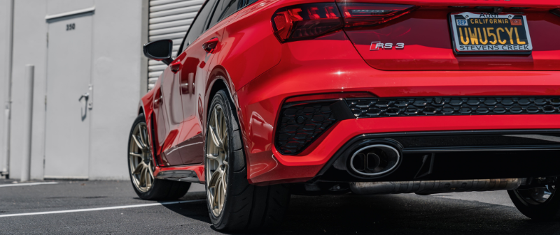

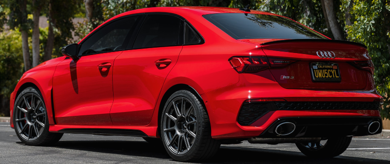

    Currently, we have tested and confirmed fitment with two of our existing MQB Audi wheels, the 18x9” ET42 Flow Formed SM-10 and the 18x9.5” ET41 Forged SM-10RS. Both of these wheels utilize a 5x112 bolt pattern, a 57.1mm centerbore, and have OE spec R13 lug seat recesses, making them a perfect fit for the 8Y RS3.
    The 18x9” ET42 SM-10 is a bit more of a street-focused fitment and was tested with a 255/35-18 Michelin PS4S tire. In the rear, that wheel bolts right up and offers a flush fitment with the fenders without poking past them. Up front, we used a 20mm spacer to match the rear track width and to get a flush fit with the front fenders.
    The 18x9.5” ET41 SM-10RS is a bit more of a track-focused fitment and was tested with 265/35-18 Falken RT660 200TW tires (which run quite wide for their size). In the rear, the fitment was a touch more aggressive compared to the rear of the 8V RS3. Since the car we tested was on stock suspension with stock camber specs, there was a bit of visual poke. However, one could easily dial-in that setup with some suspension and camber mods. Up front, we once again used a 20mm spacer to match the rear track width and for a flush fit with the fenders. With the 20mm spacer, there was a bit more fender clearance compared to the rear but we would still recommend running some additional front negative camber, especially with 200TW tires, to ensure a rub-free fit under suspension compression.

    Saw the 8Y fitment guide a few days ago. I would purchase the 9.5x18" square setup if they were flow formed. My track wheels might take damage and I already spent money on a forged set, staggered offset 9" set.
    I'm curious if 10" wheels would fit without rubbing. I think the widest I would go is probably like 265 or 275 on a 10", so maybe?

    We likely won't offer a VW/Audi 5x112/57.1mm CB 18x9.5" wheel in one of our flow formed designs, as most of the folks with 8V/8Y RS3s wanting to run an aggressive fitment like that tend to lean more towards our forged offerings. That said, we do have our 18x9" ET42 flow formed SM-10 design that can fit in a square setup on the 8Y RS3 with spacers up front.
    From our testing, the 18x9.5" ET41 fitment is a bit more aggressive on the rear of the 8Y RS3 compared to the 8V RS3 and requires a bit of tweaking to fit without rubbing on the fenders. Due to this, a 18x10" square setup would definitely not work on the 8Y RS3. However, with the right offset and a bit of front camber, you could potentially get a 18x10" to work up front in a reverse staggered setup using a slimmer rear wheel. That said, from the survey results we have gotten so far, we will likely be pivoting to a 18x9.5" ET20~ front VS-5RS forged wheel to pair with our existing 18x9" ET42 VS-5RS in the rear for a spacer-less reverse staggered fitment on the 8Y.

    Not yet, but the above pictures in the thread with the 18" SM-10 and SM-10RS should give you an idea of how they will look fitment wise.
    We are expecting to get our 18" 8Y RS3 VS-5RS samples within the next couple of months, so once they arrive we will be sure to get some professional shoots done to show y'all the finished product!
