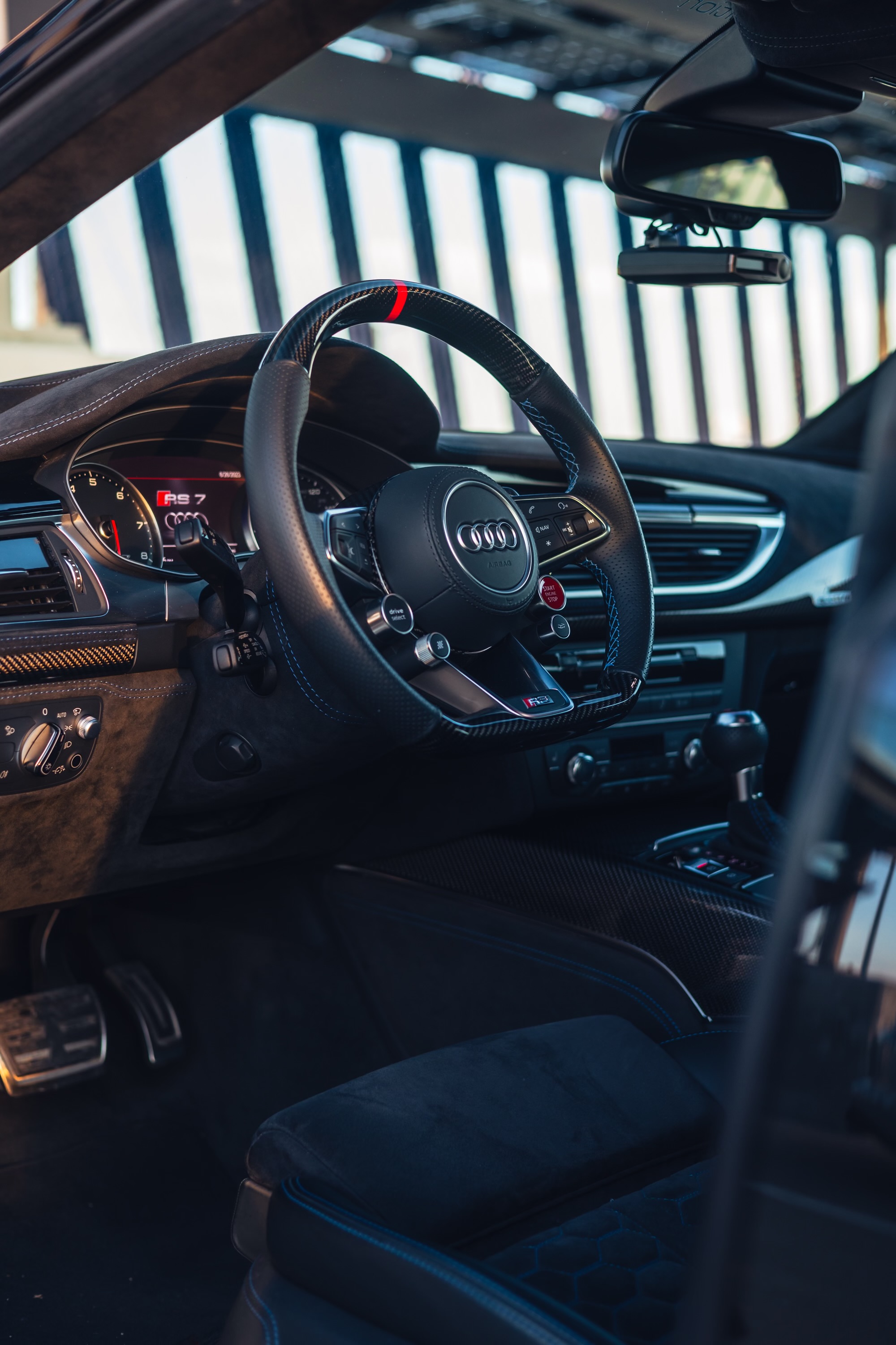

    did mine a while ago..

    Looks cool! Is this an OEM R8 wheel?

    Its a TTRS wheel
