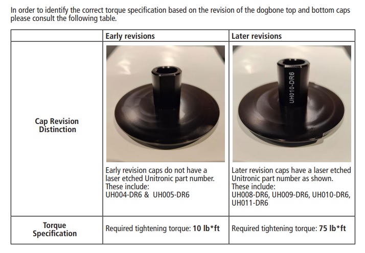

    There was an update to the dogbone and new instructions state 75 ft lbs for uh008-dra.
    instructions for 001-dra - https://www.getunitronic.com/hardwar...lguide_v10.pdf
    instructions for uh008-dra - https://getunitronic.com/hardware/im...lguide_v10.pdf

    Thanks for your feedback. Before going further, I suggest checking the version you have and the corresponding torque specifications. See the image below. Let me know if you have any further questions after checking!

    John thank you for these updated instructions.
    Torqued the bolt down to 75 and it is greatly greatly improved.
    I had no complaints with the product it does a fantastic job eliminating drivetrain slop. The sound I was hearing just didn’t sound right.
    It is now at acceptable levels and I’m happy with it :)
