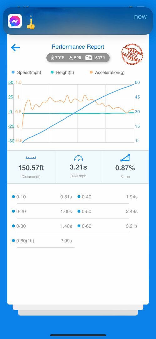

    Quote Originally Posted by GaBoYnFla View Post
    That's awesome numbers.....Do you guys have E85 out there? I don't want to go full E85 but a gal or two make it perform even better. I need to do a 1/4 run soon.....I have a draggy. Was the 3.05 the main number? What was the "1Ft" roll out? My 1Ft was 2.99.
    Here are a couple time slips and Dragy screenshots from my latest runs: https://imgur.com/a/tLQlD0v/
    Dragy and the slips seem to be slightly out of sync, but you get the idea. Also, that one run that I had a 3:05 0-60 I ran out of gas and lurched a bit further down the strip, so the 1/4 mile time isn't ideal.
    As for gas, I've been putting in like a gallon or two of E85 from my local station in addition to 91. That said, I have done zero weight reduction, and am on all season tires.
