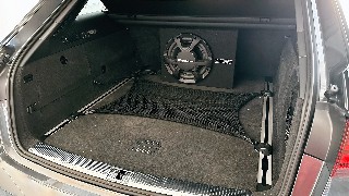

    Do you have sub in the trunk? If so, add an 8" sub and amp. I used Kenwood sub and Alpine amp.

    Out the door for less than $500. This is all I used and I love it for how cheap it was.
    If you want to spend more, JL has a slightly better powered sub.
    https://www.amazon.com/AudioControl-...NsaWNrPXRydWU=
    This is to help convert the signal to eliminate the bass roll off of the Bose system.

    I bought a used Rockford Fosgate P300-12 on ebay for ~$150. It has a high-level input so I spliced right into the stock bose subwoofer wires at the harness in the trunk. Another ~$30 for an 8ga OFC cable kit on amazon and that's it.
    You will never be able to tune the 8" bose sub to sound good. There's a reason people call it a subwafer, it's small and has awful frequency response.
