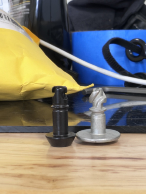

    I received my OCT composites tray, went for the full Monty "Ultimate" version with Kevlar, as well as CF. From order to receipt was like 3 weeks.
    I'm a reformed composite boatbuilder, and can attest that the lamination quality is top notch. The mold side has imprints from a real VAG part, so they used a real part for their plug, and pulled a mold from it.
    The fit and finish do leave a bit to be desired.
    • Kevlar in the lamination schedule makes for fuzzy edges, but does not account for me needing to trim in a couple of places.
    • Also, as it's thicker, the OEM dowel pins are very short, and in some cases, too short.
    Side note: does anyone know of a source for longer dowel pins?
    Overall, very happy. When the rest of my RS4's underbody panels need replacing, I hope OCT composite is still making them, as that's what I'd prefer to get.

    Please post a link and/or details for the longer dowel pins when you find them. I checked FCP Euro and the stock dowel pins are 6x18mm. I did find a 20mm version; not sure if that would work. Here is the link to the 20mm version: https://www.fcpeuro.com/products/vw-...sat-8d0805121b

    I got all my OCT panels on, front needs trimming in a few areas and opening up of fastener positions for OE bits. I didn't think it fit terribly, the thickness of the CF vs. the plastic does make the 1/4 turn hardware really hard on the front 4 positions with the bumper plastic involved. For the dzus hardware, I could not find much beyond 19mm. These worked out ok, road tested over the weekend and no issues in triple digits.
    https://www.amazon.com/dp/B0CF92CWZJ...t_details&th=1
    Sides and rear all fit really well for something aftermarket and very stiff.
