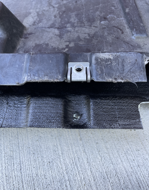

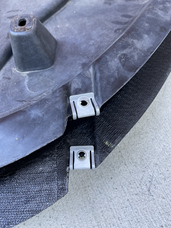

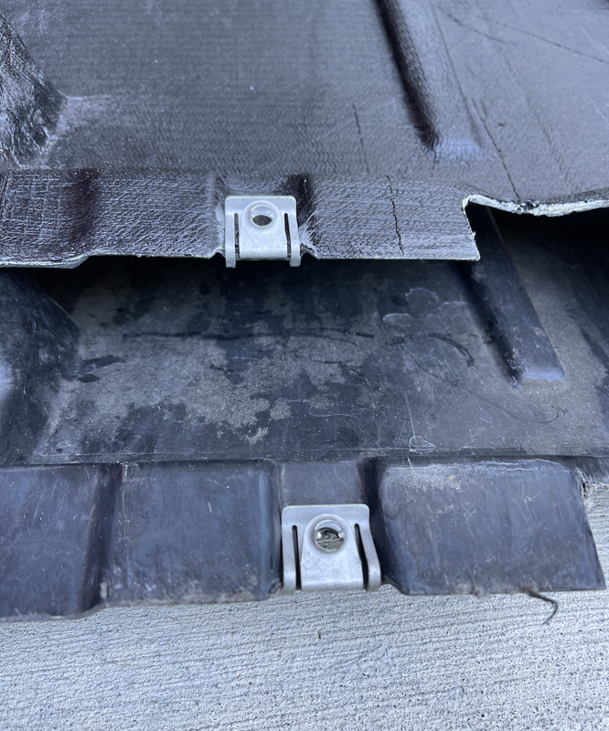

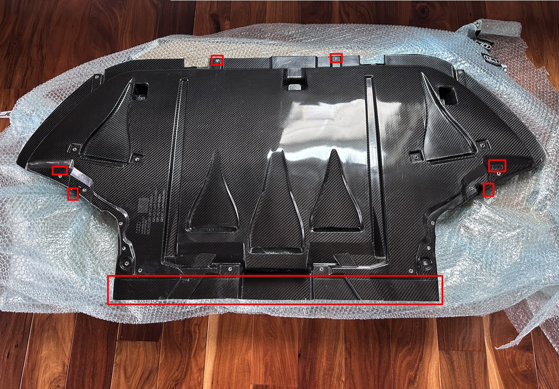

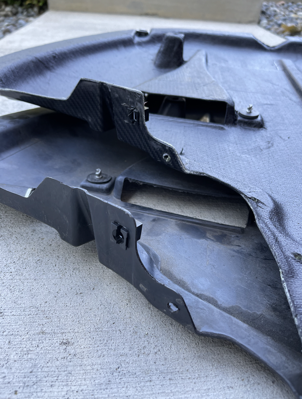

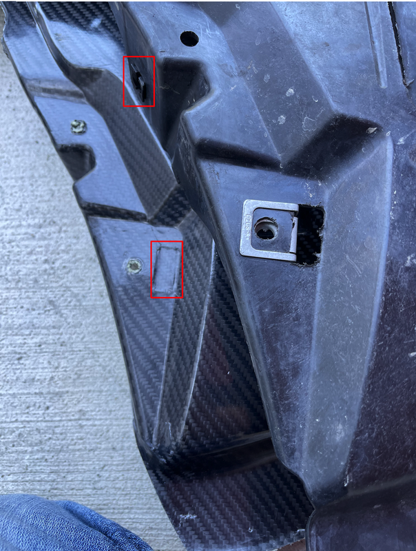

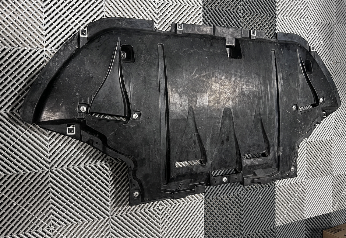

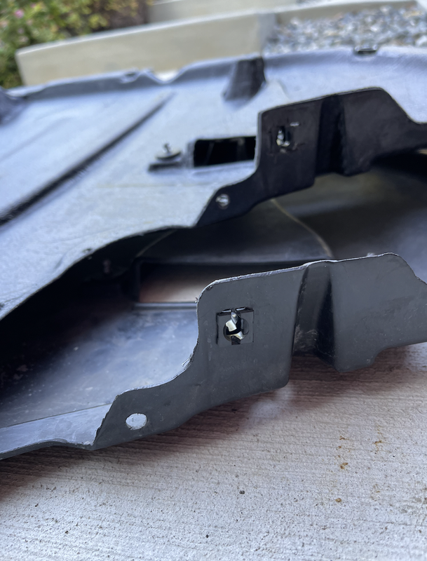

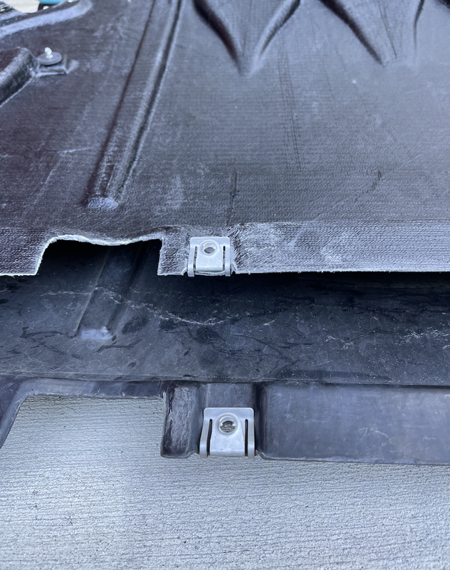

    Used a dremel for cutting, safety 3rd in most cases but wear eye protection and a mask cause cutting carbon is nasty. Here are some photos of the modification areas but they are all visible when you look at the product/mold the spots are there they just aren't done for you, I had a clean splash shield to compare with.
    Front outer speed nut positions were recessed fine.
    Front inner speed nut positions needed cuts.
    Side speed nut position needs to be cut out and there is a plastic pin nut that can be recessed to insert the OE hardware piece.
    Don't know if I needed to cut the entire strip at the back of the splash shield off but to match up with an OE one it would say cut it off.

    Sides and rears were at most enlarging holes for fasteners.
