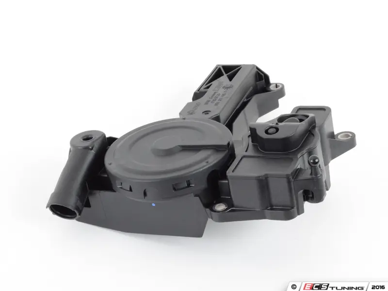

    Audi Genuine or Hengst OEM is highly recommended for the PCV because the Amazon versions just don't hold up. The Hengst OEM is quite a savings over Genuine (approx $100 vs $210). Now we get into a bit of confusion. The 2011 originally came with a black top PCV. If the car went through a phase 1 oil consumption service the black top was replaced with a white (opaque) top.
    If you can take a pic of what's in there now we can help you find the right part number. Include a legible shot of the part number on top of the current unit. The part number will begin with 06H103495 with the addition of one or two letters at the end. The original(s) that came on the car (or installed for the oil consumption update) have been updated and superseded by revised part numbers with different letters at the end, and that's what usually catches most cats ordering the wrong part number.
    Black top vs white top:

    Here's the PCV valve.
    06H103495AK should work?
    Dec 28 2006
    14483
    '13 A5, '24 Tiguan SEL R-Line
    Western Maryland
    Correct.
