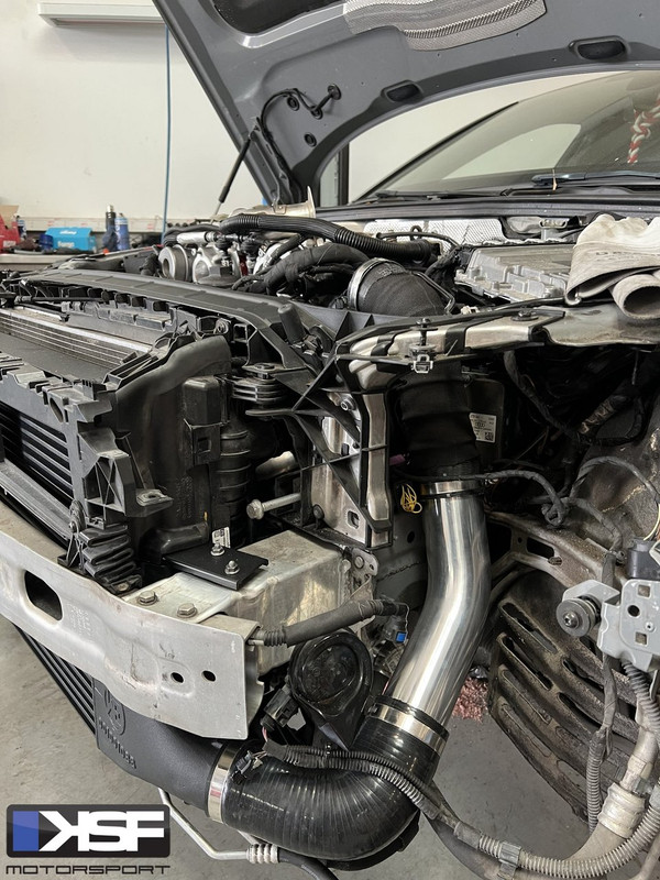

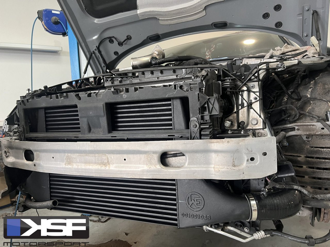

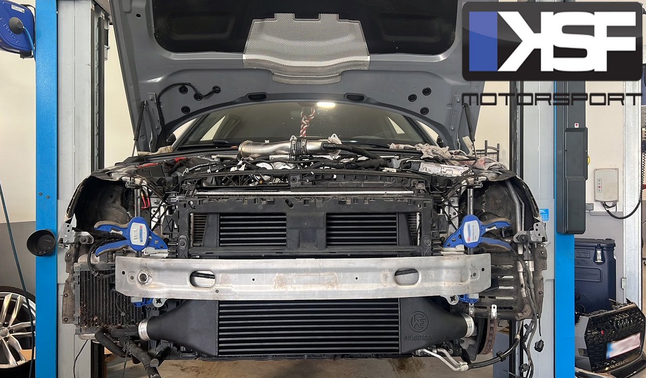

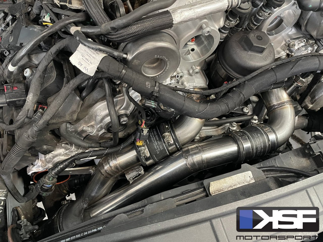

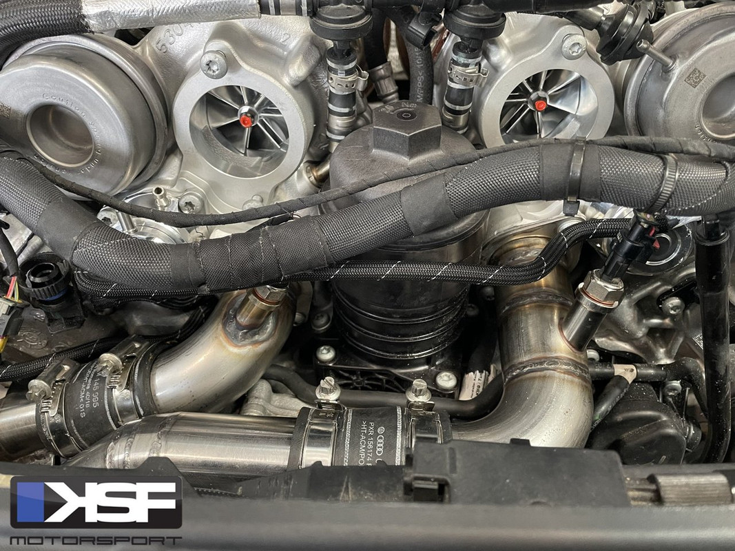

    Spotted this interesting build on FB, a french RS4 with a wagner FMIC likely from a S4.
    Could be a great alternative to the air to water system, maybe someone could make a kit with the y charge pipe from the turbos.
