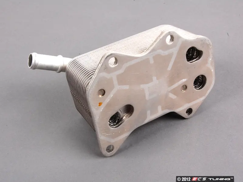

    That hose moves coolant, not oil. The oil moves between the flat back side of the oil cooler and the oil filter housing.
    Back side of oil cooler. Oil flows through the BOTTOM 2 holes in this photo:
    The upper hole and the hose connection are where the coolant flows.

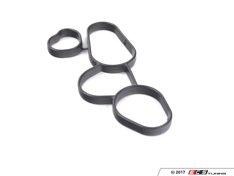

    This is the gasket that seals this back side:

    - You can see the OIL COOLER TO OIL FILTER HOUSING gasket at 7:05.
    - You can see the OIL FILTER HOUSING TO BLOCK gasket at 1:46.
