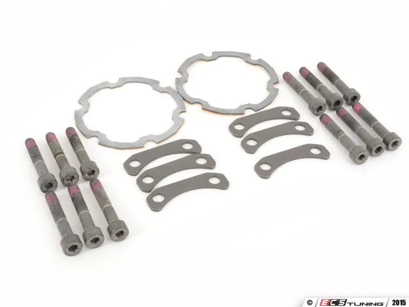

    The 'half moon' washer may also be called (ECS lingo): drive shaft backing plate./ they only offer the hole kits ($100+!)
    https://c1552172.ssl.cf0.rackcdn.com/737531_x800.webp

    ECS shows 803407357 as teh half moon washer and fitting EVERYTHING from B5 1.8T to RS6. Strange. I have 2 different sizes in my 'parts bucket'. So wonder is AUTO 1.8T is the difference, but all manual use the same?
