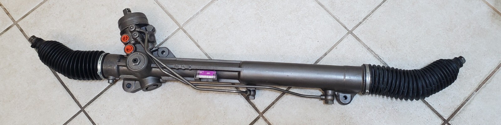

    I put it on auction for staring price of 600, plus shipping.
    It is fully rebuilt with warranty
    Item: 144224343549
    Audi RS6 4B C5 4.2 V8 Original Steering Servo Steering 4B7422065C
    • Lenkgetriebe
    • Servo-Lenkung
    • 4B7422065C
    • komplett wie abgebildet
    • geprüftes Originalteil, technisch Einwandfrei
    Came from this RS6:
    • zugehöriges Fahrzeug:
    • Audi RS6 4B V8 4.2 BiTurbo
    • 331KW / 450PS
    • Bj: 2001
    • MKB: BCY // GKB: GAG
    • Ebonyschwarz / LZ9W

    I looked at my original rack, and it has an electrical connection. Not sure what that connection is for, but that stopped them with proceeding further. Rebuilt RS6 rack is in perfect condition, but I am not 100% sure anymore it is a good fit for Allroad, because of that electrical connector.
    Mar 07 2022
    679445
    Kelowna, B.C., Canada
    Quote Originally Posted by V1nny View Post
    The electric connector is for 'servotronic' which increases the power assist at low speeds (like to make maneuvering in a parking lot easier). It won't cause any problems to remove the servotronic system, but depending on your preferences, you may like the extra low speed assist vs the quicker ratio of the RS6 rack. I don't know how heavy the RS6 steering is as I haven't installed an RS6 rack (yet).
    Veteran Member Four Rings V1nny's Avatar
    Dec 04 2012
    105252
    Arlington VA
    Thank you for confirming. That was my suspicion. When I got my allroad years ago, my first modification was to pull servotronic relay to get rid of grnadma cadillac light steering.
