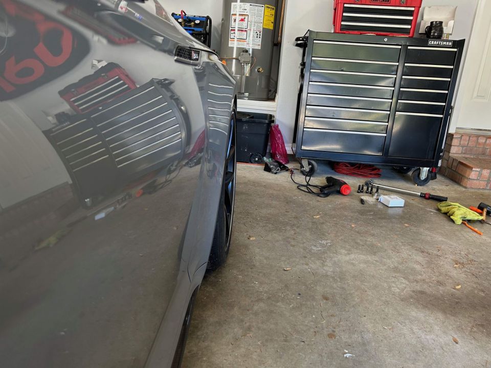

    I bought my Vossens/tires/sensors/locks/lug bolts from Mops. Great to work with. I’ve got the size set up you’re looking at (Michelin summers) but my car is at stock height so I’m not much help. Absolutely no rubbing. Wheel et20.

    And yeah, ET20 on 285 is the balance of most flush with no rubbing.

    Of course I’m biased since I’m running 20x10’s with 285’s but I think the set-up looks spot on. Tires aren’t stretched or anything. In fact, a buddy stopped by the other day and was specifically looking at the wheels and tires. He said it looked perfect to him as far as fitment and flush. I personally wouldn’t want to go any wider but that’s just me (and I like really wide tires coming from a lifted 4x4, lol).
