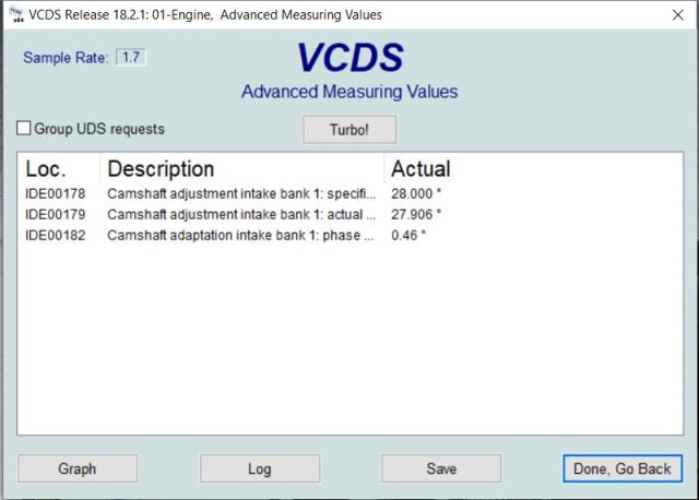

    Have one with a 4096 (Cam/crank correlation) but this number is always negative when it's chain time.. I've never seen one go positive. Am I missing something? I suspect someone installed a timing set off 1 tooth.
    The other 4 faults are misfires

    Yeah, off a tooth maybe. I forget what was worked out some really long time ago, likely buried in that timing chain thread. Maybe 15° per tooth?

    7.82 degrees per tooth (360 / 46 teeth)
    I would pay close attention to the reverse threaded VVT solenoid or the phaser itself (lock pin spring possibly came off etc)

    Yeah I agree I’ve never seen an advanced cam/crank correlation.. it’s typically retarded (negative value) that would see to be VVT valve or the magnetic solenoid? Or the top chain guide is broken/missing, I’ve seen that before causing a positive value.. it does sound like a tooth has jumped.. you should park it and open up the upper case and look, not sure if you’re ready for the entire timing upgrade yet but first you should verify the intake phazer and pull the cam bridge set it to TDC and take measurements..

    Sounds like you know where you're headed now. But mine is positive...or at least it was when I did my timing chain about 90,000 miles ago. Not nearly as positive as that one. You would think I did something wrong, but that was 90K miles ago with no problems. I looked at the cam adaptation just a few weeks ago. Can't remember the number but it was negative now, but no where near the - 7˚ to -8˚ you would expect with a 90K mile chain. But it stayed positive for at least 20-30K miles.

    This is a situation where the " interview" is extremely valuable...
    did the customer do any previous work? history of the car ? did it come from another shop ? when did the reported problem start ? etc.
    If it just a regular dude driving his car and never had chain work done, and all of a sudden came up, its unlikely that it is off a tooth or anything like that.
    if its advancing on its own as stated it could be the 4/3 valve in the end of the cam stuck open , but usually when you see that the end pops out, is very obvious and it goes 20 -30 degree.. that look more like the retard locking pin is not engaging in the cam phaser. Could be the pin in the N205 solenoid jambing too i guess.

    The pin hole was hogged out, thats why so much jiggle, but every part of the phaser was just worn, scoring, the veins cut little cups in the corner of the housing, etc. Runs like a top now.
