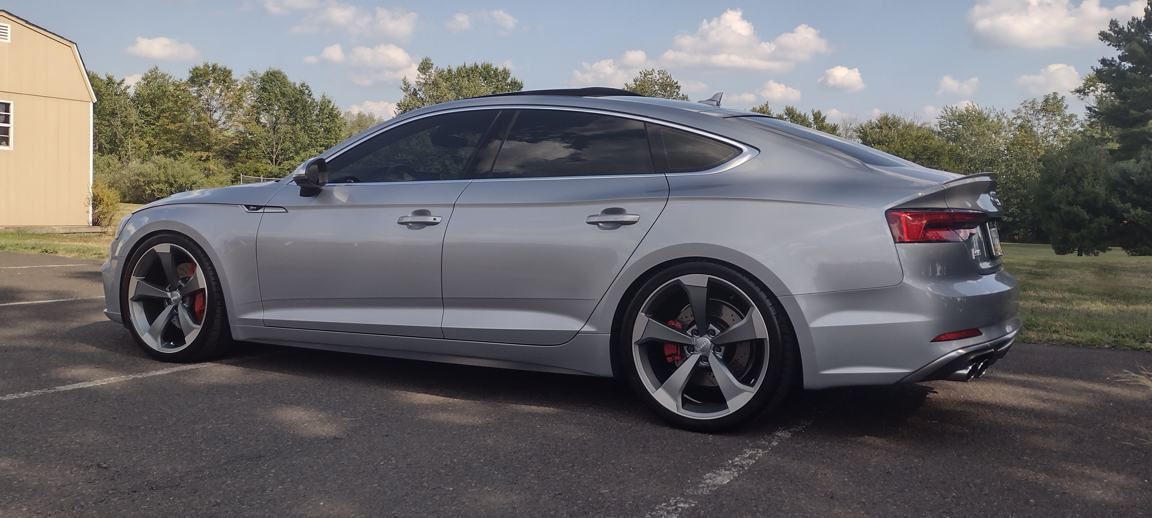

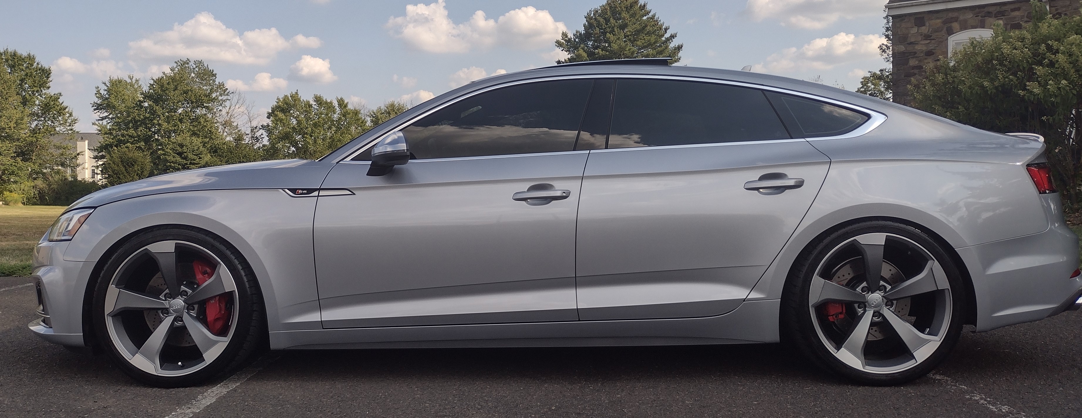

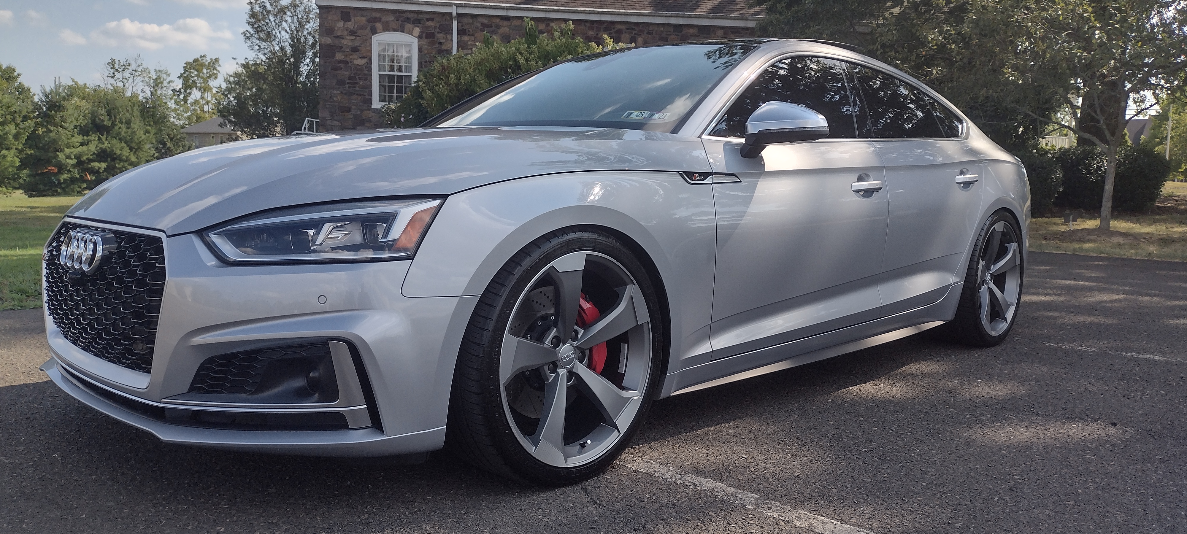

    Car pics :-)

    Badass Audi right there
