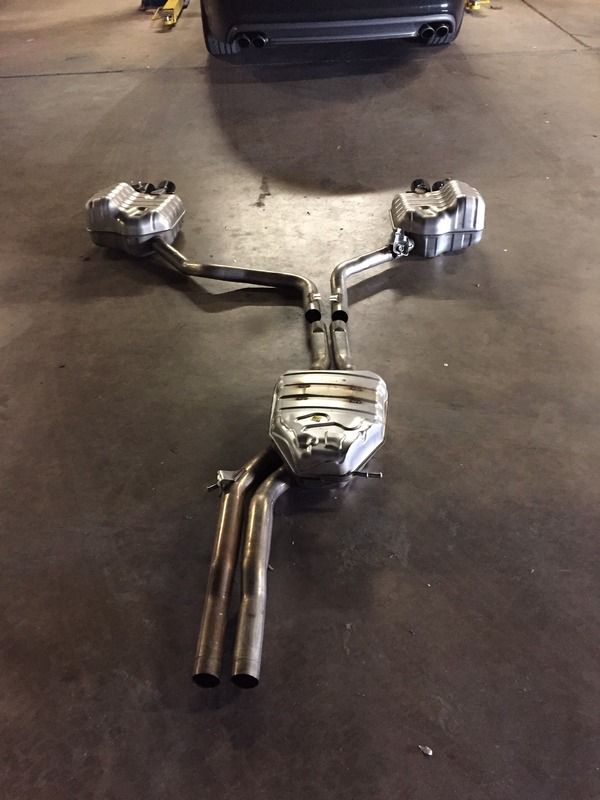

    Dec 07 2022
    856814
    Houston Texas
    Quote Originally Posted by widebodyfx View Post
    We had an owner that showed the shorter path on the driver side muffler of the sport exhaust, C7.5 the driver side valve was moved to before the driver side muffler so when closed that exhaust path is no longer available and gases go out the passenger side. With all that said, I think the C7.5 can do burbles easier than the C7 and with the sport muffler it is more growl. https://www.audizine.com/forum/showt...r+side+muffler
    I removed all the parts in this picture lol and she sounds like a beast.
