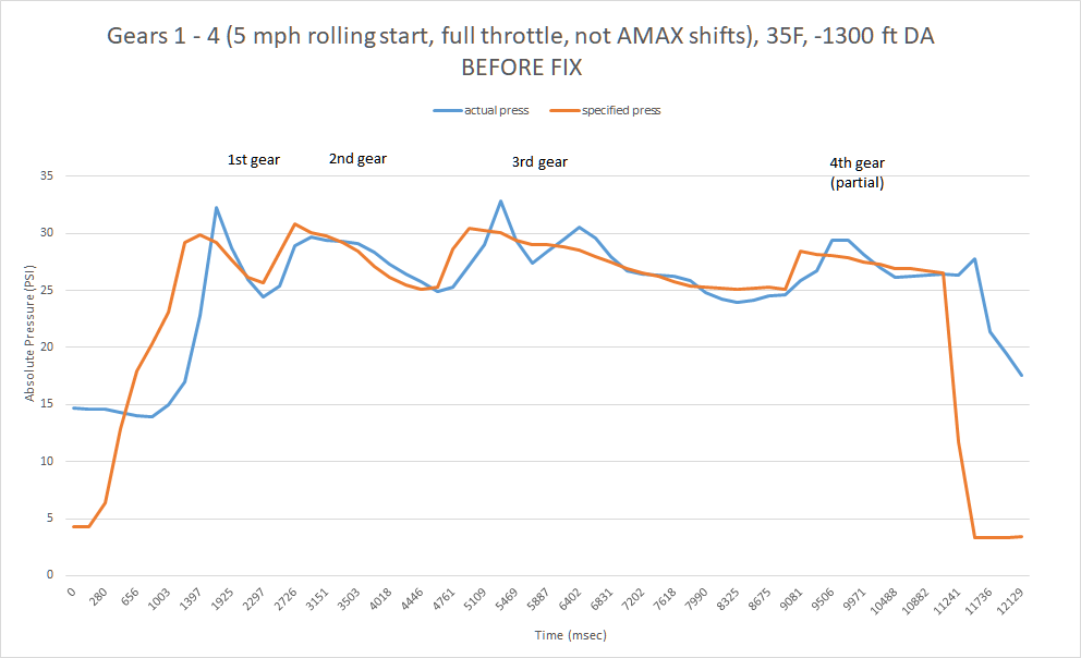

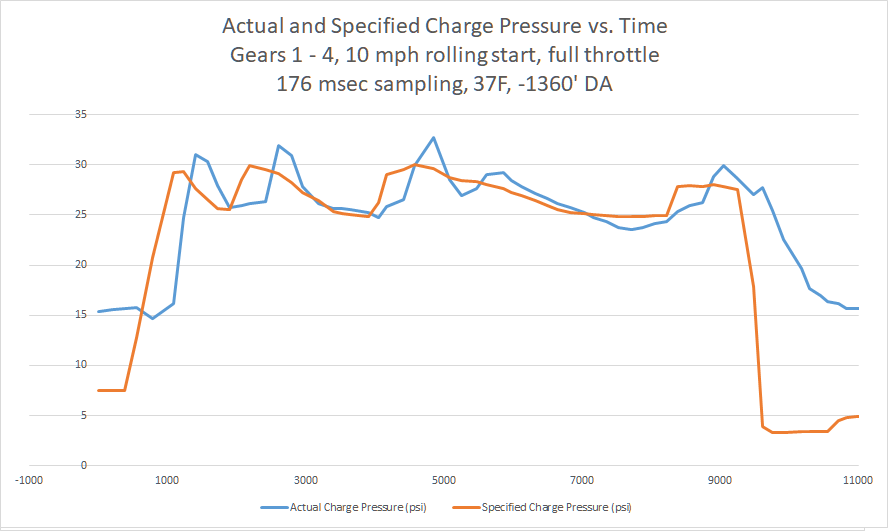

    Was able to take boost data with and OBD Eleven (what a POS - a lot doesn't work with iOS just FYI). Here's a full throttle pull through thru gears 1-3 and partially thru gear 4. Rolling start in 1st gear (i.e., not AMAX shifts).
    No boost leak as far as I understand. However, it seems odd to me that boost decreases noticeably with RPM. These results were extremely repeatable. Again, new to turbos, but my understanding was boost does not decrease with RPM but here it's reliable falling off ~15-20% by the end of the gear, both specified and actual.

    And there's a long pull in 4th gear showing the same phenomenon:

    Boost drop off is normal as RPM increases. Can you add more parameters to your logs? It looks like you are overboosting which can cause throttle closure. See if you can add throttle position to your log.
    If you can get throttle position in there, take another log in stock tune to see if there are still issues.

    Quote Originally Posted by NRigs View Post
    This. Look at the 3rd gear pull in the above. You can see the overboost and subsequent drop then it picks back up again. I’d bet you’re getting throttle closures and/or timing pull. This is a tune issue.

    The issue with the intercooler (beyond bad brackets and poor directions) is the MAP sensor housing was wrong (design or manufacturing I'm not sure) - there was no lead-in for the o-ring MAP sensor o-ring, and when I first called both the tuner and APR about the issue they both said the MAP sensor should fit just fine. Well, it didn't and I ended up ruining the original MAP sensor (or, specifically, the o-ring, which is not available separately), as forcing the sensor into the housing sheared off the outside of the o-ring. Not wanting to spend another $150 I bought a bunch of nominally identical o-rings off of Amazon. None were the exact size of the factory o-ring, and the the best of the lot wasn't as tight as the original o-ring, so today I fixed this as well. I bit the bullet, bought another MAP sensor and chucked the APR MAP sensor housing up beveled the edge to match the bevel of the factory MAP sensor housing. All fits super tight with the factory MAP sensor o-ring.
    Anyway, both issues seem like good candidates for a boost leak and both are now fixed. My luck on these things is hit and miss, but we'll see!

    Here's the charts for after the fix:
    Notable notes vs. original charts:
    1.) No more actual pressure overshoot in gears 1 and 3
    2.) Actual pressure reaches specified pressure in gears 1-3
    3.) Gear 3 is hugely improved - esp no more see saw in actual pressure
    4.) 4th gear is unchanged on both charts (which is puzzling, if indeed there was a boost leak)
    5.) For the first chart, my hunch is ignore the start of first gear, as I probably did not have the same rolling start speed
    6.) I charted absolute throttle position, but the max it ever showed was 88.5%. There were so many different throttle elements I had not idea which one to choose. I didn't chart it but it was 88.5% for both "after fix" charts (i.e., I didn't see any manipulation)
    7.) Ditto for timing, plus what I charted doesn't make sense to me
    So, all in all, better, but not sure this fully explains the loss in performance. Thoughts anyone? My local tuner does not offer boost leak testing, so it'll be some work for me to do that but don't know if the "after fix" charts are showing a boost leak. It's a bit snowy here so it'll be some time before I can do any acceleration runs.

    New charts. Had to redo the "after fix" charts because I didn't cotton to the fact that the more items OBD Eleven charts the longer the interval, which means missing data, and fairly useless charts, which is why my previous "after fix" graph was curiously drama free and gave a false positive. Made new charts only ever charting two items.
    Have included the "before fix" chart as the first, updated a bit.
    In summary, the first two charts are virtually identical, which to means there was never any boost leak. 3rd gear looks a bit seesaw-ish in the first half of the gear, but nothing else looks weird AFAIK in any of the other graphs. Open to interpretations. Timing advance and AFR seems about right to me, or in the least I don't see any weirdness that would be an indication of a problem.
    To me it looks like the vehicle is doing what it's being told to do. No Dragy results yet because the roads are wet (the launches in the last two charts had a quite a bit of spin so first gear looks weird). Supposed to be dry tomorrow evening, so maybe then.

    Just finished boost leak testing per recommendation of both the tuner and APR. Oh, boy, was it an adventure - spent an ENTIRE day, at least $300 and a borrowed car to make an emergency trip to the auto parts store. Got 'er done though. I'm quite proud actually (the turbo inlet needed significant work!). Anyway, results:
    Testing only from the turbo inlet to just before the throttle body, I pressured to 30 psi, and tested all connections with soapy water. Zero bubbles at all connections. I did this test many times - at least 5.
    Testing the entire system (turbo inlet thru throttle body, blocking off the PVC return into the turbo inlet), and again zero bubbles on any of the intake charge pipes downstream of the throttle body. For this larger volume, my compressor could only manage 28 psi, and the leak down to 20 psi was ~10 seconds, and then slower below 20 psi.
    My research both indicate no boost leak. Thoughts?

    Well, you still haven’t provided any throttle position information, so tough to say. You are definitely seeing a timing drop in 3rd gear where your boost over/under shoots are occurring. I stand by my original analysis from post 13, but it seems like you really want this to be a hardware issue..

    Thanks for the input.
    I did chart that but didn't show the chart - per #18 "throttle valve position (absolute)" - consistent at 88% across any full throttle acceleration (didn't post the chart because it was boring TBH). Of note OBDeleven is abysmal at charting this value - 900 msec between samples, so it'll miss quicker adjustments, if such a thing is happening.
    Now that I've done all this testing, at full throttle shifts (not AMAX) there is a hint of a delay. I can't see in the charts though.
    It's not so much what I want. Of all the possible problems, that APR done goofed on a tune on a car they've been tuning for 5+ years is the least likely of any of the possible scenarios as I see it. If I have to go back to them with such an allegation, I need advice/data/etc., like I'm getting here. Any test I've run so far shows NPF with either the vehicle or my test methods. I charted IAT but AFAIK this shows NPF either:

    Hmm. Just charted this from today's testing. I'm new to turbos, but know engines quite well. Pulling timing at each shift is wack, and explains the periodic hesitation in shifting I experience. This the smoking gun to go back to APR with? I think so. Something major is causing this.
    And here's the boost test from today as well. Plainly, something does not look right in the delay and overshoot - and it seems to have gotten worse. Is the timing cut causing the boost delay and overshoot, or the other way around? To me it seems like the former. But what would cause that?

    Dropping timing at each shift is a fairly typical strategy to reduce transmission NVH. What’s more concerning is that timing picks back up after the shift then drops again. This is unusual and could indicate timing pull due to either knock detection or that overboost or both.
    I’m not saying that APR suddenly goofed on your specific tune, but more likely just isn’t as refined as they claim to be. Perhaps especially when used with your specific fuel. You’re not in Arizona/Nevada/Cali by chance?
