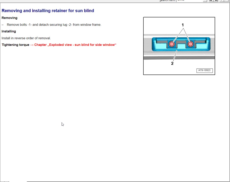

    I'm in the middle of trying to source the remaining parts for my factory rear door sunshade install and have hit a bit of a road block. In an effort to do this to factory spec I have sourced the appropriate rear door cards with the integrated sunshades, as well as the hooks and upper door trims that have the hole to accept the hooks that the sunshades rest in. Unfortunately, when looking at the Audi parts catalog/ETKA it's not showing me any additional hardware to secure those hooks. If you look carefully at the photos below you'll see it appears like a set screw may need to go into the actual door frame. Was hoping to not have to drill anything if possible, but if someone with this factory Prestige option can snap a photo of what is securing this hook or if anyone has insight on a part number for those screws or clips that would be greatly appreciated! This is the last thing I need before I can get these installed correctly. Thanks for the help!

    Maybe this will help you

    Thanks, that is helpful. I wish there was a way to figure out the part number used. It's weird as the A4/S4 uses essentially the same mechanism and doesn't show this screw either. Looking at Q7 and A6 models of similar years they all appear to use N-106-567-02 while the B9 Q5/SQ5 uses N-104-159-03, but it would be great to confirm this is the correct length before ordering.

    Extremely helpful, thank you! I will order up these screws and hopefully the Q5 has the holes already drilled in the door frame like the A4 does.
