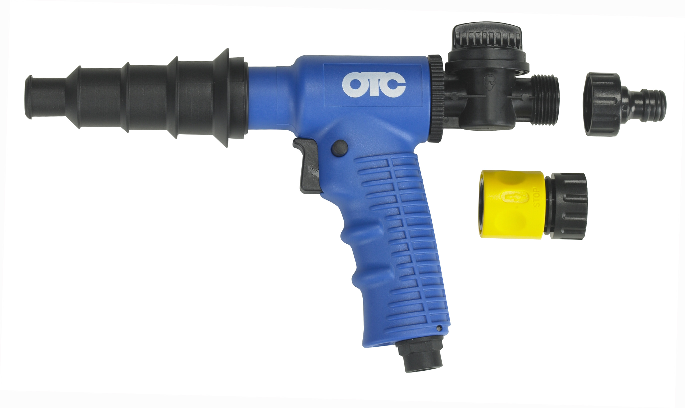

    I'll add a suggestion for a nifty tool called the "Blast-Vac":
    It runs about $60-$80. Connects to an air compressor (~70-100 psi) and your garden hose. You control the water flow with an adjustable dial and you have a trigger to release the kracken, I mean the air pressure. From the website: It "creates a unique vortex air/water blast for powerful cleaning applications."
    You know how you turn on the garden hose to wash your car and the hose still has air pockets in it so it does this aggressive air/water blasting thing until the line clears? That's exactly what this tool does, but does it on-demand. You can get some very aggressive water blasting effects going on. We flushed out an engine block and hit the ceiling once.
    Anyway, I used this to get heat back on my winter B5 the other day. Here it is hooked up:
    This is what came out. Brace yourself:
    Actual poop. That's what came out.
    Yes, I did accidently spray myself in the face with this substance. I will never recover.

    I would not be putting 70-100psi through the heater core as the system is not designed for that amount of pressure. Your just asking for a problem.

    It's metered through an orifice within the gun to create the proper vortex cleaning effect. It is quite literally made for flushing heater cores and radiators and such.
    From the website:
    Perfectly suited for quick and efficient cooling system flushing. Simply attach it to radiator or heater hoses and you're in business.
    Does a really fantastic job. Pressure does not really build within the core as long as the other end is open. It's more about getting the water "upset" as it goes through core to loosen the things.
    Here's a video by South Main Auto using the OTC Blast-Vac. He explains how to "go easy" with the tool especially if the core is very plugged up. Unfortunately he does not catch the junk coming out of the core, which is always the most fun part! :
