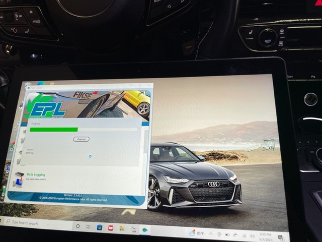

    I can't seem to return mine to stock. I've tried at least 3 times. Had to bring the car in to get a recall completed and they said they couldn't download the file as there was something blocking them. I wouldn't care normally but the recall has to be done in order to purchase the car off lease.
    I brought my laptop to the dealer and it just keeps checking ECU.... With no progress.
    Anyone have any ideas? Wifi connection is strong so that's not it.
    Thanks
    Sent from my SM-S906U using Audizine Forum mobile app

    Almost had it. Was checking DTC's then failed. Another attempt and it says check memory failed.

    Well I can connect at all to the ECU and the car won't start. Looks like the ECU could be bricked. Any ideas?

    Quote Originally Posted by Boss240 View Post
    Oh crap - doesn’t sound good. Hopefully you get a response from Tony. Otherwise, your next best step may be switching to 034 and hoping they can unbrick (may require to send it to them?).

    I was trying to switch over to 034 but wanted to return it to stock first before switching. Wasn't able to do it so I've just been driving as is till I figured something out.
    Once the lease was ending I started the buying process and was told in order to purchase they needed to perform some airbag recall that had to be done in order to purchase.
    They couldn't perform it as something was off with the ECU and they could connect properly.
    I just somehow and still don't know why it worked this time but was able to return to stock. Shit I hope that worked as I was not looking forward to jumping through hoops to figure this out. A new ECU would have to be special ordered from Germany and there's no ETA if it was ordered.

    If Tony is still managing his emails etc he is able to unbrick your ECU remotely - At one point he was the only one that could as 034 had to either send out a special dongle or have you send your ECU in or something of that nature but they might have it worked out remotely by now as well. Either 034/IE should be able to help you return the ECU to stock by this point imo if Tony has finally disappeared into the woods.
    My cable connected fine to the ECU/Tuner but they intentionally cleared my "Account Credits" out so I couldn't even remap to stock let alone any tunes. I remapped with IE

    Was able to finally get it back to stock but Audi can't connect to the ECU still to perform the recall so 8m not sure what's wrong at this point

    Im selling my car, so I need to flash back to stock also but I’m scared something might go wrong. I don’t have a warranty, can I just ask audi to re-flash my engine ecu back to stock? Can audi do it or it needs to be done with Epl hardware?
