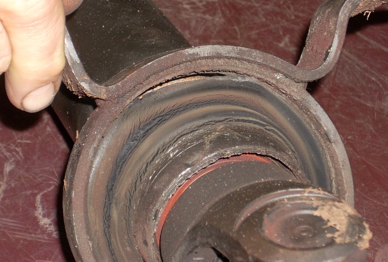

    So you could turn off the motor at 40mph and you'd have that noise?
    I'm betting center bearing on the drive shaft. They can be hard to see when they're installed. I had to remove the shaft from my old B5.5 to see what was going on here.

    Quote Originally Posted by bluecan View Post
    Do you know there is anyway I can test that center bearing? Thanks.
    I you pull off the heat shield and exhaust so you get to it, you can put a bright light behind it while you grab the shaft and flex it around. If its torn like the one above...or even just really thin in spots, you should see light coming through the rubber.

    Quote Originally Posted by mtroxel View Post

    Had the car on jack stand today. It appear the noise is not from the central bearing. The shaft feels pretty solid offline. https://youtube.com/shorts/oaimDSrHe0o?feature=share
