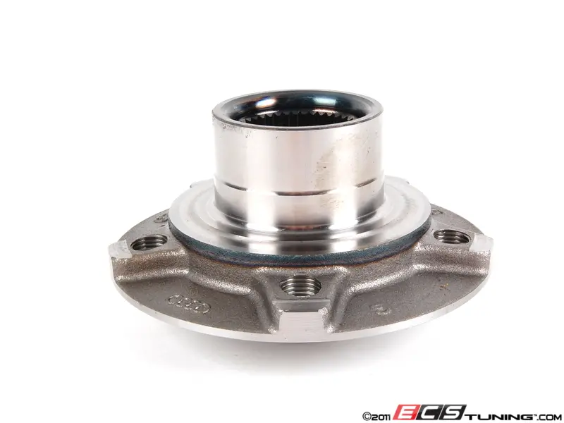

    You should check to see if the hat offsets are the same. I thought at one time someone suggested having to swap hubs.
    Jul 16 2018
    422473
    Atlanta
    Ah, I think B18b1ex found the crux.
    So all B8 and C7 use the same wheel bearing on all four corners, 4H0 498 625 A.
    And all B8 and C7 use the same wheel hub on all four corners, 8K0 407 613 B - https://www.shopdap.com/8k0-407-613-b.html
    EXCEPT for the rear on the RS models (RS5, RS7 in US), which use 8K0 407 613 D - https://www.ecstuning.com/b-genuine-...ch/8k0407613d/
    (the combined 4H0 498 625 A + 8K0 407 613 B is 8K0 407 607)
    So what's with the B hub vs D hub? Notice what appears to be extra thickness in the hub:
    B: D:
    Here we see the B hub mounted in the bearing:
    Here we see the D hub mounted in the bearing:
    Notice the extra thickness between the edge of the bearing and the lug bolt protrusions.
    If we look at a third-party with rotors for both the A/S and the RS, we see:
    A/S: RS:
    So the RS 300x22 is 5mm taller than the A/S 300x22. That would allow it to sit on the D hub with it's extra protrusion but get the rotor friction wheel back to where the caliper is. Since the A/S and the RS use the same wheel bearing housing, same caliper carrier, same caliper, and same pads.
    We get an excellent diagram from Brembo regarding the A/S 300x22: https://www.bremboparts.com/america/...isc/09-B969-11
    But they don't make a rotor to RS specs so no nicely specific diagram of the rotor physicals that I can find.
    It would seem then that the A/S 300x22 is used with the B hub, but the RS 300x22 must be used with the D hub.
    2009 A4 Avant 2.0T quattro Prestige, 275k miles

    smac770, this is great information. Appreciate you doing the leg work. I reviewed all the caliper/carrier part numbers between the two, but never thought to check the hub.

    I suppose 5mm spacers between the hub and rotor would work.

    Just replying here to confirm that RS5 rear hub outter(spindle?) are unique to the RS5 and stick out an extra 4mm or so. The wheel bearings and wheel besrign carrier/assembly are the same front to rear, but the damn rear spindle is RS5 specific. Typing this as my rs5 is sitting on a lift after buying the wrong spindle… oem units back ordered. Was lucky to buy a used on on eBay 30 miles from me…
    Don’t do this.

    I went down this rabbit hole while looking into the RS5 BBK and it looks like the rear RS5 calipers are the same as what the S4/S5 has with the exception of the "RS" plate.
    So that means there is no added benefit of running the RS5 rear caliper unless you want/have a set with the "RS" plate.
    For rear rotor upgrades you can go OE S4/S5 which there are many options or even RS4 with no other mods from what I found.
    If you want to run the rear RS5 rotor you will need the rear spindle/hub to do it the right way which will widen the track of the car.
