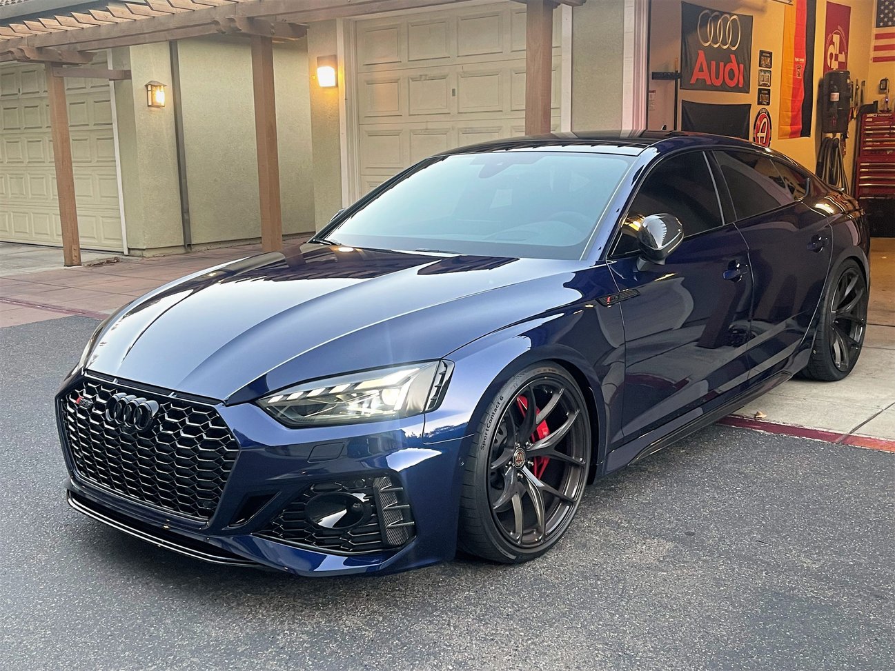

    Well folks, dialed in the ride height and the alignment. Car is aligned at new ride height/stance - Also, fresh maintenance wash for the Xpel Ultimate PPF topped with 2x coats of Gtechniq Halo
    Car continues to get better - Just surpassed 900 miles on the ODO!! I have a 5054A tool in route and have been in contact with "Canadian Sam" - More juicy updates to come.

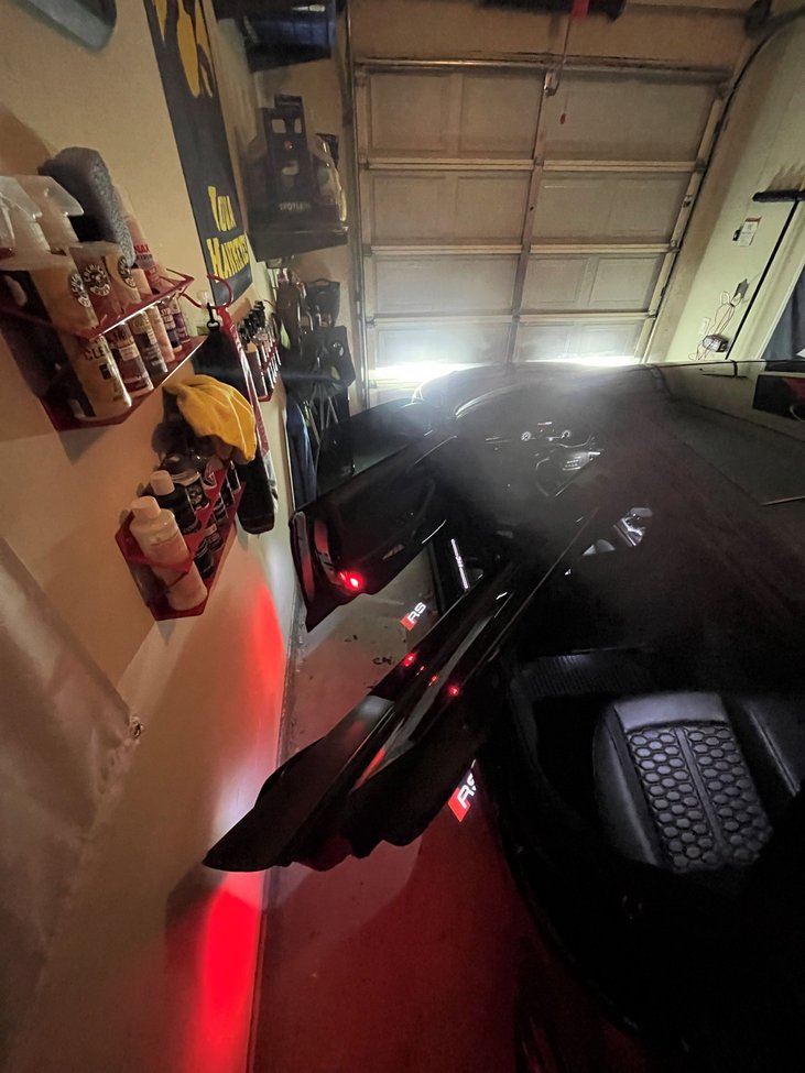

    I had a few things enabled:
    Acceleration timers
    Blue hue for laser light - Apparently the US has a white laser, the only coding for RoW is a color hue change (cannot confirm this)
    Matrix functionality enabled
    Orange stand-lights in headlights "turned off"
    Animation of unlock "light show" and illumination of the blue light
    Unfortunately, I don't have video of the lights in action on the road at night. I did learn that matrix also functions/relies on GPS information (it doesn't work unless you're going over 30mph and in an area where use of matrix functionality provides benefit). I can report that the performance increase is VERY obvious over the standard auto-high beams. It's pretty trippy watching the individual sections of the lights turn on and off the first time you see it in person.
    Overall, worth it if you've got some cash burning a hole in your pocket, and/or out of other mods to do (or both).

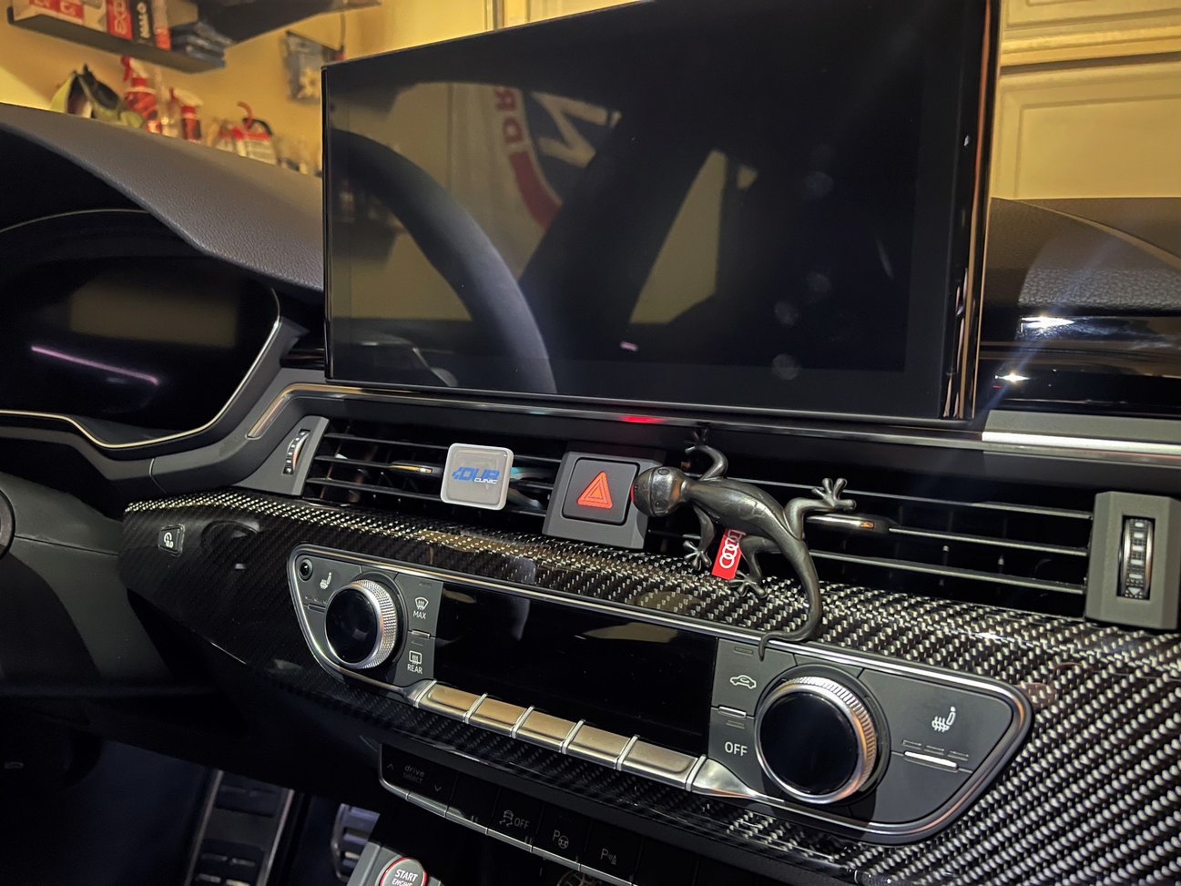

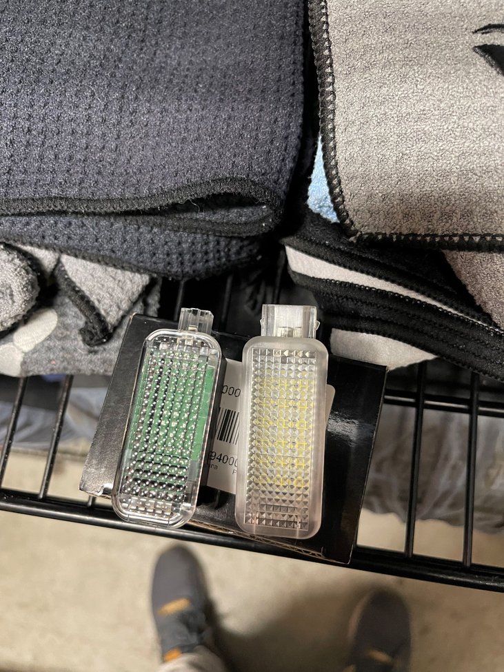

    Another small update - While unimportant and/or unnoticed to most owners, the center console wear patterns have really been bothering me (B9.5). Not necessarily a design flaw per se, but definitely, "not how I woulda drew it up."
    For those that have had several Audis (or maybe an observant first-time owner), you all know that Audi might use the softest Piano Black paint in the universe - Application of this finish in high-traffic/high-touch/high-use areas such as the center console really bothers the OCD in me (B/C pillars are another peeve/cause of irritation).

    Took some photos after a carwash a few weeks ago - Been travelling alot for work and haven't been really paying attention to much.
    I think the rear coils have been settling a skosh - Thinking I need to pick the rears up 1/4" or so. Will keep an eye on it.

    In the interim, I figured I'd add the AudiGecko air freshener - Makes a good conversation piece for those who don't know Audi or the 25th anniversary cars.

    Tis the season for lights!!! I purchased a variety of LED and halogen style clear housings, red housings, and wiring harnesses. Figured I'd address a few issues that probably aren't even considered a "thing" by most folks.
    First thing that needs addressed - The halogen lamp in the glovebox.
    I tested out a variety of 194/501 spade type LEDs to see which lighting array I liked the best.
    I ended up deciding that I liked the multi-LED PCB array the best - Installed an adapter to connect to the OEM pigtail (no cutting)
    Final product - Plenty of light without being offensive - Won't need to go rifling through here hunting for insurance/tags in a dimly lit environment ever again

    In process picture - I didn't completely remove the door panels. I just popped the CF trim, removed the 3 T25 screws, then popped out the bottom of the panel until I had enough room to run the wires (this saved alot of time).
    Some pretty cruddy "after" pictures. I need to get a new Iphone (I'm still on the 12PM and one of the camera lens are scratched)
