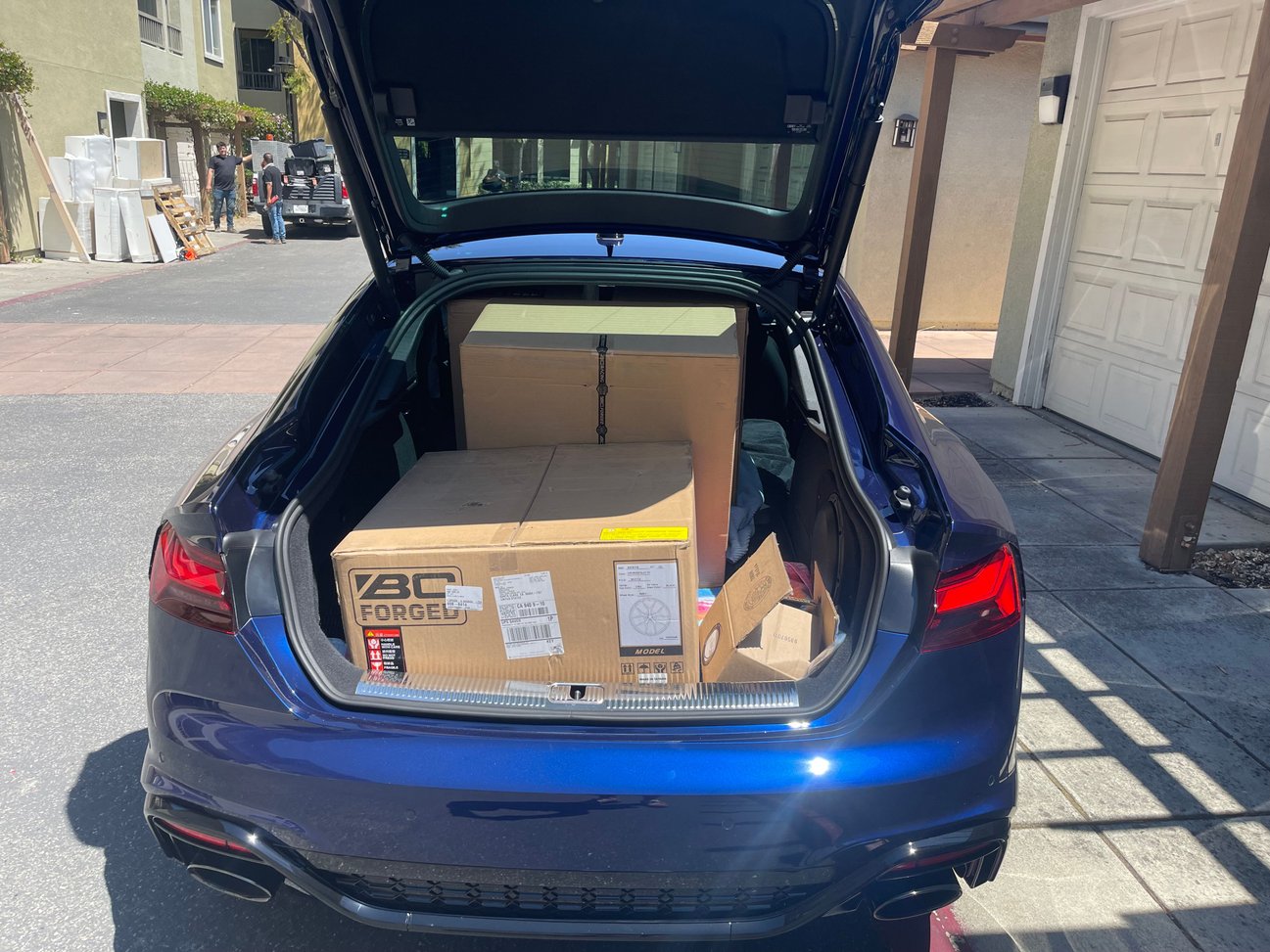

    Wheels are here! Thank you Ben (mops@nemesisautosport)!
    I cleaned/coated them. Process:
    Prepped with Gyeon Q2m or Gtechniq Panel Wipe (I'm trying to debate which one I like better)
    Barrels and faces first coat with Gtechniq CSL - Allowed to cure for ~24 hours before second coats
    Barrels second coat with Gtechniq C5 - I do this because the finish properties of C5 sheet water, not repel - I figured this would be better to retain wheel weights (I'd prefer they don't "dance around" and/or fly off)
    Faces second coat with Gtechniq EXOv4 - Finish properties of this are hydrophobic (they repel water) - Figured this would keep it easier to do a waterless wash if I wanted
    Waiting for them to cure for ~24 hours before putting them back in the boxes to take to installer - While curing, I covered the wheels with the cheesecloth/thin covers from BC forged to keep dust away.

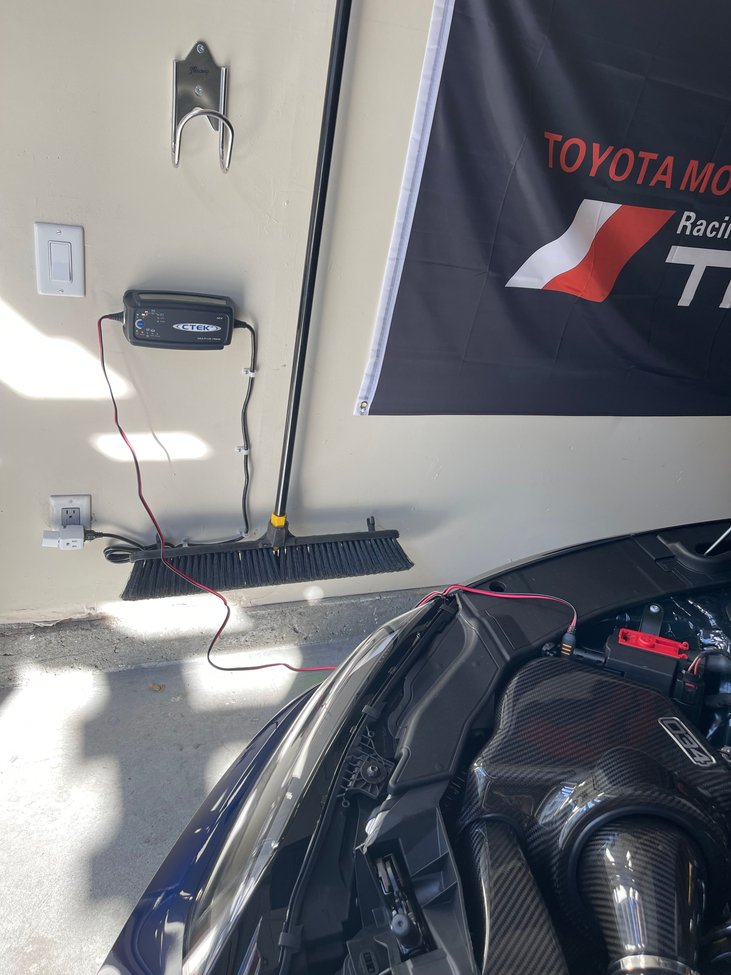

    I figured I'd give it one more update for the night before my work/life balance goes to hell for the week tomorrow morning
    Well folks - Some less interesting stuff.
    Since I only drive this car maybe once/twice a week and for short distances, I have it on a battery maintainer/charger.
    CTEK Multi US 7002
    https://redirect.viglink.com/?format...ums&txt=Amazon
    Wall mounted with optional rubber insulater on the off-chance I "whack it" with something
    I have the extension cable, too - But, not using it while I'm "backed in to the garage."
    I have the vehicle connections hardwired to the "jumper locations" under hood (hoops under the factory retainers, ran to the CTEK quick connect - CTEK connections are weather/waterproof)
    Wall mounted 7002 - Not sure how you folks feel about it - But, I've had great success with similar setups in the past. It's great to "set it and forget it."
    Hood down - Only thing that isn't great is the alarm doesn't activate while the hood is slightly up - Oh well, we have security systems.
    Stay tuned - I have more parts/updates - ZTF had to delay some more intrusive suspension work due to a tech shortage (COVID related call-offs) - Parts are here, just waiting to show what we're working on until we get closer to install.

    Getting the car all loaded up to go to ZTF/034.
    We will be installing these - ABT HAS - Thank you Ben (Mops@Nemesis)!!!
    Pretty neat that these are TuV approved to a certain ride-height. TuV Nord, too (where I lived for 2+ years).
    From what I can tell with a full tank of fuel, the front end of the car sits at 27 1/4" FTG with ~700 miles on stock tires. Rear sits lower @ 27 1/8" from factory. I can confirm it not only appears to have a reverse rate, it mechanically does.
    After the ABT HAS kit is installed, we're gonna set the initial ride-height at 26 1/4 FTG" on the front and 26 3/8" FTG in the rear (with a ~3/4 tank of fuel). Ben (Mops@Nemesisautosport) recommended I put at least 500 miles on the car before it goes back in for alignment. At that point, we'll figure out where I want it to sit for the longer term (I'd imagine it'll settle at least an 1/8" all around in those first 500 miles).
    Included in the quote from ZTF/034 was the initial installation, initial ride height and alignment setting, and then an additional 4-wheel alignment after I put some miles on the car and the suspension settles.
    Once I get the car back tomorrow night at initial ride height and alignment, I'll be taking some measurements for spacers. I plan on working with Ben (Mops) on lining those up. The rear shouldn't need much as there is an eccentric bolt back there to get camber back after lowering. Front will likely need more (probably a 3mm or a 5mm, landing me at an ET20 or an ET18). This titanium stud kit from Nemesis allows me to run up to a 15MM without changing hardware. I plan to throw those on when I get the car back as well.
    Stay tuned. Gonna be a fun week!!!
