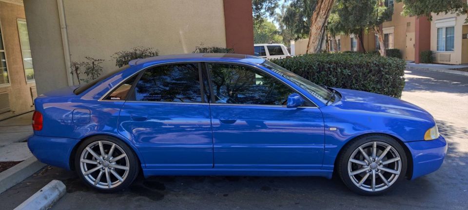

    Hello all,
    This thread is a view into the ownership of my Nogaro Blue 2001 B5 S4, from the perspective of an 18 year old. I bought this car out of California, and it arrived in Chicago on October 9th, 2021. While it did have a PPI and some maintenance before it was sent here, I did discover some issues and have had some problems in my first week of ownership. Any advice and wisdom would be greatly appreciated, and I would like this thread to be a reference for other teenagers/people who are considering getting one of their own.
    First I'll put what you probably clicked to see, a beautiful Nogaro Blue S4.
    That's how it sat in California, and how it looked when I found it on Craigslist.
    After much stress and hassle (thanks to my bank) I bought it and one week later it showed up.
    I soon found out the car was a bit of an expensive sh*tbox, more on that later.
