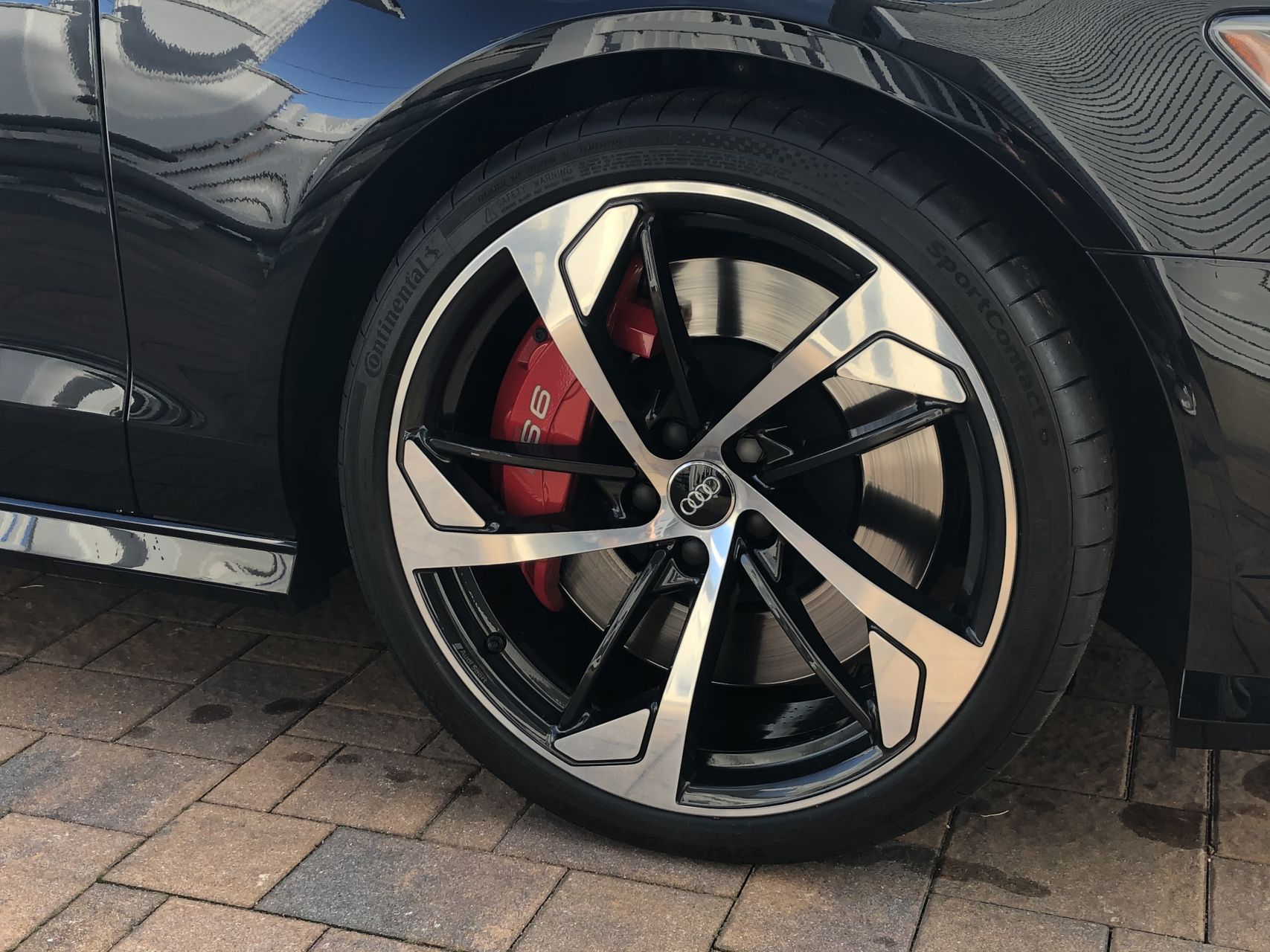

    the sq5 is the mrs daily. i may try these on it in the spring along with the spacers. will put 275/285 on it if i like the look
    5 double Y spoke pairs
    Order no. 4G8 601 025 BE Z33/AX1
    size 9J x 20H2 ET37
    Example tires 265/35R20
    Bolt circle: 5x112
    centering 66.5mm
    Model(s)
    Audi A7/S7 (4G) 2010-2017
    or maybe these. the lower offset will push them further outboard
    Audi aluminum rim 5-arm trapezoid design black high-sheen
    Order no. 8W0 601 025 CN UJ2/Z33
    size 9J x 20H2 ET26
    Example tires 275/30R20
    Bolt circle: 5x112
    centering 66.5mm
    payload 720 kg
