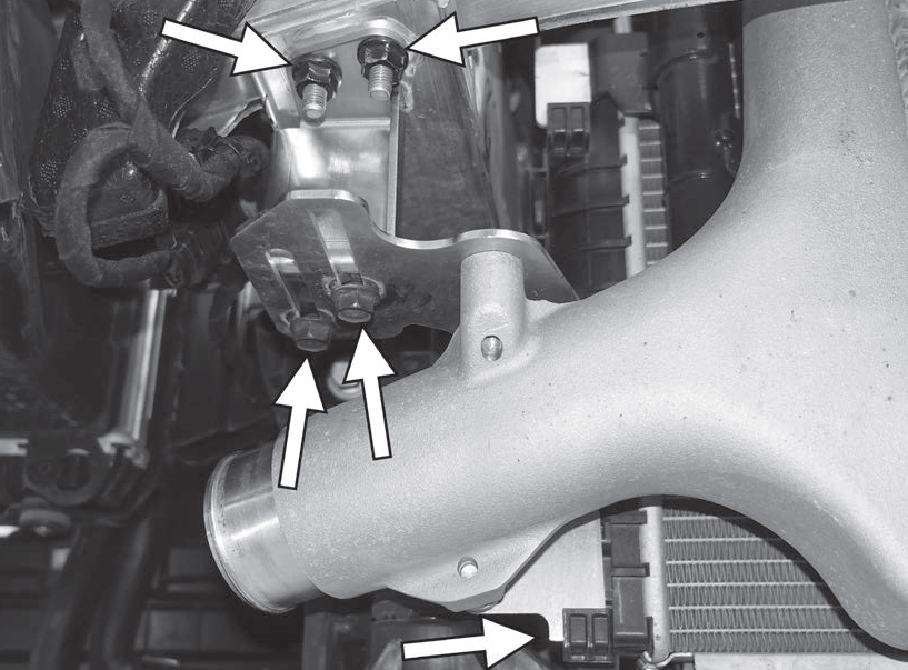

    The Wagner intercooler is finally installed.
    First they sent the S4/5 version…
    Wagner said that only difference between the S4/5 and SQ5 versions is the bottom brackets that sit in the OE hangers so they sent a set of those.
    I went to mount it with the replacement bottom brackets and the top brackets were wrong too.
    So then they sent me the “Euro” brackets which fit perfectly.
    Personally I’m not a huge fan that they use self-tapping screws in the bumper bar. Those are always way too easy to accidentally over-tighten and then the hole is buggered. Which, of course, happened on the passenger side. The bolt never even got snug, it just kept spinning. The driver’s side snugged up nicely. The intercooler feels solid, I gave it some pretty strong shakes and it didn’t budge. If it comes loose I guess I’ll just drill a hole through the top of the bar and get a long lag bolt with a nut. We’ll see.

    Uff da. Self-tapping screws are janky and those brackets look super weak - stuff vibrates and shifts in a vehicle and that does not look trustworthy. In the least you need to replace the stripped self-tapping screw mount with a with bolt/washer/nylon nut combo. Also strongly advise replacing all self-tapping screws in the same manner and redrilling the bumper bar mounting holes such that the IC is offset from the condenser by a material amount (i.e., not touching, or close to it, as it appears in image one).
    Your course is set at this point but FWIW the APR intercooler is at least 10x more robust in its install and easily offsets from the condenser, plus it comes with a complete set of HD silicone piping, MAP sensor housing and clamps, and why I chose it over the others, despite the price. Was not a fan of the bare AL look so I hit it with some BBQ paint and baked it on - has held up excellently. APR also screwed me with the wrong brackets, so I had to redo the install (abusing the requisite plastic, foam and fasteners) and the MAP sensor housing sensor hole was cocked up, so had to chuck it up and fix that too.

    Honestly, in hindsight I’d have gone with either AWE or IE for their mounting solutions just because they don’t require any drilling.
    The Wagner brackets aren’t weak by any stretch of the imagination and they don’t hold any weight so it’s irrelevant. The bottom brackets that do hold the weight of the intercooler are CNC’d aluminum blocks. Those aren’t flexing or breaking.
