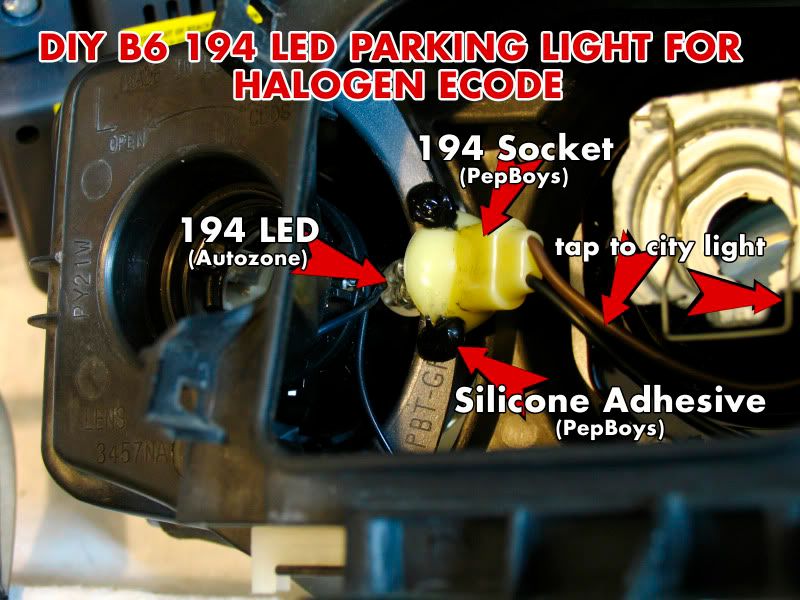

¥ Make sure don't push the 194 Led to far inside the
housing not to hit the turn signal bulb
¥ ALWAYS WEAR PROTECTIVE GLASSES
when doing this mod because i would HIGHLY
recommend while doing all the driling & cutting to
have the headlight pointing up towards the ceiling
to prevent the plastic shavings/dust to enter the
headlight housing(or else it took me longer to
clear the shavings inside than installing everything
for both headlights with a vacuum & a 15gal. air
compressor)

¥ 194 SOCKET
¥ 4 x wire splicers
LED SOCKET BACK VIEW:

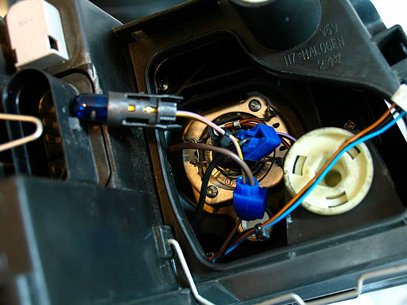

WIRE TAPS:

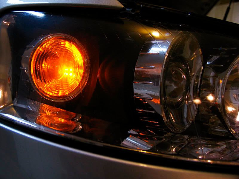

DONE:
