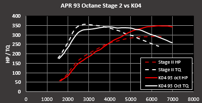

    I tried APR’s K04 93 octane file for a few days (Money back guarantee) to compare with my IE tune. The APR file had more low end torque but not as much boost up top. I still logged 303 g/s with the APR K04 file.
    BTW, my CTS K04-0064 is ported and polished for better air flow.

    APR's published dyno numbers on their properly setup K04 turbo shows less torque than a non-K04 car below 4000 rpm.
    A stock IHI JH5 turbo hits full spool at 2400 and max torque around there too. Well below a K04.

    APR's dyno charts are fake. They are used for marketing purposes only. I would look around for some actual APR dyno sheets or K04 dynos using other tunes.

    Quote Originally Posted by Spawne32 View Post
    APR measures on their in-house dyno lol. I don't doubt there are some tricks to embellish their numbers, but it is a fair comparison between APR's published numbers, K04 vs IHI JH5 stage 2.
    +1
    In VWVortex everyone claims that apr uses a hub dyno... not a load bearing wheel dyno

    Quote Originally Posted by Traptalk View Post
    Correct, but more importantly, those are graphics used to represent an estimated power gain, not the actual dyno charts they get from their testing.
    but that would in fact imply that the numbers are not real would it not? lol
    The numbers may not be real, but the comparison could still be valid, since both sets of numbers come from APR.
    You know I could probably make these graphs from any other tuner and it would show similar results. It's pretty simple physics, bigger turbo = more time to spool. You all refuse to acknowledge it.

    Quote Originally Posted by A4x View Post
    when did i ever say big turbo doesnt take more time to spool, thats a correct statement, but we are dealing with turbos that are only millimeters larger in terms of wheel size, those differences can easily be made up with lighter wheels or modifying the wheel design.
