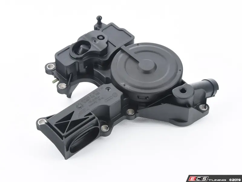

    Sounds to me like your rear pcv valve is going bad, letting extra oil pass and loosing boost as well. Just my thoughts.
    Sent from my SM-G950U using Audizine mobile app
    excuse my ignorance, but where is the 'rear' pcv valve?
    i have changed the one on top of the motor.

    It should lead right to your turbo from the valve cover. It has a check valve that goes bad with additional boost. I deleted mine...bad idea. Run stock and get a spare. I have an 06 2.0t so check the location of your rear breather. Maybe slightly different.

    That arrow is pointing to the rear bresther on my 06. I'd imagine its similar in your 09. At the top of that tube is the check valve. That's what can wear out and let additional oil pass and you could lose some boost that way as well. 20191026_133026.jpeg
    He has an 09 and you have an 06. They’re completely different motors.
    OP, if your turbo muffler delete pipe is leaking oil out of it, it’s also leaking boost. Get a boost leak test done and go from there. Maybe a little loctite is needed on the turbo muffler delete or maybe it’s something else.
    Get a boost leak test because we won’t know where the loss is coming from.
    And try getting rid of that catch can and use the stock PCV system. Catch cans can cause more harm than good if the design sucks.
