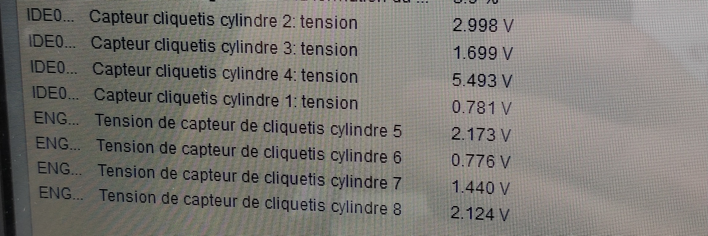

    And finaly, my knock sensor show strange values..

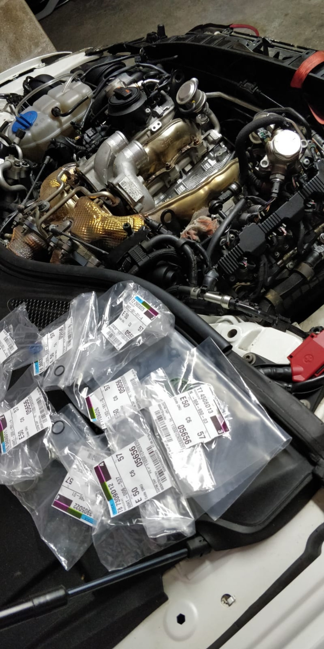

    94 000km maintenance by myself
    Engine Oil remplacement (5w40)

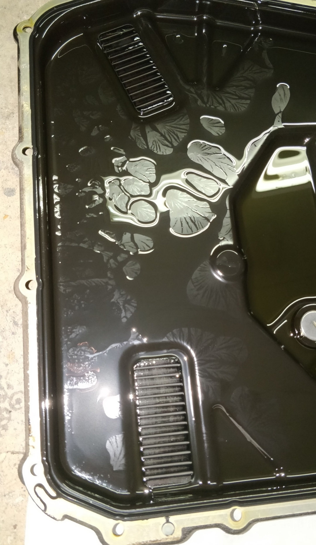

    Transmission ATF + MTF oil remplacement / Transmission good condition
    Sport differantial ATF + MTF oil remplacement / Differantial good condition

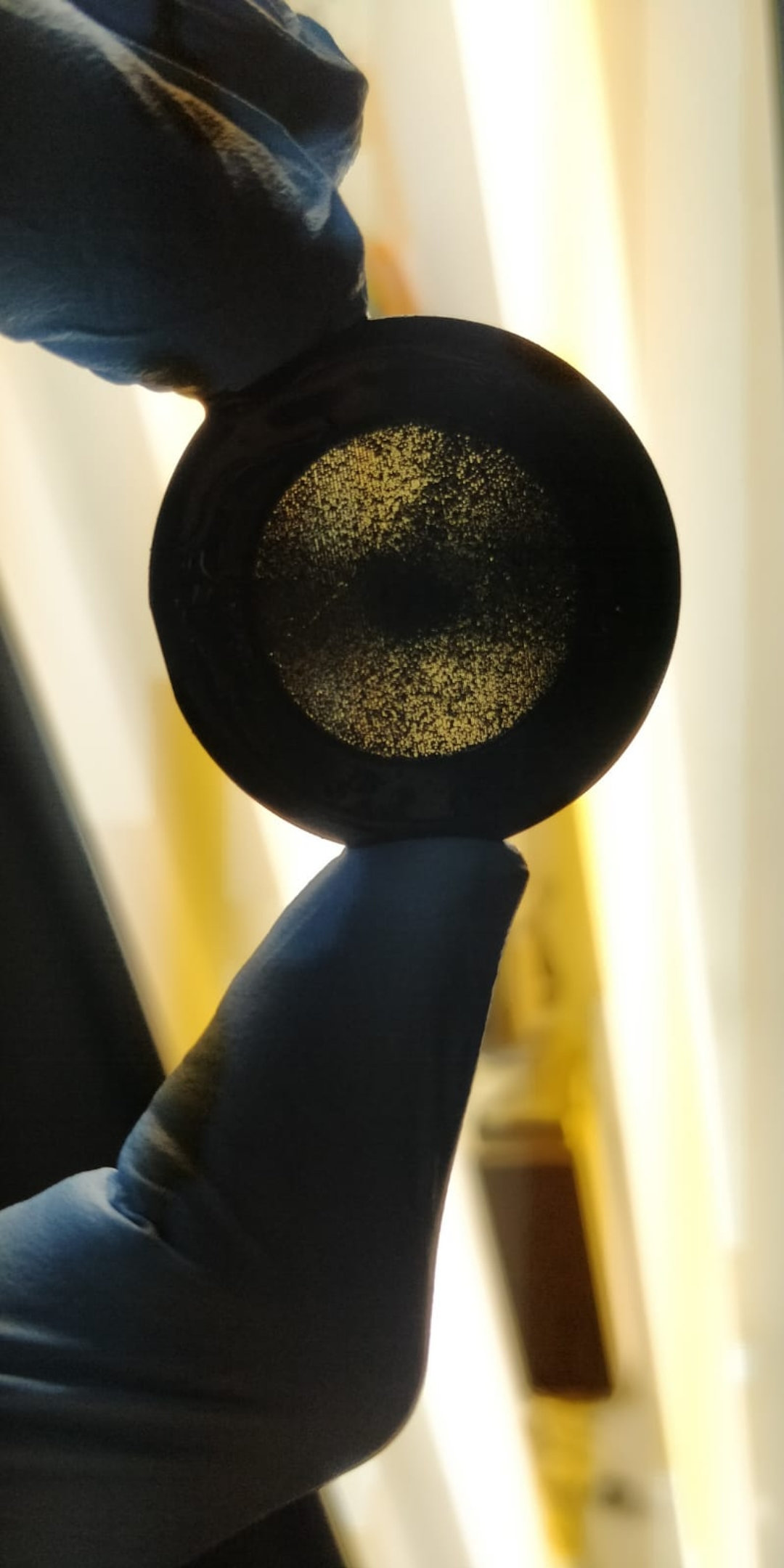

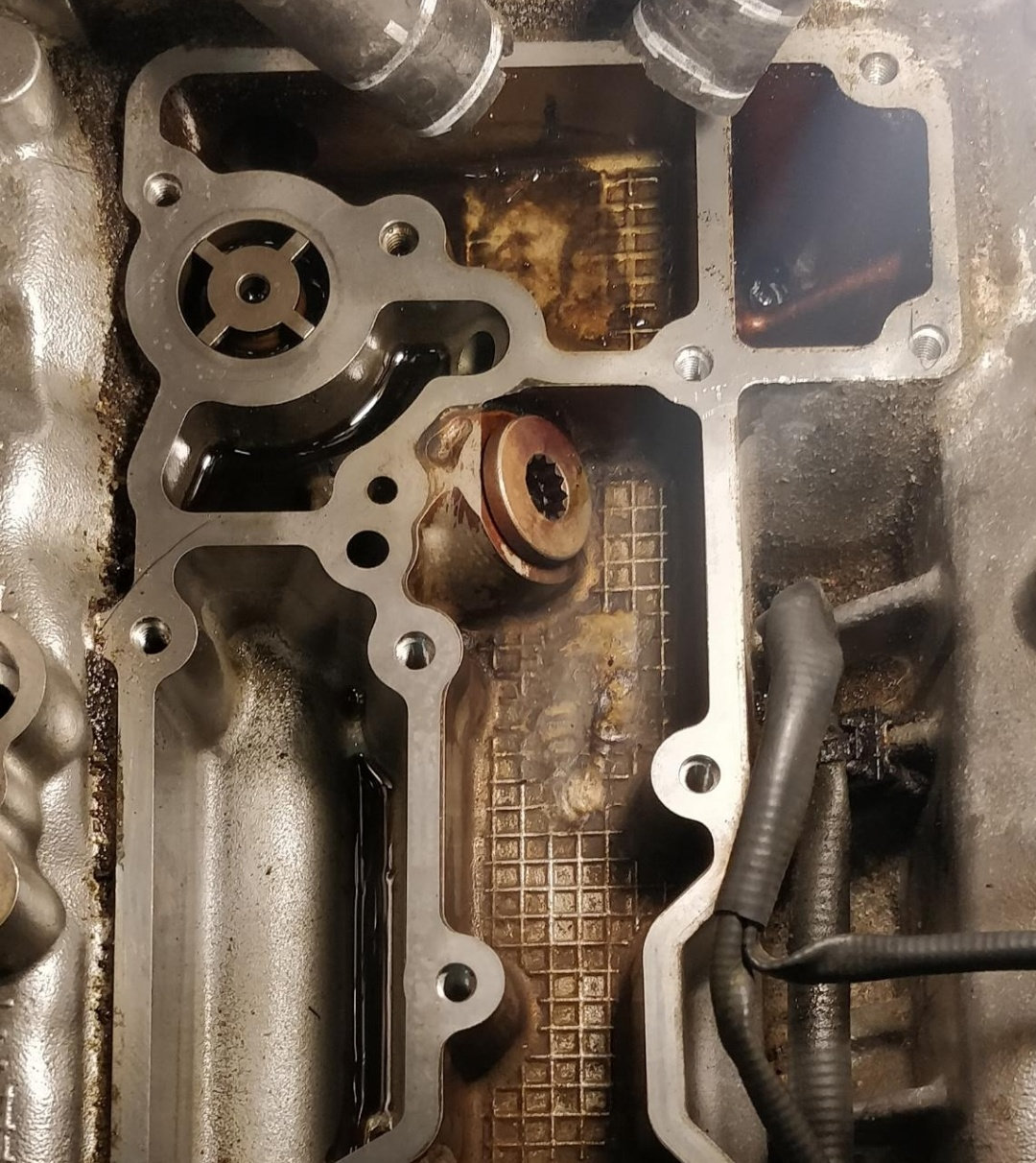

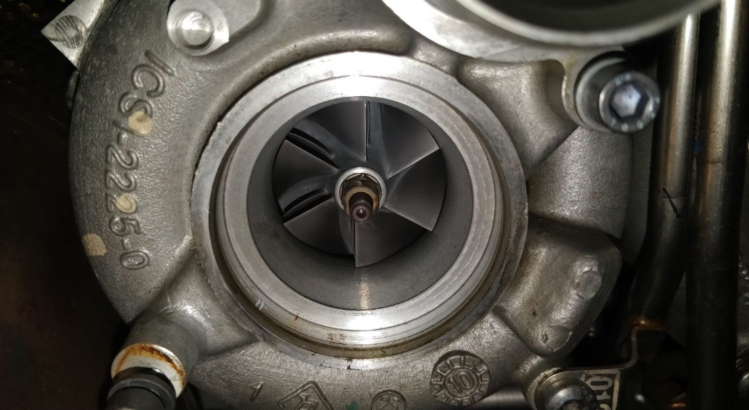

    Oil screen removal / Turbos OK
    Spark plug remplacement
    PCV remplacement
    Complet Fuel pump remplacement in tank
    Drive belt remplacement
    Clean all parts (throttle valve, intake intercooler...)

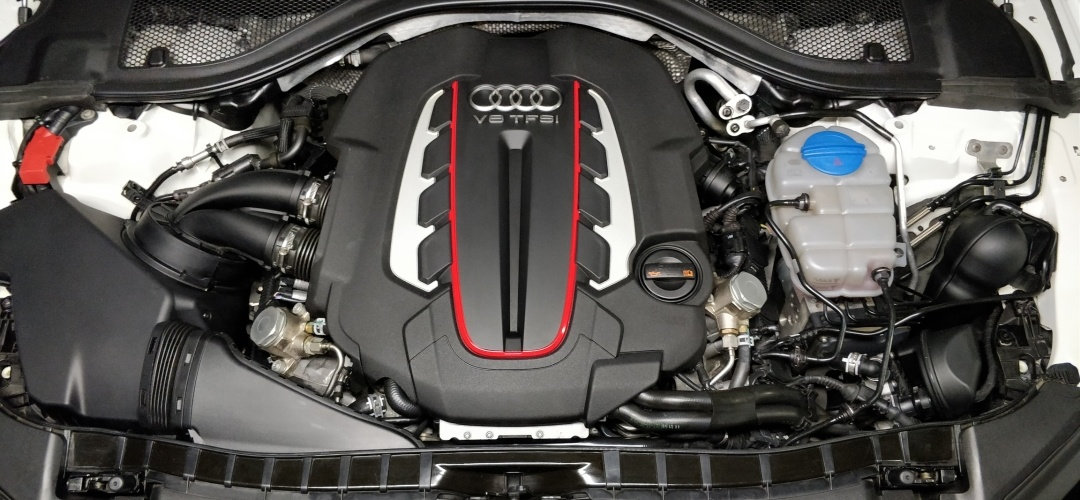

    Some picture
    PS : I have got this noise when I buy the car 91 000 km.
    The vehicle is currently working well, no MIL engine light or other warning light... Good acceleration, power, etc etc...
    I just wonder what your views on that are. Many thanks and I'm sorry for my english.

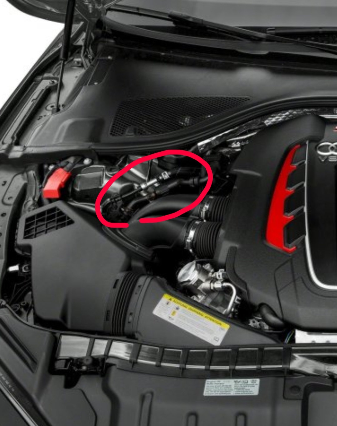

    Yes I change PCV.. I just have this hose shaking a lot

    Drain the oil
    Take a good sample and see if it has metal shavings, if it does it means something in the engine is going out, if it doesn’t it could be a chain it tensioner,
    My rs7 when it’s running and I take the oil cap off I hear little clicks come from timing solenoids, this is normal the car is trying to retard the timing for loss of vacuum.
    If the car hasn’t been beat up it’s way to early to need a chain or guides, I just rebuilt my rs7 4.0 and didn’t change those guides or tensioner I had 60k miles and they look great. Best of luck let us know if you find out. Another thing you can do is lift the Compressor tip and get a stethoscope or a long hose to listen to that noise to pinpoint it.

    Quote Originally Posted by Emre69 View Post
    That is from the low pressure fuel pump. It shakes a lot. “Normal” as far as I’m concerned.
