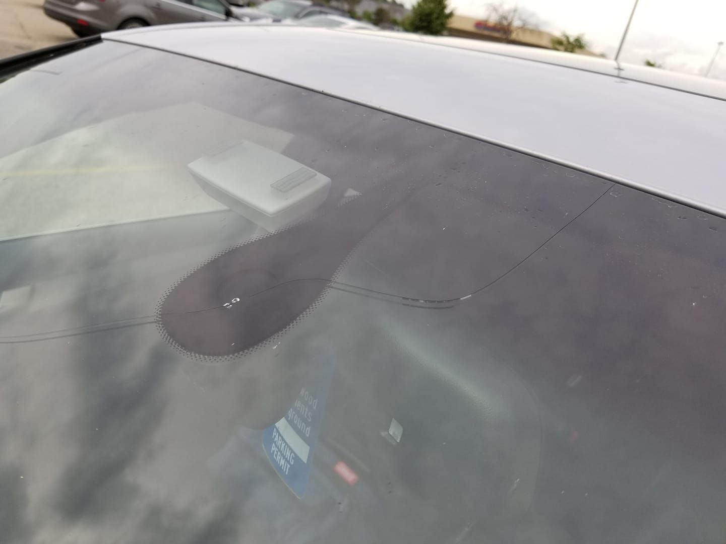

    Cracked windshield (Stress crack)
    I feel pretty bummed about it knowing that this is my first time. I noticed the crack on my windshield today. There is no signs of rock chip and it looked like it started from the edge, just above the rearview mirror. I am HOPING this can be replaced under warranty. Might take it to a glass shop and see if they also agree it's a structural issue. Anyone have any experience with this?

    Aren't there 2 chips in the middle of the line?
    Apr 18 2014
    189846
    Nashville, TN
    Right by the "photobucket" logo?
    Yea, I initially thought so too. But they are some sensors, probably either for the dimming mirror or wipers.

    It looks like there's a rock chip right in the middle of your rain sensor. Replacing a windshield isn't a big deal as long as its done right but definitely won't be covered under any warranty. Put in a comprehensive claim in with your insurance, you might even have a $0 deductible for glass, get it replaced and move on.

    I called my service advisor and he said if their glass specialist inspects and concludes that it is not cracked by any object, Audi can cover it. That appointment is tomorrow.
    My friend with a Ford had hers replaced under warranty due to a structural issue. So while it is very uncommon, it can happen.
    I have looked at the crack many times and there is not a single rock chip. What you see around the rear view mirror post are sensors. Sorry for the bad picture. I would rather not pay $100 deductable unless I have to.

    Went to the glass shop owned by my Audi dealership. The install guy looked at it and he immediately said it's a stress crack. No signs of object cracking it. He did say it can happen from time to time, but must not be common on our cars. Could have been defective glass as well.
    My Audi dealer took pics and will go through corporate management to get it replaced under warranty and it sounded promising.
