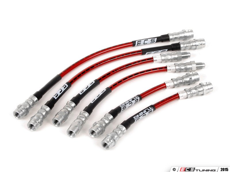

    Anyone have thoughts on these stainless steel lines by ECS? My old lines were rotted out and it’s time to replace them before they blow. If you have or know anyone who has these, are they worth the money? And are they worth the upgrade?
